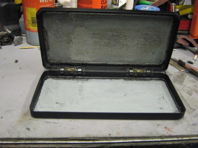

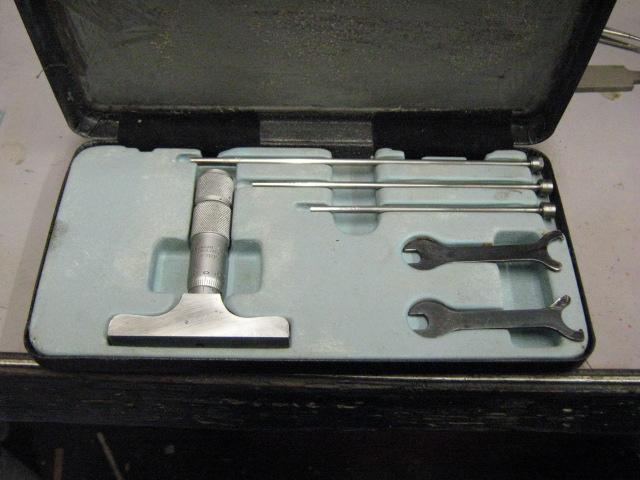

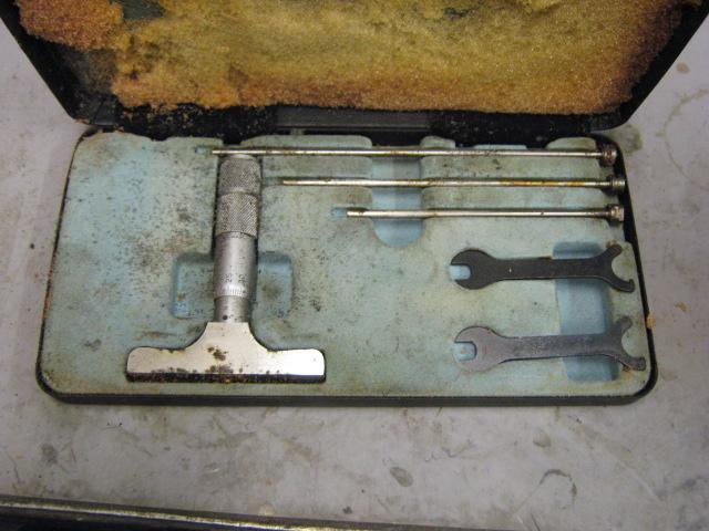

« on: November 12, 2017, 06:16:37 PM »

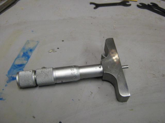

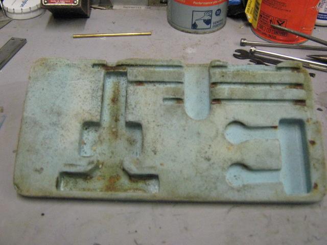

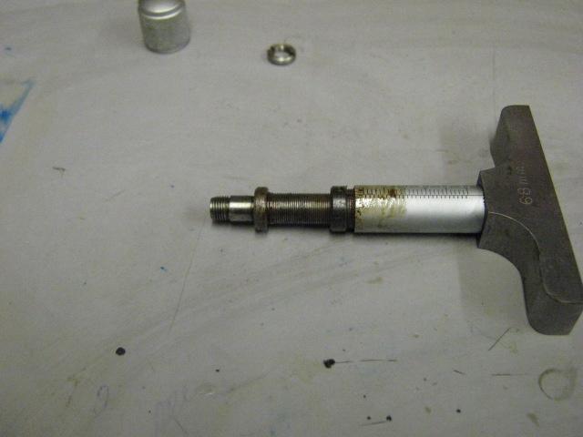

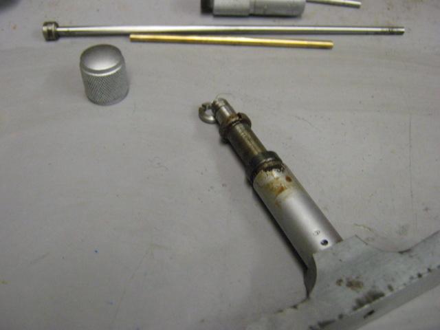

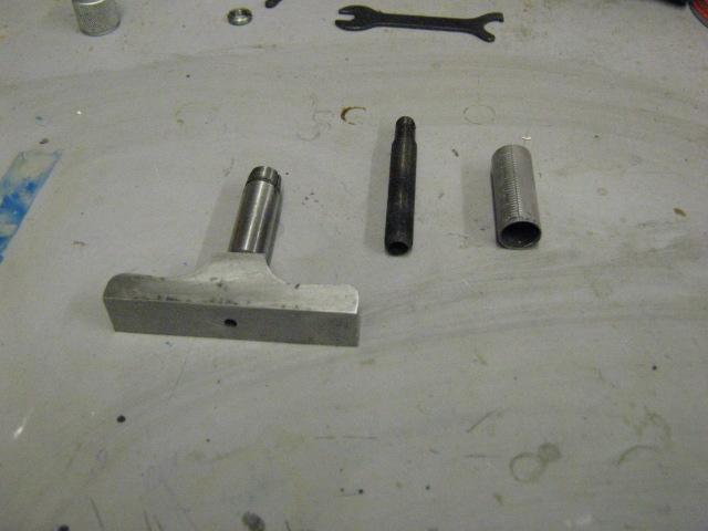

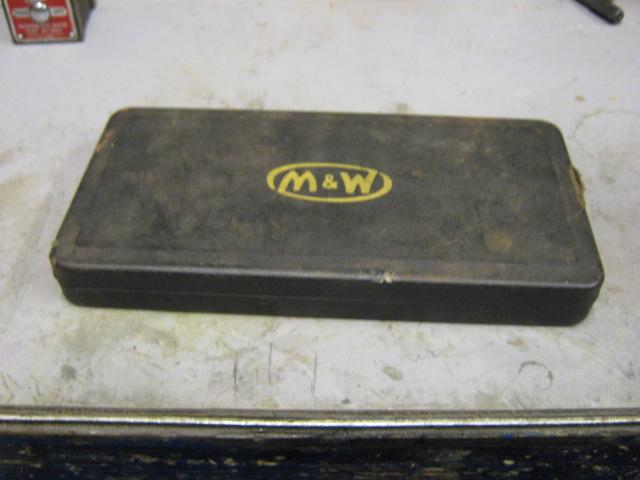

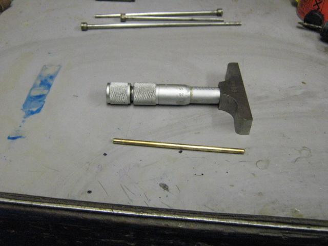

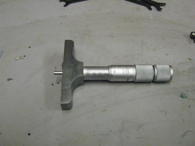

hi all got this today in all its good just unloved first job kleen out the case I find petrol is the best thing for removing all the old glue without harming the covering then strip the mike it was well rusted up  once a part all went in to  the ultrasonic tank got all the crap off then with sum wet and dry on a glass plate got rid of the rust marks on the base then back in the tank then put it back together right pics so far

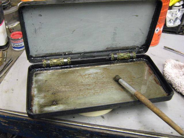

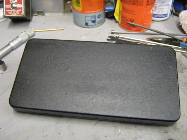

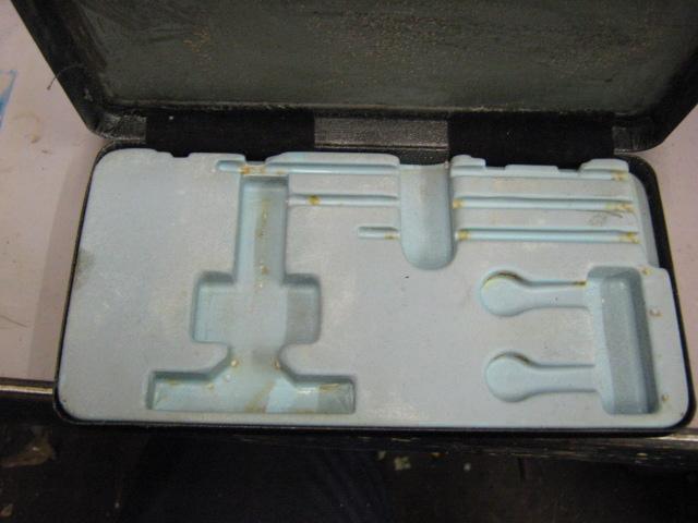

« Reply #1 on: November 16, 2017, 05:26:58 PM »

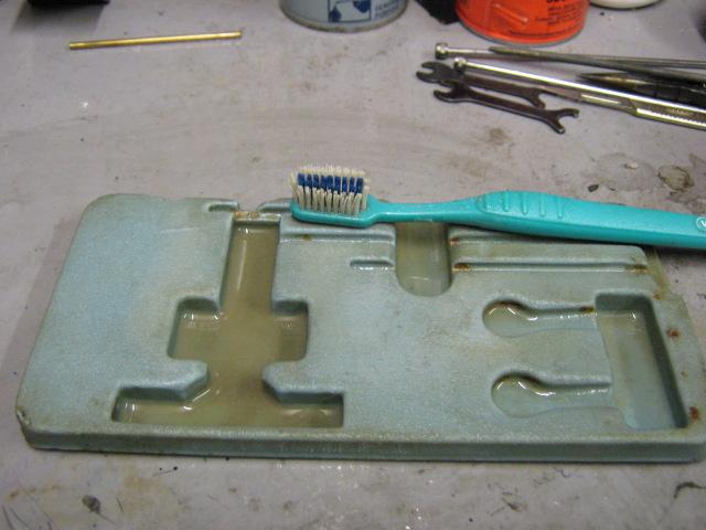

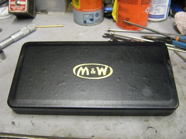

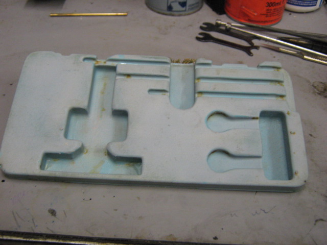

hi all right more pics cleaned the inner tray with wash up liquid and water came up nice cleaned the out side of the box that cum up nice to all I need to do gnaw is get sum sponge for the lid right pics
