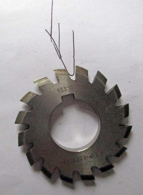

Here's a photo of one of the cutters that I need to sharpen. As you can see from my dreadful sketch I need a grinding wheel with a thin rim to get down in between the teeth.

« Reply #9 on: October 18, 2017, 06:03:05 AM »
It's becoming clearer and the normal way to recondition involute gear cutters is 'between centres'
However, in Harold Hall's web site there is a video of how slitting saws are reground with a plain wheel'

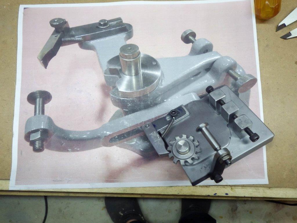

I built a functional clone of the Cincinnati No2 fixture to grind the face of teeth. I have not yet bought a correct wheel though, hence my interest in this thread. I do have a wheel that is quite narrow and already dressed to a similar angle. It might work in a pinch.
The manual for No2 grinder has a good description of its use.

Harold Hall's grinding jig set up to do slitting saws but with the correct, i.e. dish shaped, wheel will do the job for me. Where do I find the correct wheel?
