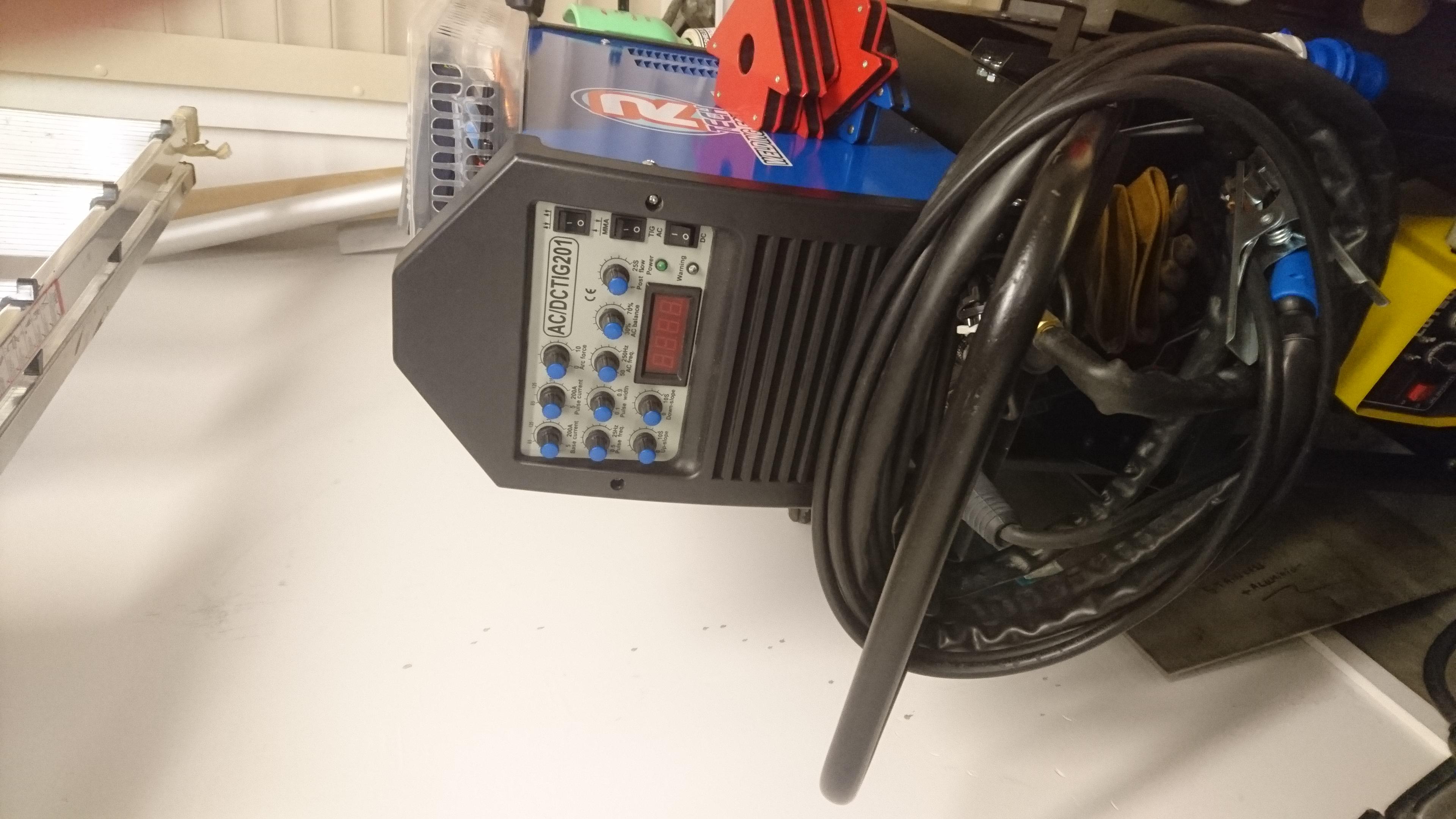

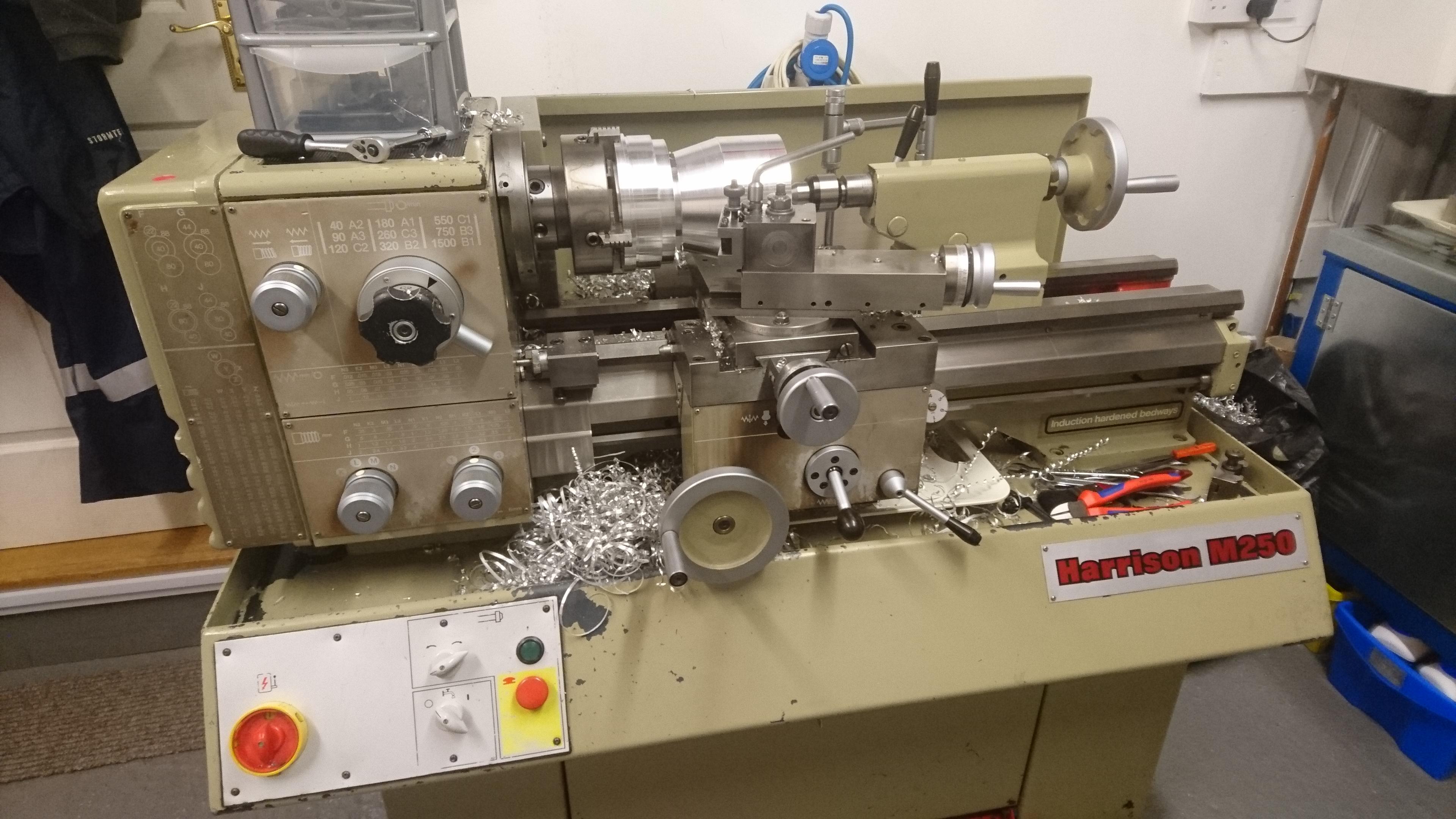

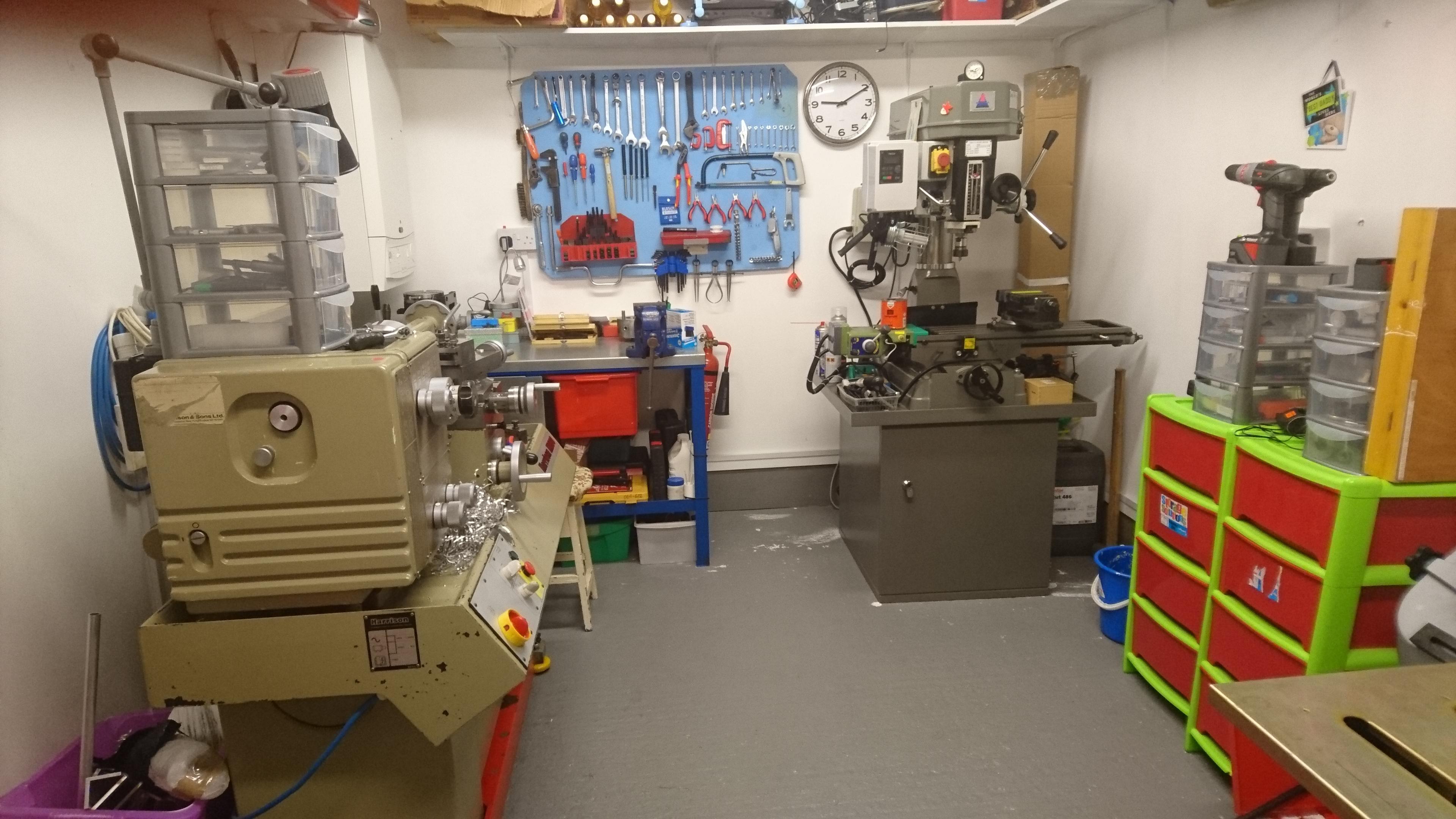

Hello,
My name is Carl and I'm in the UK, in the Highlands. I have a reasonably decent workshop with a Harrison M250 lathe, Chester Mill Drill and an RTECH Tig welder.
I've included some pictures showing my lathe, mill, welder and one of my rotary tables that I put an Arduino controlled stepper on.
My main project is building a liquid fuelled rocket engine. You can read about this on my blog, British Reaction Research.
I get involved with other things too and I also dabble in electronics. I'm building a tensile testing machine to test the strength of aluminium welds. I bought an old pottery kiln to heat treat the welds.
In the lathe you can see a nozzle for the rocket emerging from a piece of 6082 T6.
All the best,
Carl.

Hi Carl,
Welcome.
A nice tidy workshop you have there.
But....
Before someone else tells you - your pictures are too big! 800 x 600 pixels is more than big enough so that other forum members can see the whole picture at one time without having to scroll up and down.

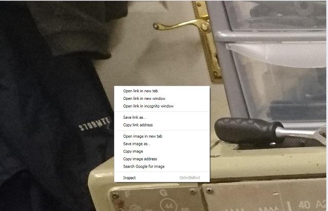

« Reply #14 on: August 15, 2017, 11:17:32 AM »
That probably depends on which operating system and browser that you are using.
.... it certainly doesn't work in Chrome under Windows 7
The attached (640 x 480 !!!!) image is what happens with the first picture in this thread when 'right clicking'

« Reply #15 on: August 15, 2017, 12:41:08 PM »
Or in Win 10 Andrew. If you open in a new tab you do get an image you can view in one, but it's a pain to have to do it for a lot of images.
Re: Greetings All
« Reply #16 on: August 15, 2017, 04:09:19 PM »
Andrew - click on "Open Image in New Tab", this will then auto-size to full-screen. Clicking on the image will then zoom it to full size, clicking again will once again fit it to your screen.
As Seadog says - a bit of a nuisance if there's lots of images, but OK if there's just one or two.

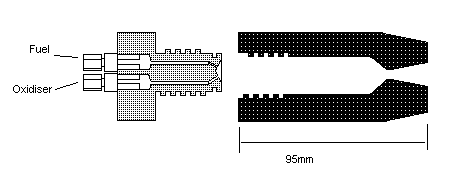

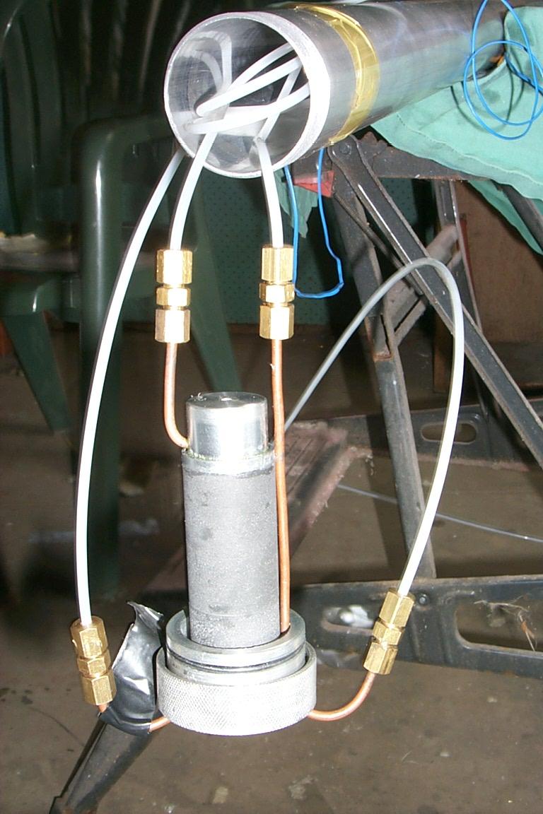

 And are you saying you built a Nox cooled motor?
Well, it was a NOX cooled motor for about 4 seconds, then it was a self digesting fireball, then a bucket of molten shrapnel.
I've built a radiation cooled NOX biprop that worked, but it was done before we figured out how to do reliable ignition so it was a pig to start...
I'll have a pic somewhere, but it was based on this:
PK
