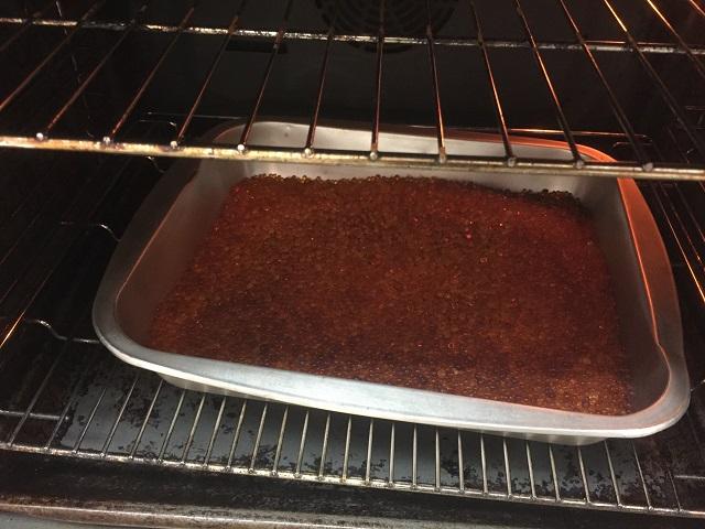

So I thought I'd take a peek at at after it had been cooking for one hour. Superficially it all looked to have turned back to the original orange, but when I raked the surface there were still a few blue crystals, So I gave it a goodly stir up and have left it for it's second hour.
Certainly when I opened oven door, masses of steam came out to the extent that my glasses fogged up  :clap:
I seem to remember that silica gel can absorb it's own weight in water - now there's roughly 1kg cooking, so up to a litre of water if it was all used up.

The recycled silica gel is noticeably darker than the original - I suspect that I may have over cooked it - I'm sure that the water has been driven off, but perhaps I've affected whatever chemical is being used as a moisture indicator  :scratch:

Yes I have Matthew and it does  :thumbup:
It turns out the the orange indicator in the silica gel is Methyl violet, but I've not been able to find anything about it's temperature stability. However I have found that the gel will recycle at a lower temperature - 120 deg C rather than the 140 I aimed for and possibly overshot  :scratch:
I think the gel will work still very effectively, but the indicator colour change, although it happens, isn't quite as definitive.

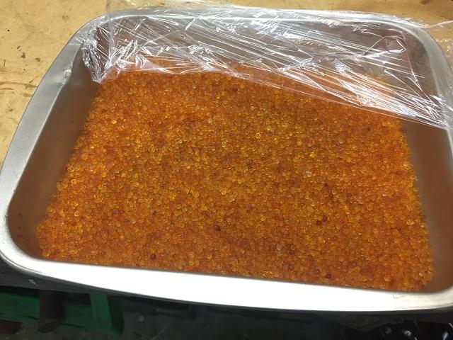

Today it was time once more to 'cook' my silica gel to remove the moisture that it had trapped. Last time the crystals, which turn blue/black when damp, lost their nice orange hue on cooking, probably because the indicator had broken down at the 140/150 deg C that I used.
This time I set the electric oven to 120 Deg C, cooked for three hours and they have returned to a nice orange  :thumbup:
(It's now cooling under cling film to keep the moisture out)
