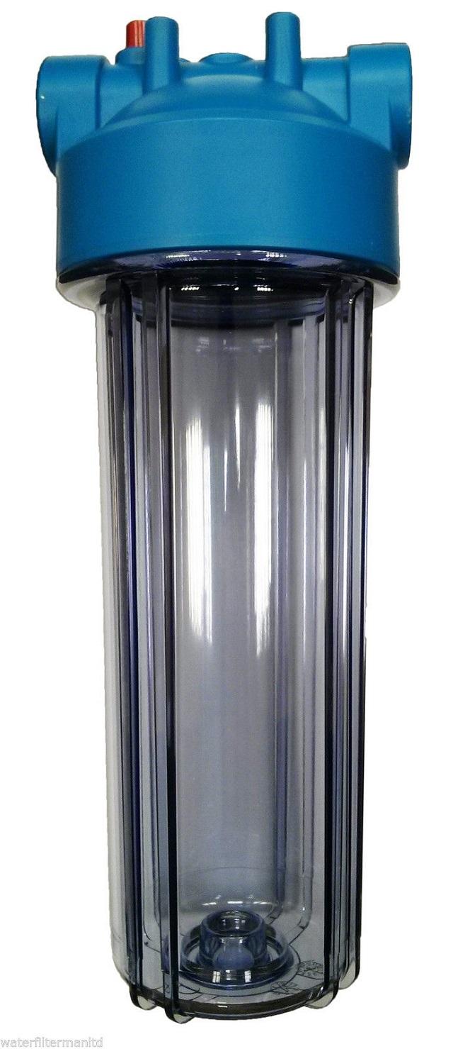

I hit on the idea of using a standard 10" water filter container and modifying it for use as a desiccator. These thing are modestly priced, are transparent (or at least mine is), and are designed to take mains water pressure safely.

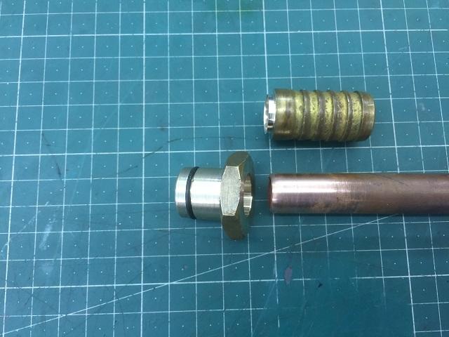

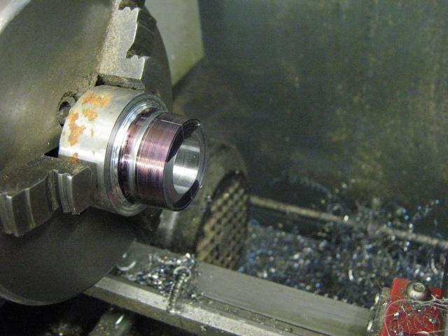

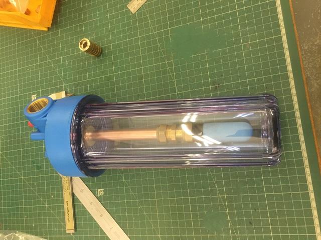

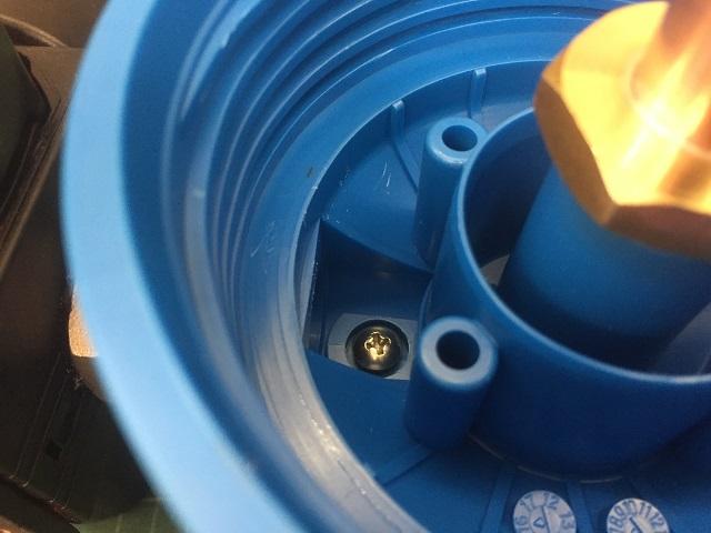

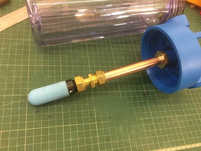

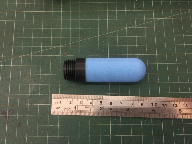

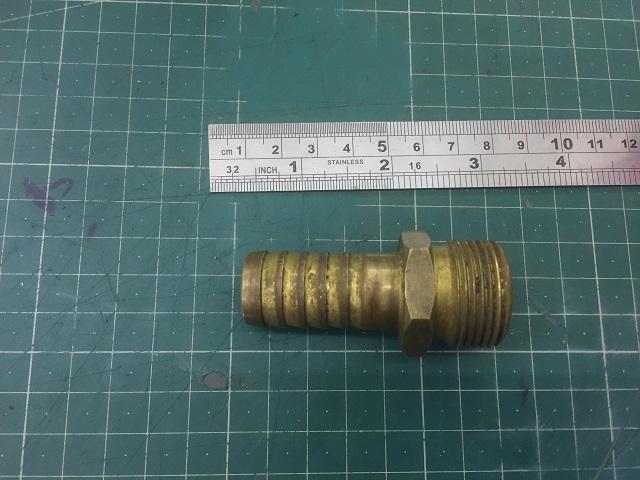

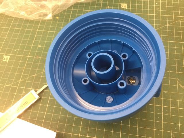

Now the input and output of this housing are 3/4" BSP female brass inserts, so connections there are no problem at all. The air needs to pass through the bulk of the Silica Gel, then up a tube leading to the output port. The tube somehow needs to have a filter or gauze on it to stop the desiccant blowing straight through to the output. I hit on the idea of using a sintered plastic compressed air exhaust silencer. They are available in all sorts of sizes, and I chose one with a 1/2" BSP male thread.

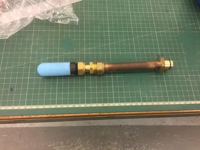

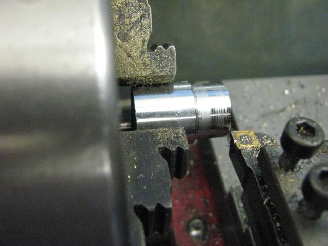

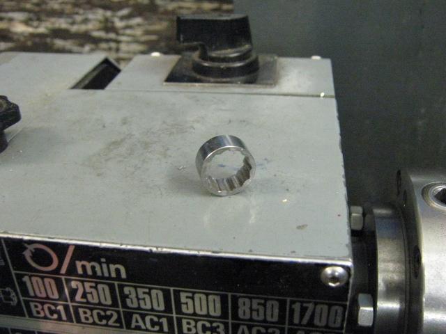

Then it was a case of making up an adaptor for the filter lid to take the 15mm copper pipe, and joining on the silencer using a standard compression 'tap connector' - it all went rather well and turned out fine.
Initially I was stumped for a bit of brass stock to make the adaptor from, as I didn't want to turn down the only rather large brass bar that I had in stock - then my eyes fell on a 1" BSP to hose barb fitting, just crying out to be modified  :clap:
I designed the adaptor as a push fit into the bore in the lid of the filter, with an 'O' ring as a retainer / air seal. In the event it turned out that the hole in the plastic lid had just the right taper for it to lock solidly - in fact so solidly I had a bit of a struggle to get it out again  :bang:
The adaptor is soldered onto the 15mm copper pipe.

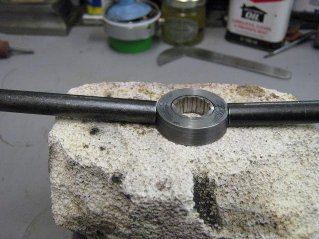

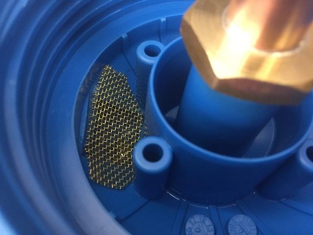

Now the inlet port is just a vaguely rectangular opening at the top of the filter. To prevent Silica Gel leaking back into the inlet under negative pressure situations (when turning off) I incorporated a fine brass gauze in the opening, bonding it in with high viscosity super glue
« Last Edit: February 09, 2017, 11:17:42 AM by awemawson »

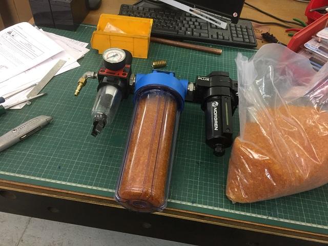

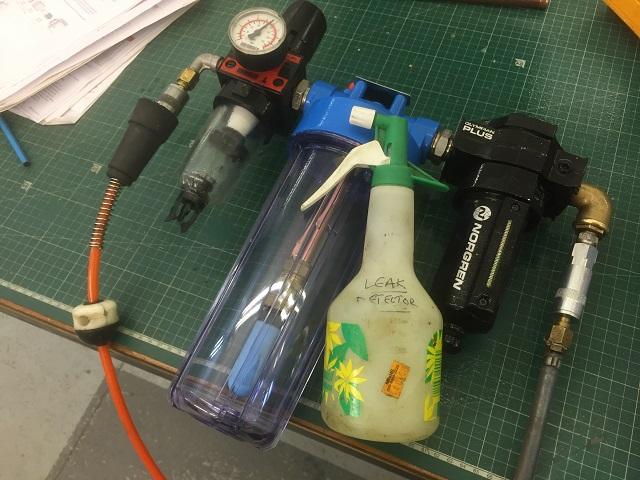

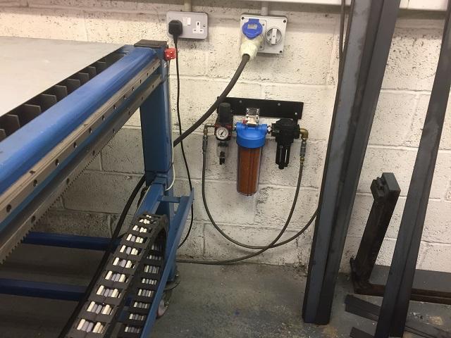

Next to add the pre and post filters. The pre filter is a conventional water separator used for it's intended purpose, whereas the post filter, although again a conventional water separator, I'm using it as it has a 5 micron sieve to sweep up any fine Silica Gel dust that might 'get away'
Re: Making a Desiccant Air Dryer with Silica Gel
« Reply #4 on: February 09, 2017, 10:24:24 AM »

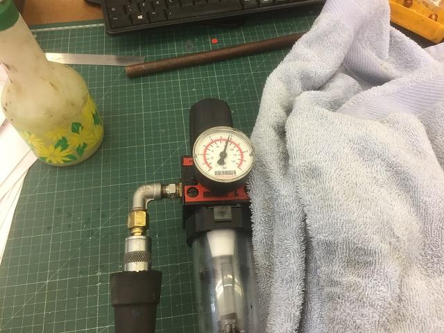

So no more ado - do a leak test. Well first a safety pressure test with it covered in a towel - shame if the poly carbonate filter housing were to explode. :bugeye:
All's well - no violent explosions so then the leak test. I keep a horticultural hand spray on the shelf full of soapy water, and it's amazingly good at finding even the smallest escape of compressed air - but this was sound (I use Loctite 542 thread sealant on this size plumbing and swear by it)
« Last Edit: February 09, 2017, 05:40:21 PM by awemawson »

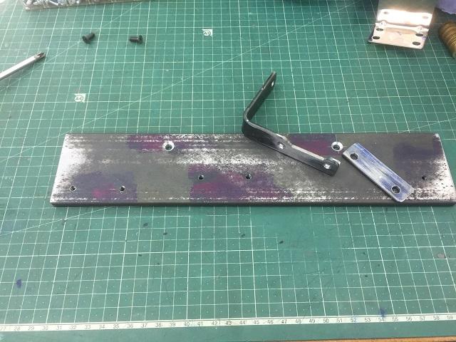

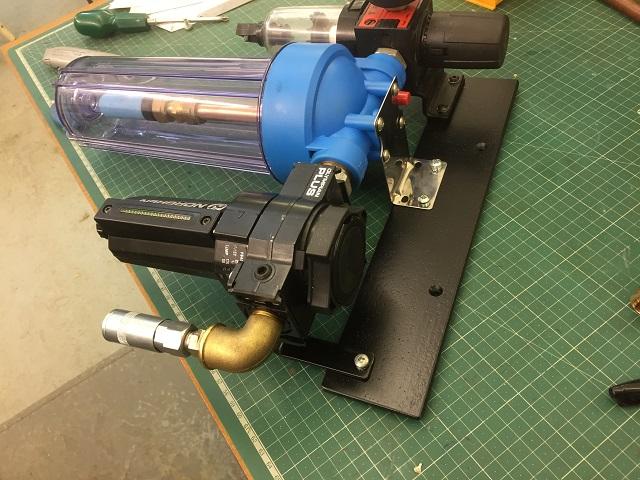

Now as the three air assemblies of this set up are all from different manufacturers, mounting it on a wall wouldn't be easy - unless I made up some customised brackets to accommodate their differing mounting styles.
A splash of lay out fluid, a bit of die grinding, drilling, taping, bending, zinc primering and black top coating later and we have an integrated assembly ready to fix on the wall.
« Reply #6 on: February 09, 2017, 10:32:30 AM »

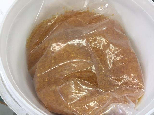

Then, like some 'just in time' manufacturing conglomerate, the girl from My Hermes arrived carrying a 3 kg tub of self indicating Silica Gel - I reckon she'd been spying on me and was waiting until just the right time to deliver  :ddb:
So - shove the crystals in - wack it on the wall and try it out  :clap:

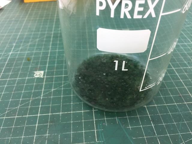

Does it work?
Well time only will tell. I did do a test cut on the Plasma Table but considerable time hopefully will have to elapse to see if the stuff changes colour ......... unless we do another test :lol:

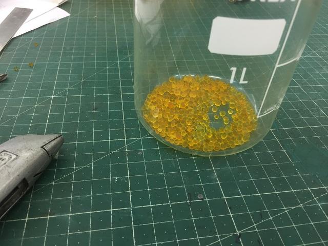

So - shove a bit of the Silica Gel in a 1 litre pyrex beaker, drip some tap water on it and watch the results.
... well it certainly changes colour so that's a good sign  :clap:

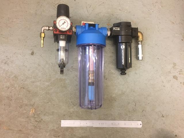

« Reply #22 on: March 04, 2017, 06:38:13 AM »
I was so pleased with the way this drier works I made a second one  :lol:

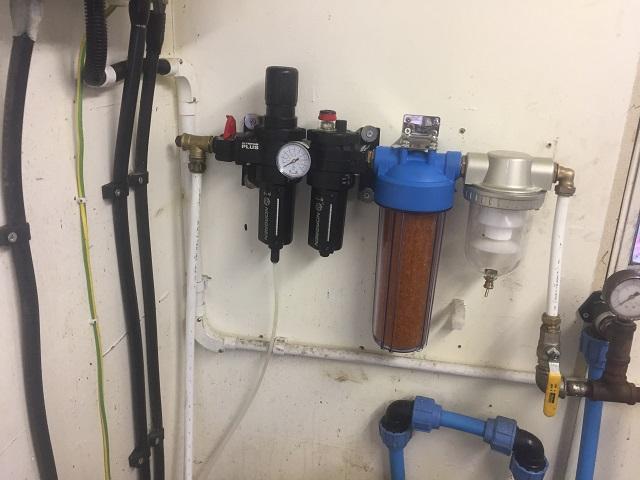

This second one takes air directly from the compressor and dries it, hence my whole air distribution system will now have properly dried air. I'm sure that there will be existing moisture in the pipework, but after a bit the newly dried air should absorb and flush it out.
Looking at the picture starting on the left is the Regulator / Water Separator taking 150 psi from the compressor and reducing it to 100 psi - the water separator is the float type that blows water down the small pipe to the outside.
This is followed by an 'oiler' that although in circuit is NOT used or filled - it happened to be integral with the regulator so stayed there.
Then comes the new desiccant filter made exactly like the previous one.
This is followed by a large volume filter / water separator, just being used as a filter, as by this stage there should be no water to separate  :ddb:
Not pressured up yet as you can see from the gauges as the Loctite 542 needs another hour to go off.

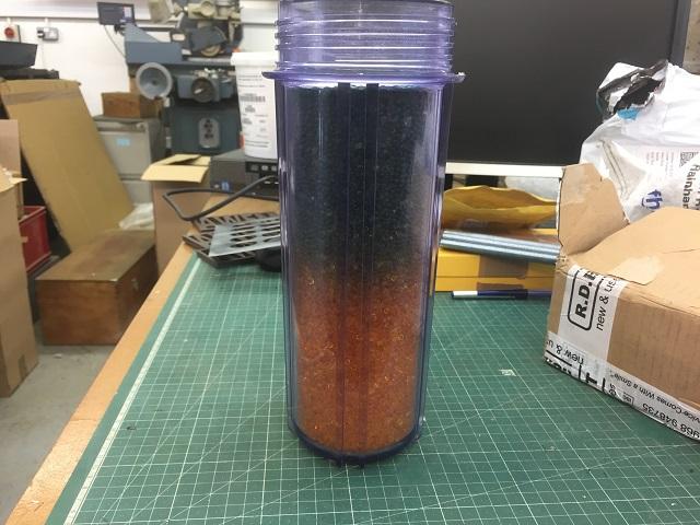

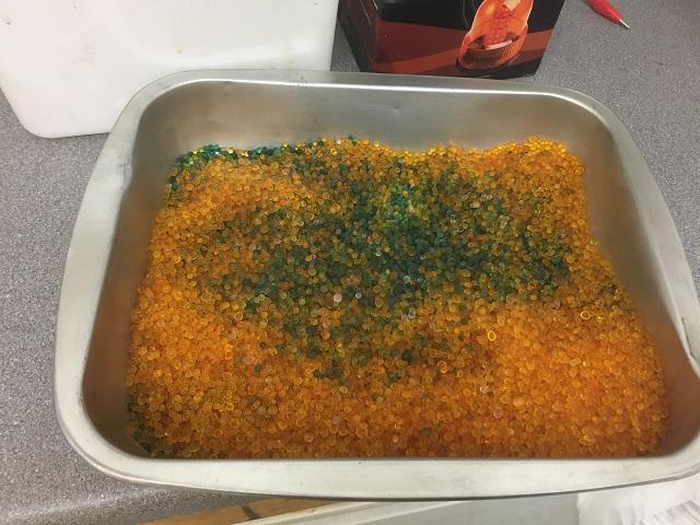

So the time has come for the first regeneration cycle of the self indicating silica gel crystals of my main air dryer. (This is the one that all the air from the compressor flows through)
Unscrewing the housing showed that the outer layers must be most exposed to the moist air, as tipping them into a baking tray there seemed to be far less turned blue than you'd think from looking at them in situ.
They are now in the oven at 140 deg C for a couple of hours. Meanwhile the dryer is back in service, as the 3 Kgs of silica gel that I originally bought not only filled this dryer and the one I fitted to my CNC Plasma Table, but was enough to re-fill this one while the fan oven does it's stuff driving off the water.
I'm really pleased with the performance of this dryer - it's so simple and yet seems very effective.
