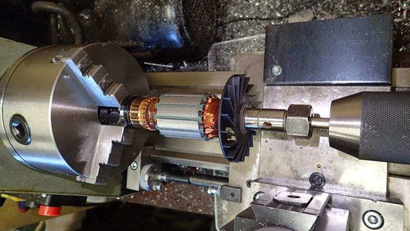

Tail end has two wave washers to keep the bearing loaded and quiet running, went for SKF C3 bearing. Now I only have to figure how to get that tail bearing out without breaking the plastic dust seal. Thinkking of clamp to hold outer race and press the rotor out.

I have a puller designed to remove bearings like that
It has a collet type gadget with little claws that catch the race,different collets for each bearing size
A simple way is to break the bearing outer by squeezing in the vice !!!
then its easier to grip the inner race
Usually these bearings are not tight, so gripping in the lathe chuck and pull on the rotor may work
Re: New ball bearings to Festo OF-900 router
« Reply #4 on: June 19, 2017, 01:22:45 AM »
Thank you.
I'll try first the lathe chuck thing. I think I could mount a 6 mm rod on the rotor original spindle, put that on tailstoc drill chuck and use that to pull straight it probably does not need much force.

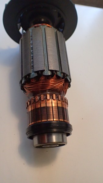

I mounted 8 mm roll pin on the router rotor collet chuck, then took it to the lathe. Nipped the 608 bearing on three jaw chuck and pin on drill chuck. Very moderate force at the tail stock extreacted the bearing.
Thank you.

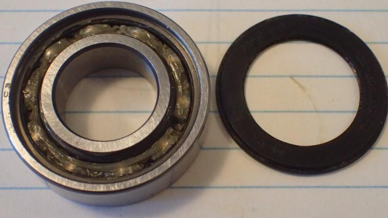

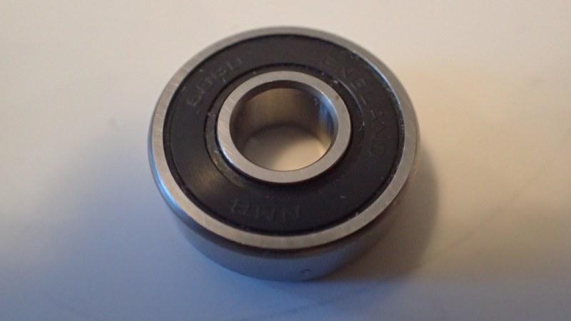

Those bearings are not what they look.
1: The commutator end bearing has outside rubber seal removed, no markings on metal parts, but on rubber seal that was facing the commutator had following marking: England, 608D, NMB.
2: The collet side bearing has a rubber seal on both sides, that seal has following marking: England, NSK, 6003V. Outter rim has C3 clearance markings. I removed rubber seal and it revealed very normal ball bearing with pressed and riveted steel gage.
Grease on bothe bearings looked spent, the thickener was visibly lumpy, Could have much of the oil churned out and couse rolls to glide? Would that cause scream at start and stop. Short squeal.
