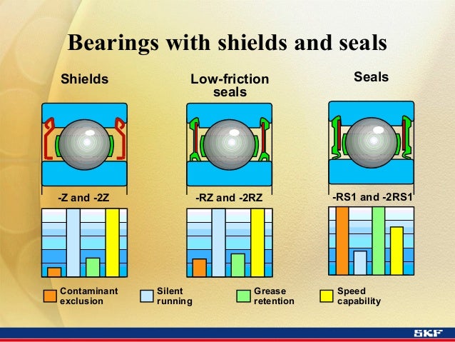

Many spindles have ZZ non contact seals for low friction, not that great against abrasives. RS would seal whole lot better, but sucks on high rpm.
https://image.slidesharecdn.com/1-141227035803-conversion-gate02/95/11-bearing-types-and-appl-guidelines-17-638.jpg?cb=1419674474
Traditional way would be to use labyrinth or such and use over pressure to block contamination route into bearings. To construct that on existing spindle demands bit more head skratching.
So, what are other choices? Haven't got into microns yet, but is it a good idea to pressurize plenum between two ZZ seal ball bearings - idea being that some air is expelled from bearing seal annulus and hopefully that would expel dirt coming into that way. It would need a flinger at the front of it stop direct spray.
I see here few problems, but is that serious?
1: Small annulus on ZZ seal - translates to low flow and small cleaning -> put a simrit ring next to it?
2: Pressure pops out seals -> lower pressure.
3: Dirty air contaminates bearings -> best to avoid getting that trough bearing, but that was the whole idea here->filter the crap out of pressurized air.
Completely stupid idea or has some merit?

There are two 6002 Z bearings on front. 15x32x9 mm and one smaller bearing on rear.
http://www.skf.com/uk/products/bearings-units-housings/ball-bearings/deep-groove-ball-bearings/deep-groove-ball-bearings/index.html?designation=6002-Z
Spindle is from 900 to 6000 rpm, speed vice fine with RS, but it will rob some power, the spindle is only 250 w.
Will dump the trough purge/lube idea and change the bearings....everything seems to be glued, staring from set screw, to bell housing.

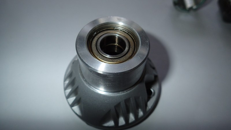

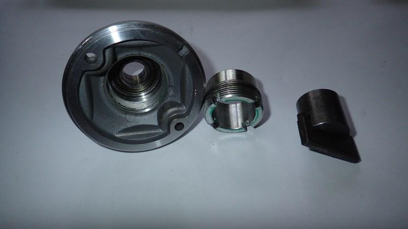

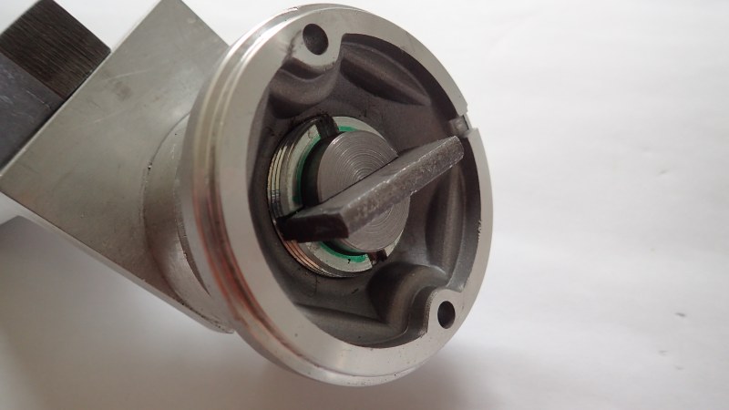

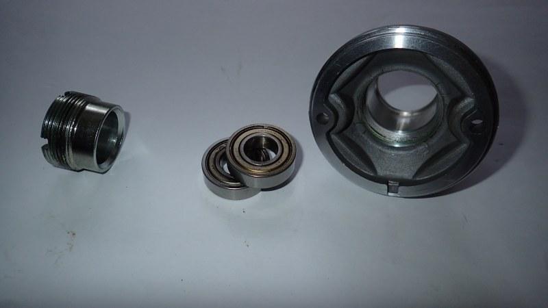

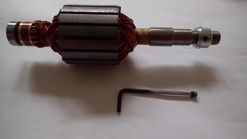

I tried to disaaseble the spindle, I see the bearing sizes, but dissambly is ont super easy. Everything is glued, even moderate heating does to work, have to heat it near 100C.
For set screw I had to modify allen key, 2,5  was way too loose, 3 mm or 7/64" would not go, I used diamond file to reduce 3 mm to 2,7 mm AF, hammered the key in, heated the spindle end to 65-100C and used pliers to crack open the set screw. You don't want to brak the set screw it is on alminium part and abuts agains spindle nose thread. Glued. Lovely.
After set screw is off the way, that aluminium shaft nut comes out easy with 17 mm AF spanner.
Spindle presses out from bearing housin easy.
There is a bearing nut inside the bell housing and that is glued and tight. Not off yet.
Re: Any advice on pressurizing (grinding) spindle?
« Reply #9 on: June 18, 2017, 11:51:08 AM »

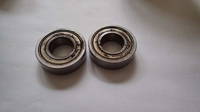

it needeed a got tightening on lathe tool holder from 43 mm circumfrence, application of heat gun on the castellated nut and a good grunt with a "special" tool + spanner. Bearings were finger tight on housing.
It had a liberal amount of green thread locker. Any recommendation? I don't want to go this tight again. Locktite 222?
Here are the pictures. It had some debris between bearings! And I could hear rought sound when I rotated them, nothing really agricultural wear, but clearly pasti it's prime.
Going to order some RS or RSL sealed bearings.

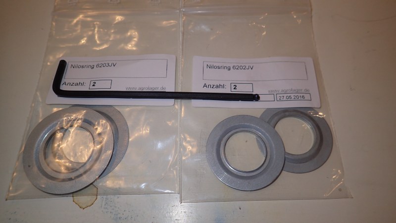

Pekka ... I have the perfect solution for You- in my non-humble opinion.
Nilos rings.
Google it.
They are zero-contact, non-contact, industrial labyrinth seals that are easy to apply and use, seals of zero friction and airtight, to an extent re:pressure.
And easy to apply, and cheap.
About 17€ each, maybe less for your smaller size.
Can be bought one at a time.
Absent fancy methods/tools, you apply it, and run it in 24 hours.
It self laps to an airtight fit, non-contact after run-in.

I have some and agree, they are pretty good, but you have to design them in. You just can't slap them in most of the time.
Here they would need some carefull modification, biggest issue is to make the shaft nut (that squeses the two bearings together) much thinner, the Nilos ring would seal to inner ring and interfere with clamp nut. Now this nut is aluminium and it would need thinning to make space for Nilos ring.
I did consider it and I'm reconsidering it, probably even enough to buy some more Nilos rings, always need some components at hand they are great to stack on see if they can be crammed in.

Ordered some Nilos rings that looks about right with the bearings. They haven't left the Germany yet, looks like it's not going get fixed this week.
I think that Nilos rings should be pretty concentric and on the same plane with the bearing: After all they wear a small grove into bearing ring. Best mounted into same seat with bearing.
