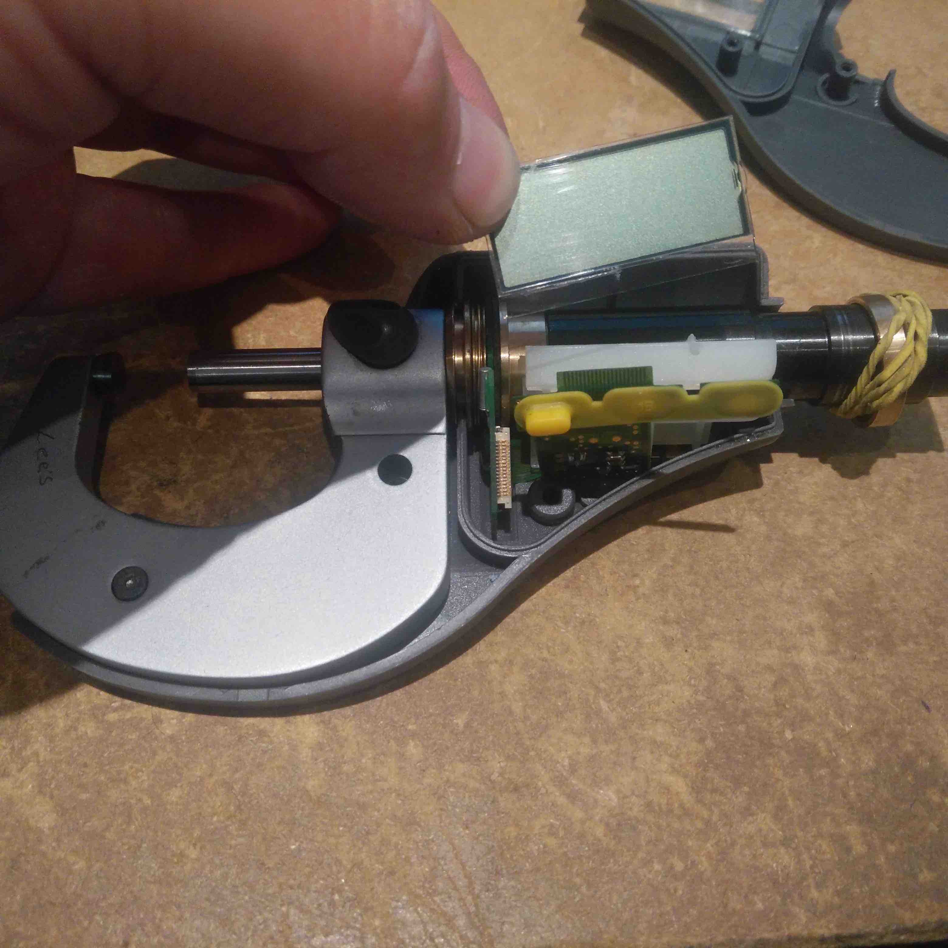

Hi all,
Had the bad luck of buying a second hand Tesa digital micrometer from eBay that after a few weeks stop working, so in hope of finding something blindingly obvious I decided to open it. :dremel:
After a quick inspection the problem was as indeed obvious, the LCD screen got detached from the PCB. :palm:
Unfortunately the technique requited to fix it is unknown to me and after researching in the internet just found a couple of very sketchy videos in youtube. :loco:
Does any us you wise madmodders know I can re attach the LCD screen to the PCB?
Best,
Joe

Usually there is a contact strip of conductive elastomer  for the contacts, and a clip to hold it slightly compressed.

You probably know that it does not need to be qlued or such.
That green "zebra" is elastic conductive connector and it makes the contact between LCD and PCB. It does needs a careful mechanical aligment to work.
So, what seems to be the problem originally? Zebra related symptoms are erratic display or missing elements, hardly never display has nothing in it.
Was it like this?

No clip I'm afraid Andrew, very weak design IMO from such a prestigious brand.
First I lost the first digit and then all of them Pekka and yes I need to carefully aline the conducting strips in both parts.
The videos that I found shows a Chinese guy at a repair/rework department attaching lcd screens to pcbs using a special tape but it's not clear what exactly is and how it works.
I'm hoping that PK may know the technique.

Returning to the O/P's initial question, is the LCD not trapped by the case against the conductive pad and PCB, and thus effectively the case is in this example the 'clip' ?

Just looking at the picture I would suggest that something is missing. Probably the conductive elastomer.
These are really special. They conduct vertically but not horizontally.
