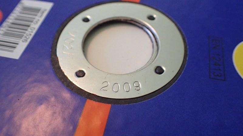

Yesh...organically bonded wheels have expiry date and that is pretty common on cut out wheels, they don't mature that well
http://www.highspeedtraining.co.uk/hub/grinding-wheel-marking-system/
The expiry date if it’s an organic bonded wheel (this will be 3 years from the date of manufacture).
This marking is often on steel cap/hub, often sample discs that come with grinder are allready expired.
Short dig from the garage revealed this:

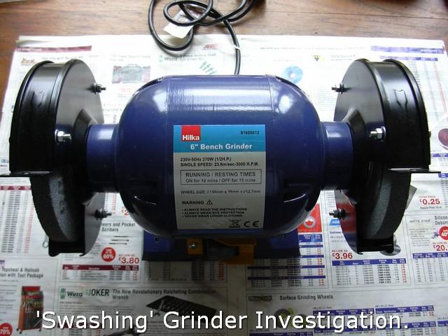

In addition to my original 7" Black & Decker double-ended grinder, I have a smaller single ended grinder.  This has the wheel and rest on the left-hand end and is fitted to accept a flexible shaft on its right-hand end.  I wondered about fitting the white cylindrical cup wheel to that machine but it would be turning the wheel the wrong way.
I recently made an impulse buy, a modern 150 mm double ended machine.  It's rated at 370 Watts but with a 10 minutes ON, 15 minutes OFF duty cycle.  The motor runs quietly enough but when I saw how the wheels turned, the expression that came to mind was 'swash plate'!!  I've left it too long to ask the seller to accept a return and, besides, the purchase price was alleged to be reduced.  In his book, Harold Hall describes mounting an entire double ended grinder on the bed of his lathe and using cross-slide and top-slide to true the grinder shaft ends while it revolved under its own power - I'll probably be trying that some time.  The wheel mounting washers are pressings but look to be true enough.

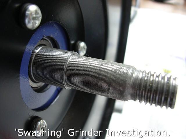

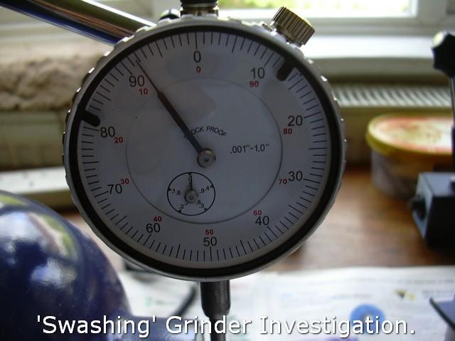

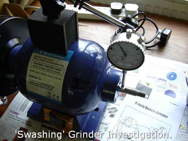

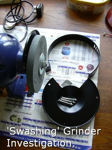

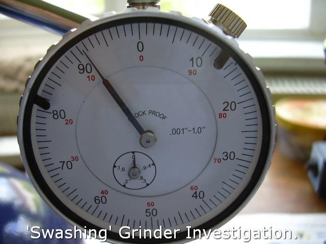

I eventually got this grinder to the top of the 'to-do' list.  The photos show the complete machine, then various stages of dis-assembly of the RH wheel & guard and finally the dial gauge readings.
The shaft extending from the ball-race has three sections, diameters 14.5 mm, 12.72 mm and thread M12.  I measured the peak-to-peak run-out of the two plain sections at between 0.007" and 0.010" (sorry about the mixed units).  There's a centre drilling in that end of the shaft and, presumably, one in the LH end also, so I assume that the motor rotor and shaft are turned between centres.  I reckon you'd have to do something fairly clever or astonishingly stupid to get 7 to 10 thou run-out that close to the bearing journal and centre!
The shaft surface finish was interesting, not so much a cylinder as a very fine thread, about 75  to 100 tpi!  I re-assembled the machine before I up-loaded the photos and the photos don't show the surface finish.  If I dismantle it again, I'll take another photo just showing the shaft extension and its finish.
I couldn't measure any run-out in the face of the step between the two shaft sections - the step is too small to give my DTI a satisfactory contact.
The abrasive wheel from that end of the machine lies flat on the surface of my dining table so I think that's not the cause of the swashing motion.  I'd like to measure the lateral run-out at the outer edge of the wheel (when mounted) but I didn't want to apply my DTI stem to the wheel.  If I think of a safe way to take that measurement, I'll post again.

« Reply #19 on: July 28, 2017, 06:25:48 AM »
Years ago, I had the same sort of trouble which was traced to rotten wheels, out of balance and worse.
From what I have read, it is 'normal' to replace the wheels with something more in keeping with our hobby demands
HTH

« Reply #20 on: July 29, 2017, 06:48:45 AM »
As promised, I've taken a close-up photo of the shaft of the grinding machine, see below.
If this is the current professional standard for surface finish, does this mean that my efforts to emulate the surface finish achieved by the YouTube machinists community have been a misguided waste of time?
   :bang:   :scratch:   :bang:   :scratch:   :bang:   :scratch:

Looks like a suitable case for turn undersize and sleeve!
Re: Bench Grinders & Lathe Tools.
« Reply #23 on: July 29, 2017, 02:41:44 PM »
That's normal for a cheap grinder. The plates rely on that little step but it's inadequate. This is why I turned my own side plates. I actually turned the plates as a 'plate and hub' so that the bit that sits on the shaft is longer. I then use wheels which have a larger hole, and it works very well, they run nice and true.
