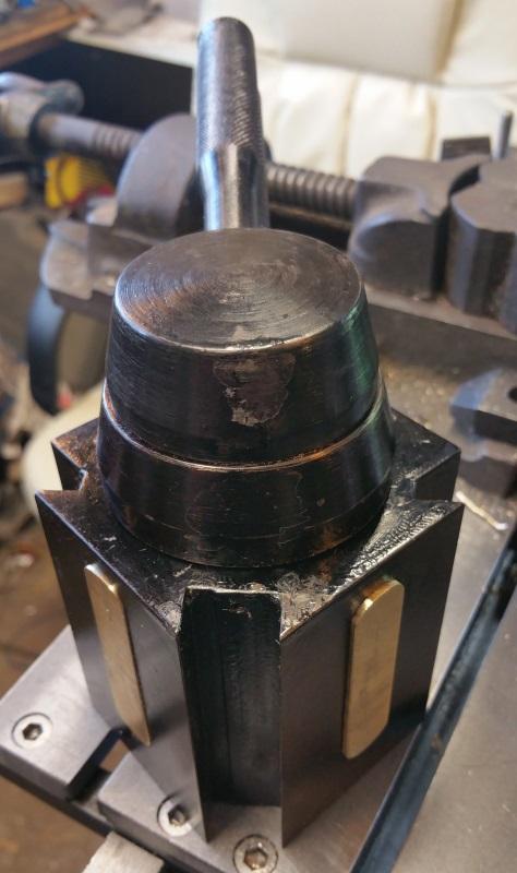

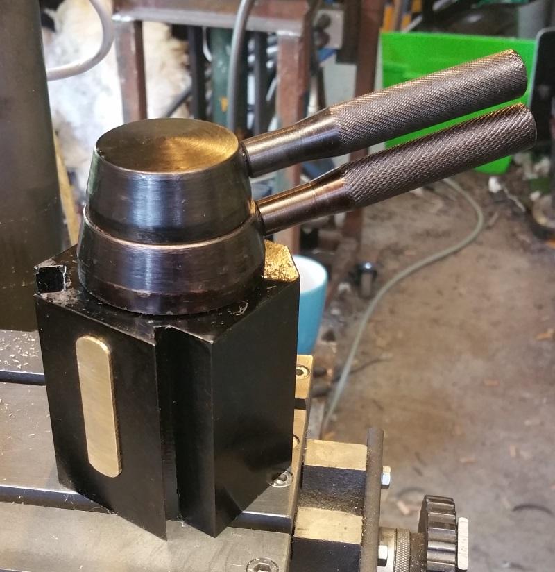

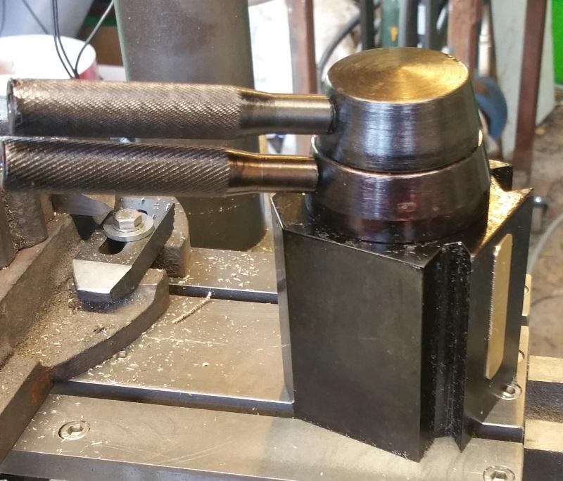

first foray into blackening was almost a success, its good enough at least. The body was the last bit I did and seems to be the best finish this was done by setting my furnace to 360C and applying linseed oil once at temp then blowing excess oil away and then reheating till black.
I have put the worst bits in the final pic because I would welcome any input to make a better job next time I try.

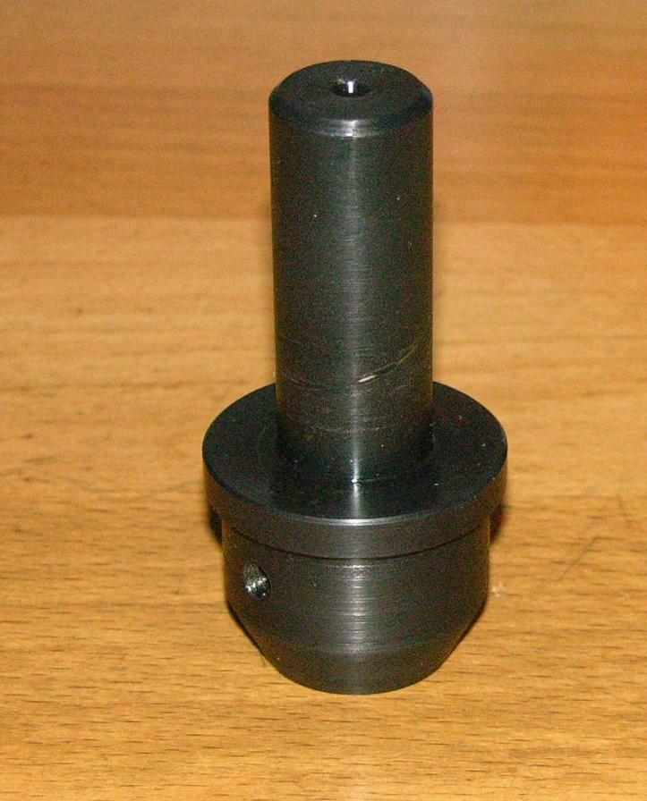

Here's a 'fresh from the bath' shot of the cold black process I use' Pretty sure I got it from Caswell.

Surface must be clean fingerprints will show , I just heat with a torch and drop into used engine oil , works for me .
I think that may be the problem I did clean it off with turps before starting but maybe should have spent a little more time on this part.

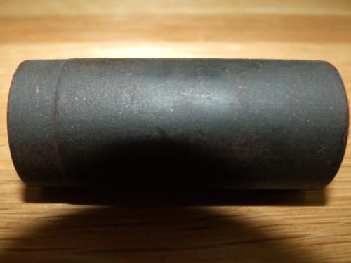

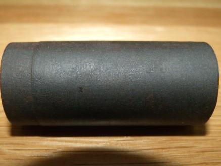

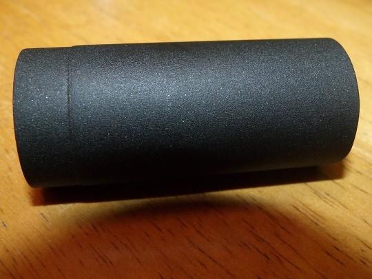

It just so happens that I kept the example that was pictured in the Oct. 2013 thread as  mentioned in Tom Ossleton's post ^^ up here.
It has been kicking around my workshop for the past few years, during this time it has only been oiled (WD 40) once.
I don't think it's done too bad as most steel in my place manages to develop surface rust in a matter of a few weeks. If it had been oiled on a fairly regular basis I'm sure it would still be as good as new.
The second  pic is the fresh item and the following are as it is now.
Regards,  Dave

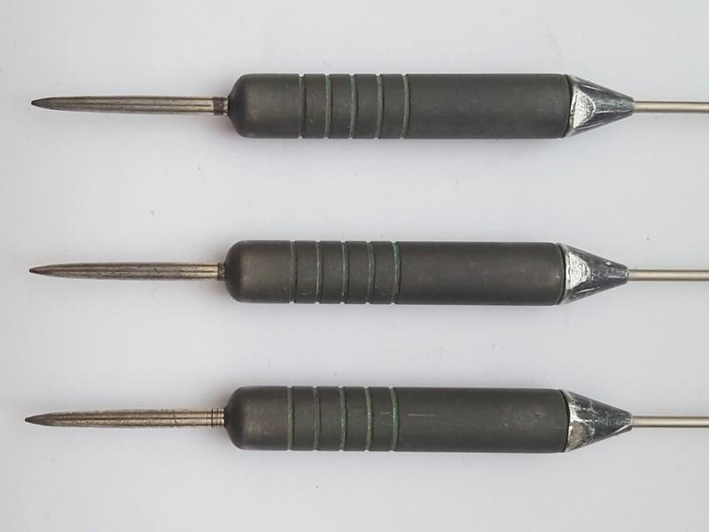

Reading this brought to mind a set of darts that were Parkerised courtesy of The Royal Small Arms Factory Enfield in the mid 1980s.
The barrel material is tungsten carbide.
