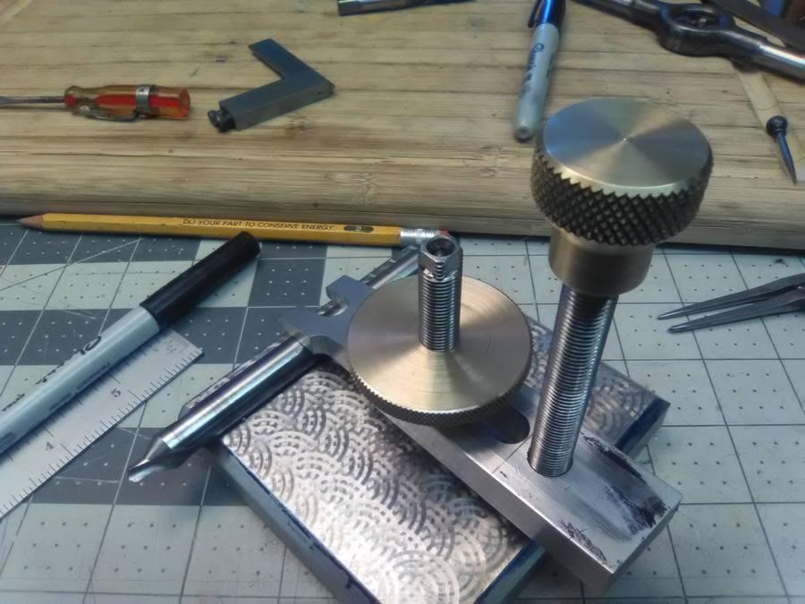

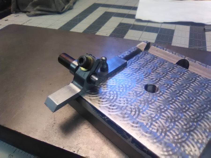

Hello lads and lasses..

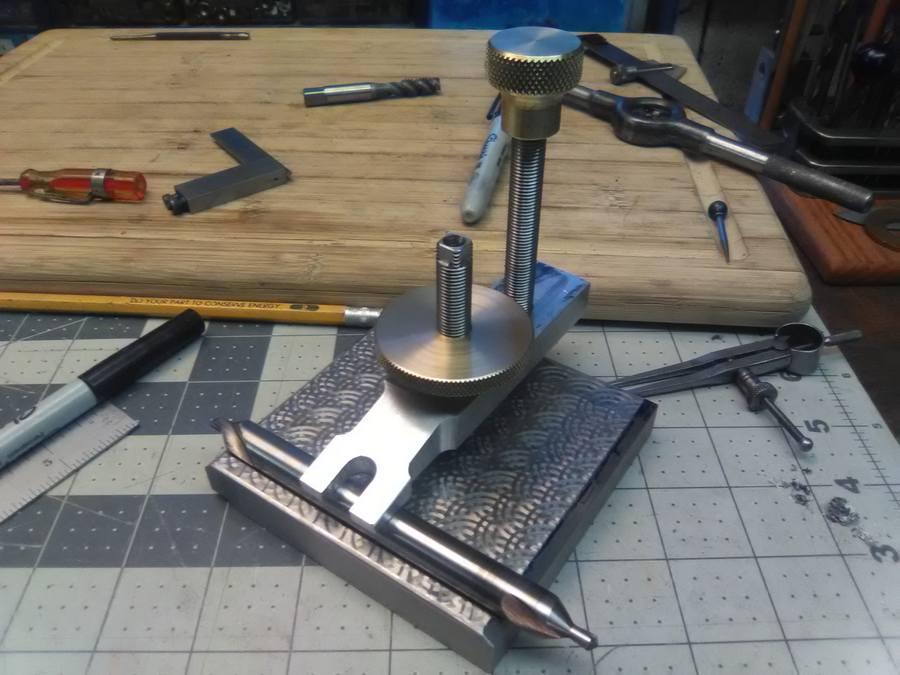

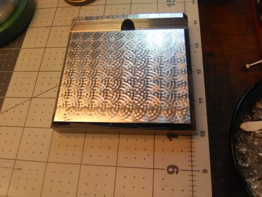

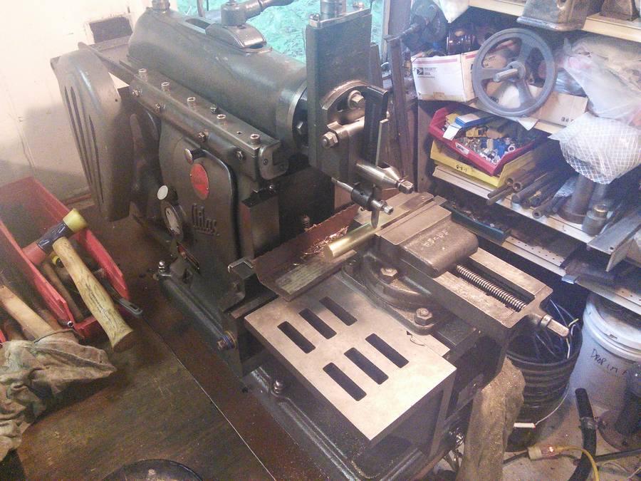

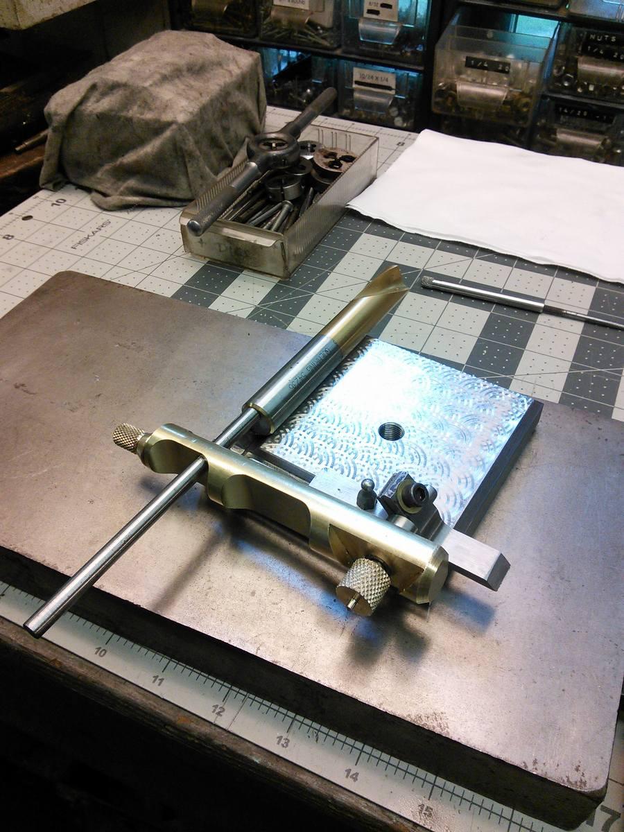

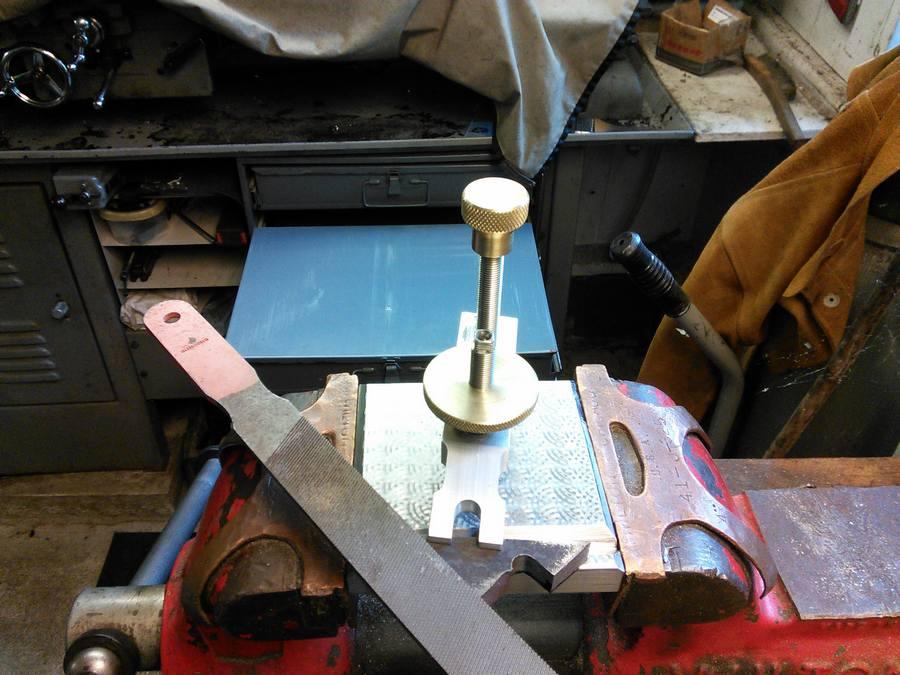

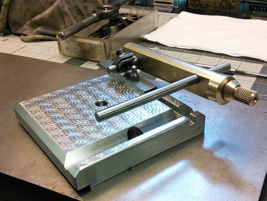

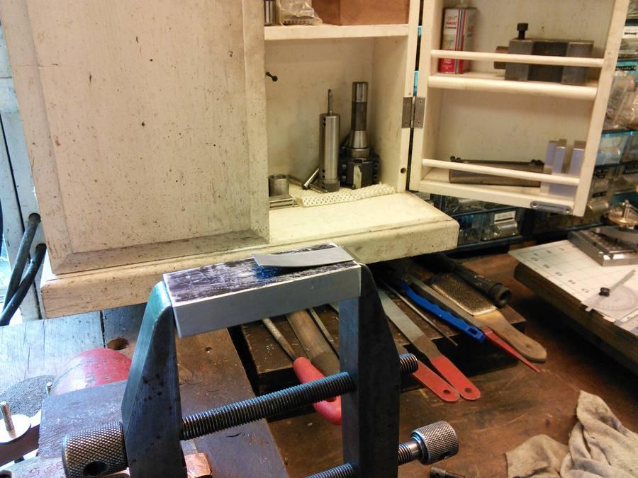

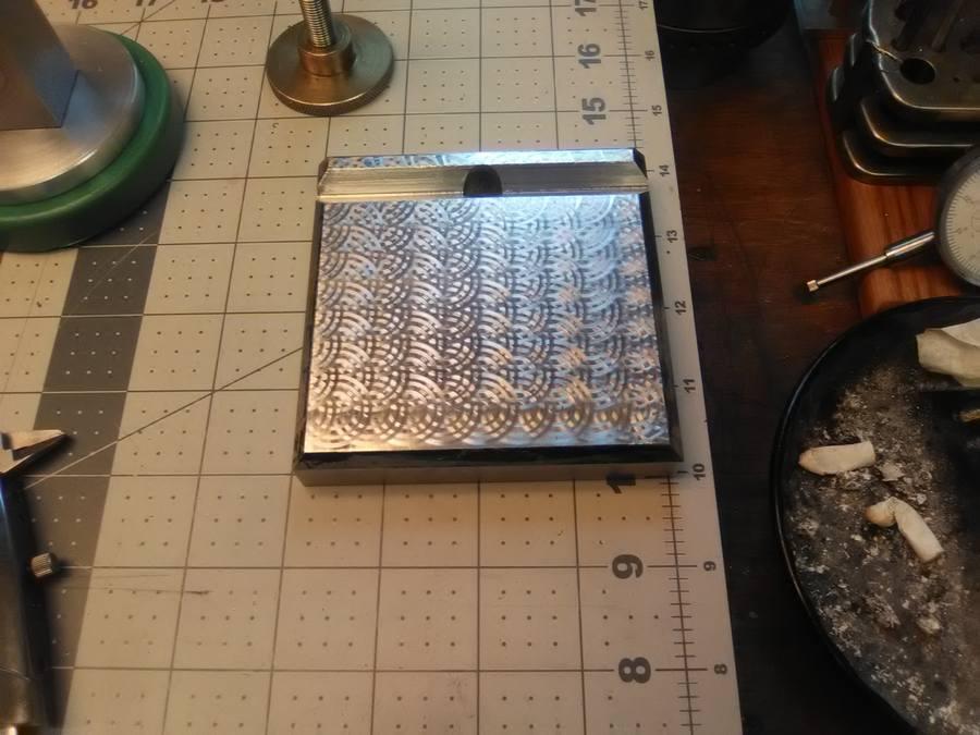

been wanting to build myself a finger plate for yonks now so I went off to the scrap bin and dragged out some material, first to be salvaged was this chunk of stainless plate, i whipped it into shape on the shaper, still on the shaper I profiled the v-groove and drilled the punch hole on the mill, i was in an adventurous mood so i applied some engine turning on it as i want it to look posh and to keep with a particular theme.
I made the finger itself from ally but will make one in steel I just needed something now so i can use it, its being designed as i go along but there are a couple of features I want included in it such as a work stop and on the same arm i want a scribe block for quick marking out on the surface plate using a scale, I like the look of old Victorian era design in tooling and i will do my best in giving that appearance.
I started on the scribe / depth stop arm but that's where I have stopped will carry on through the week... Enjoy and all the Best.. Anthony.

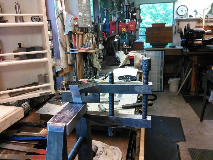

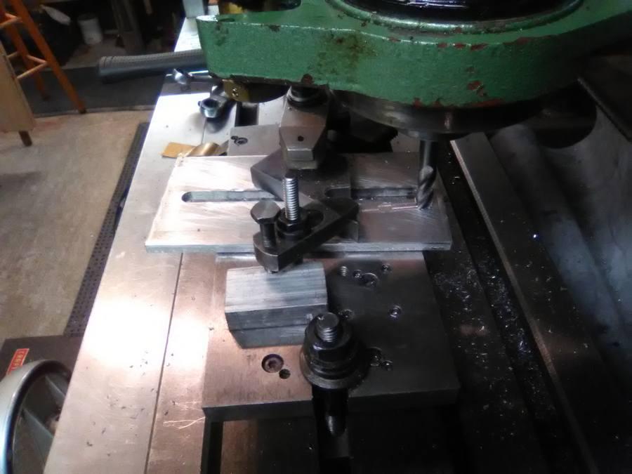

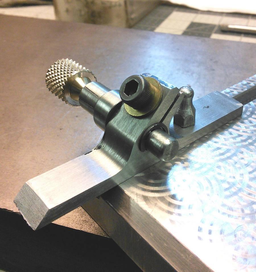

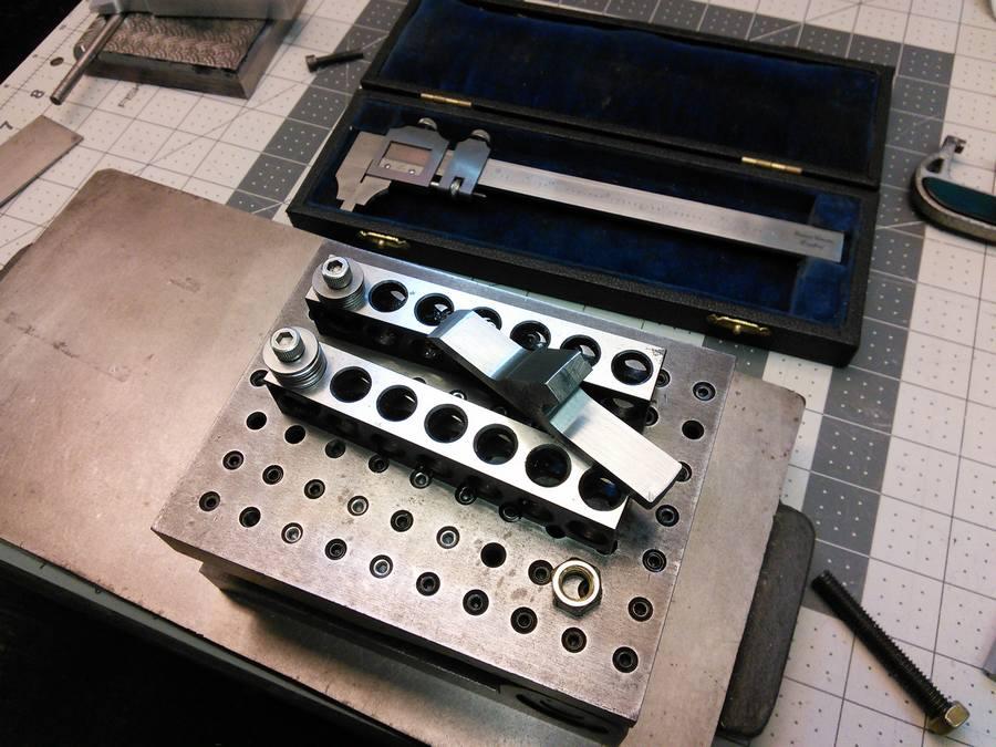

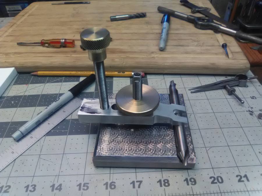

Here i am making the locking block for the swivel for the depth stop / scribe arm.

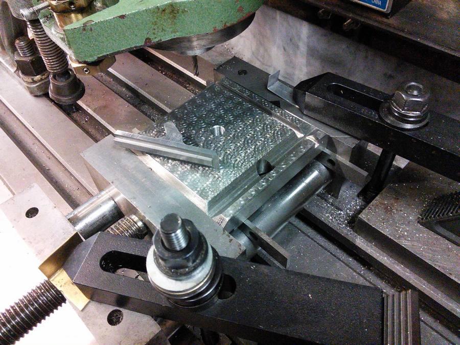

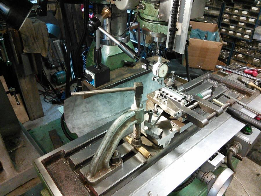

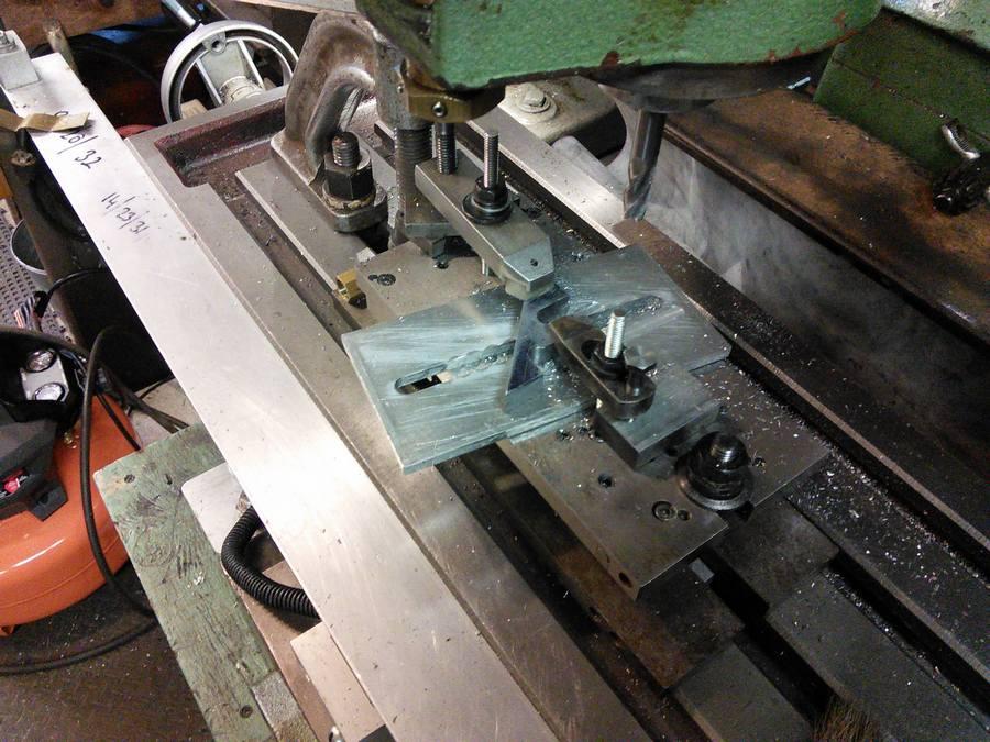

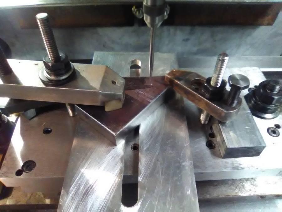

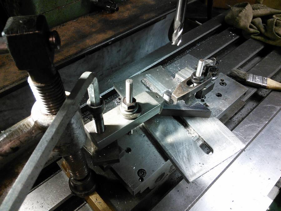

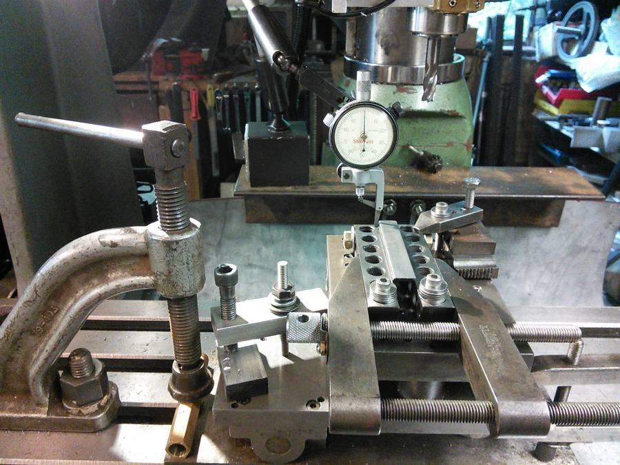

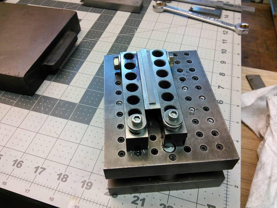

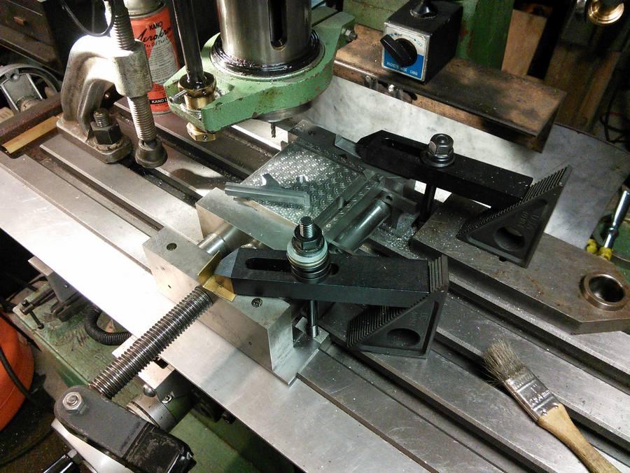

Its time to mill the male slot onto the swivel arm housing and mill the female slot on the plate
You may have noticed i like using fixture plates, I like to build my operations on a surface plate on the bench while sitting on a stool, situated around me on the bench  I have trays full of bolts, shims, packer blocks and washers, as i build the operation i use the right angle fixture to square off to the surface plate, once its built i can confidently take the build to the mill knowing all i have to do is square it off to either x or y axis. but its biggest advantage is you can hold awkward small parts and perform tight machining operations.
I took sparky's suggestion and made the slot the complete length of the plate.
Ever onward... Anthony.

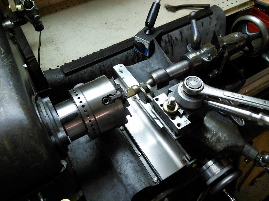

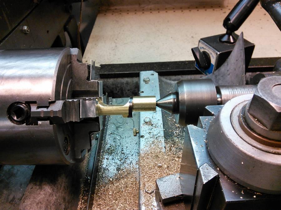

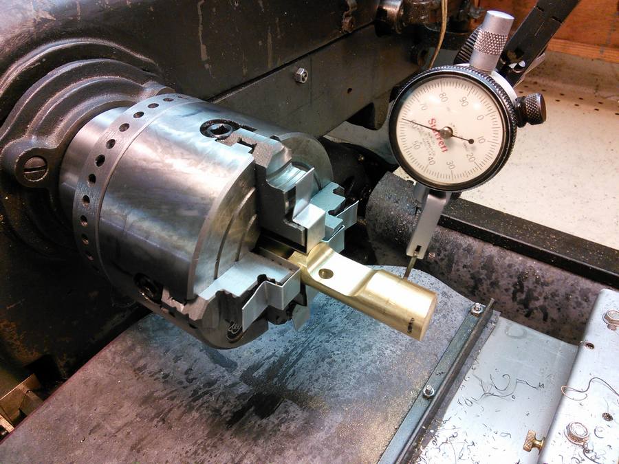

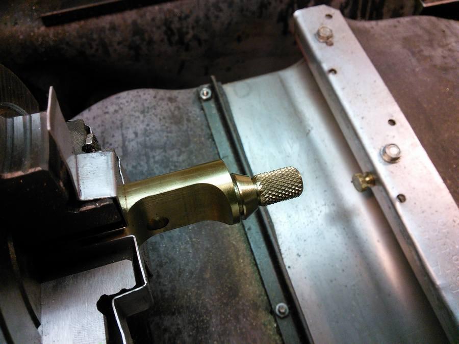

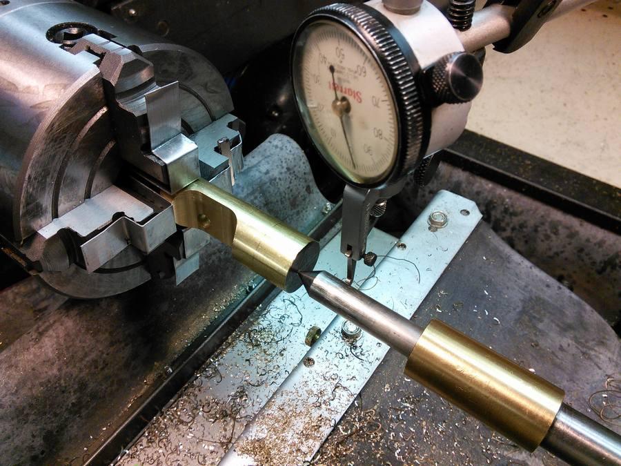

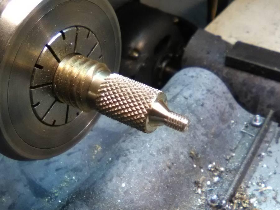

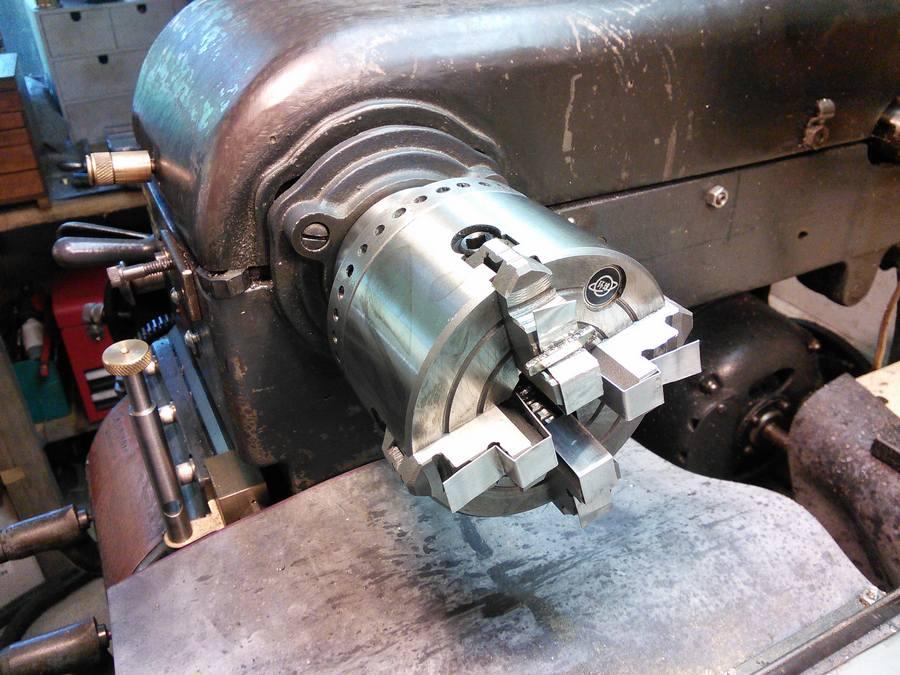

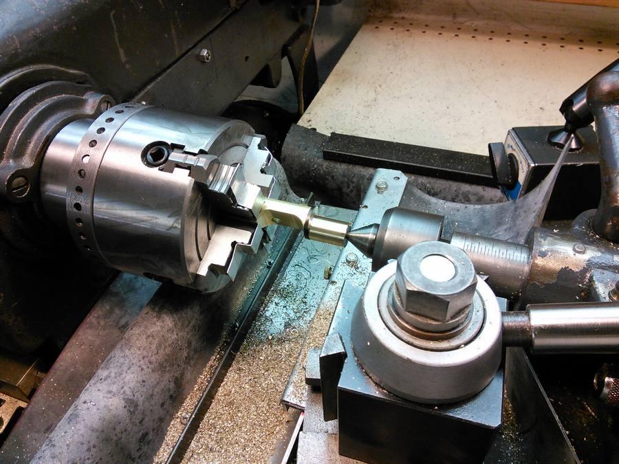

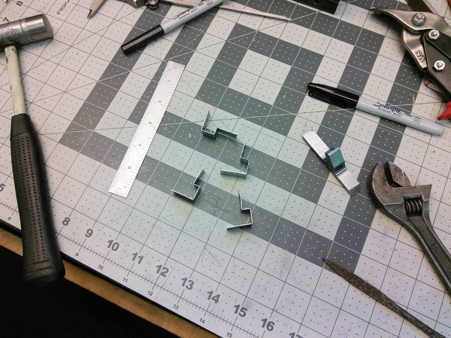

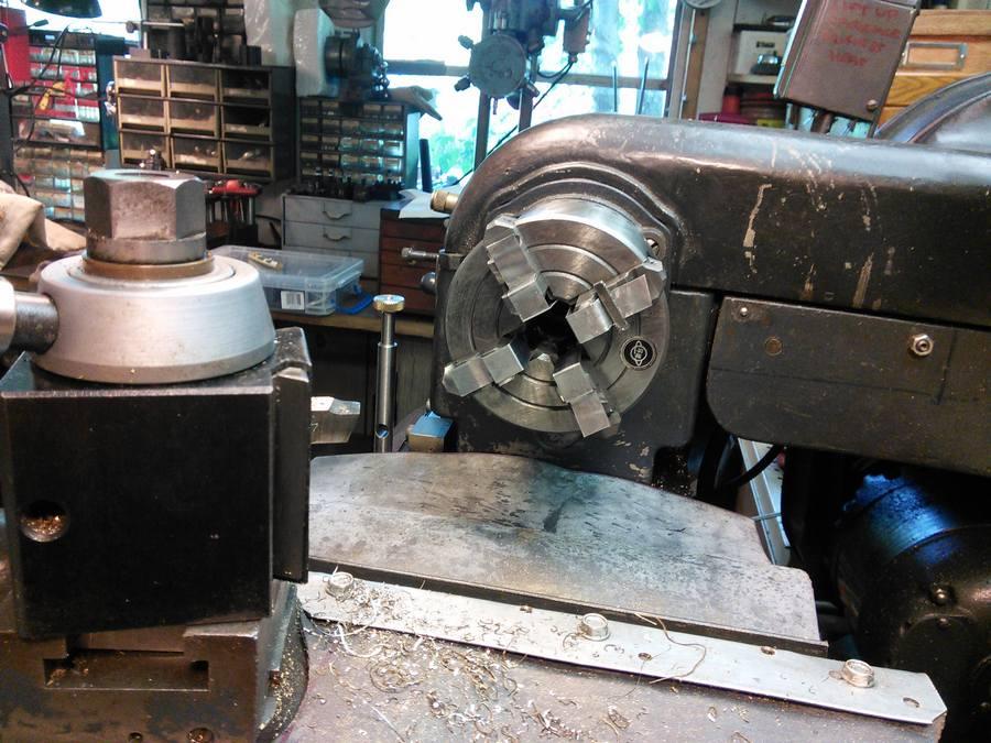

Made time to do some lathe work today, I wanted to do some off center turning making a cam so i decided to make the finger handle off=set then apply a knurl to it, since this needed to be applied in the 4 jaw and I did not want to put jaw marks into it i so I made soft jaws out of aluminium strips for in-between shims to stop the marring.
we are getting close to finished... All the best.. Anthony..

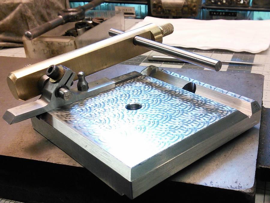

« Reply #8 on: May 28, 2017, 07:48:14 PM »

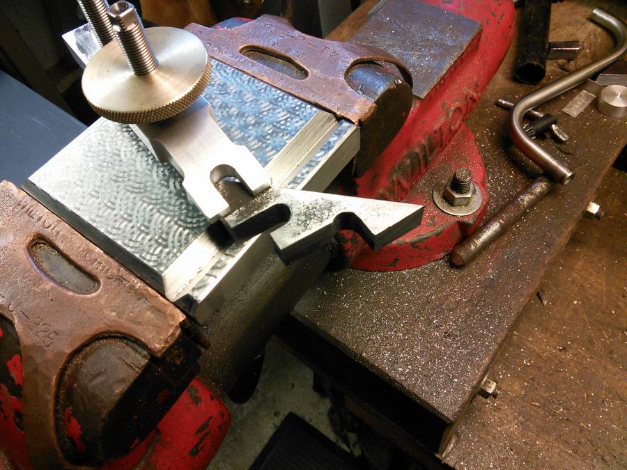

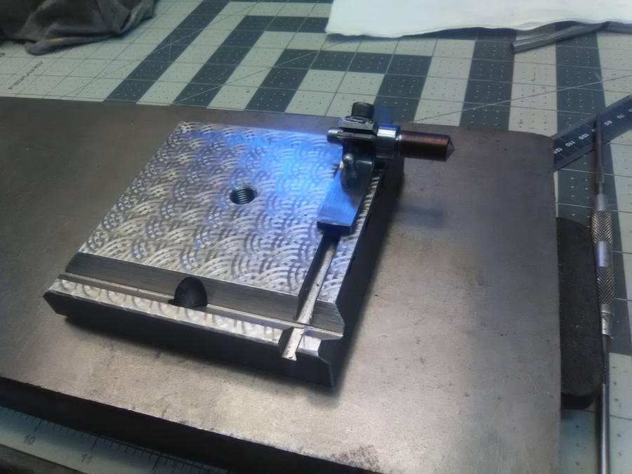

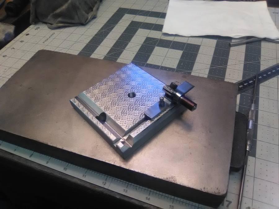

This is how far i got today...

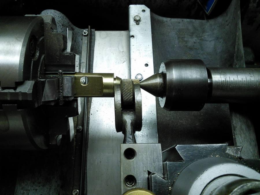

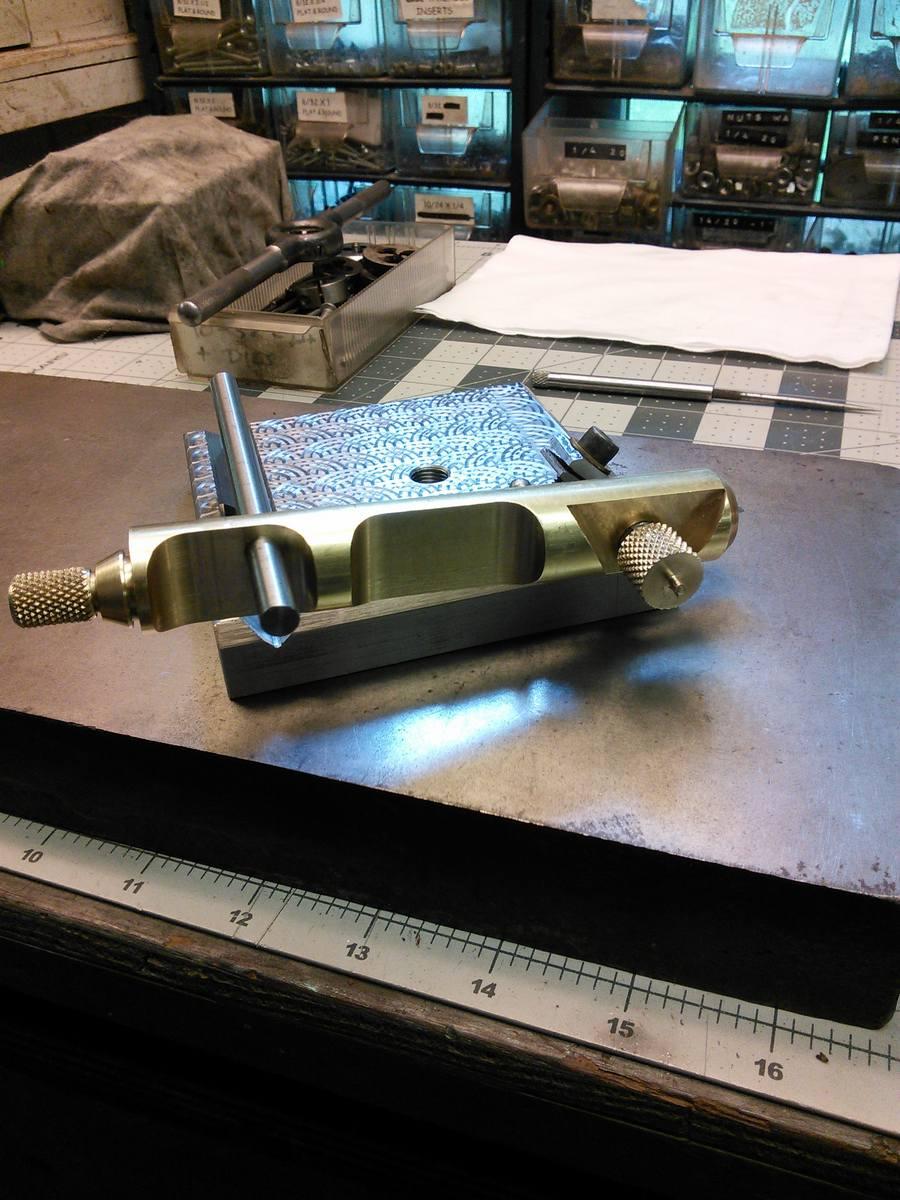

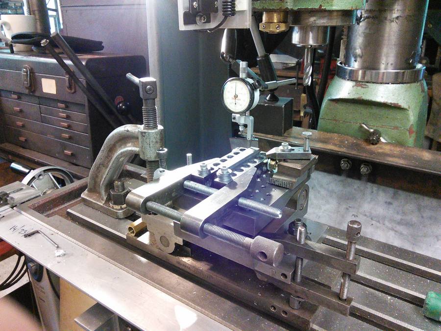

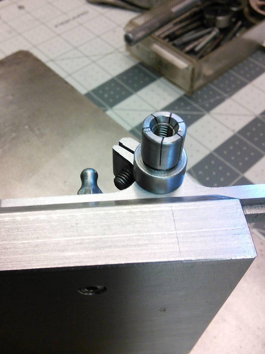

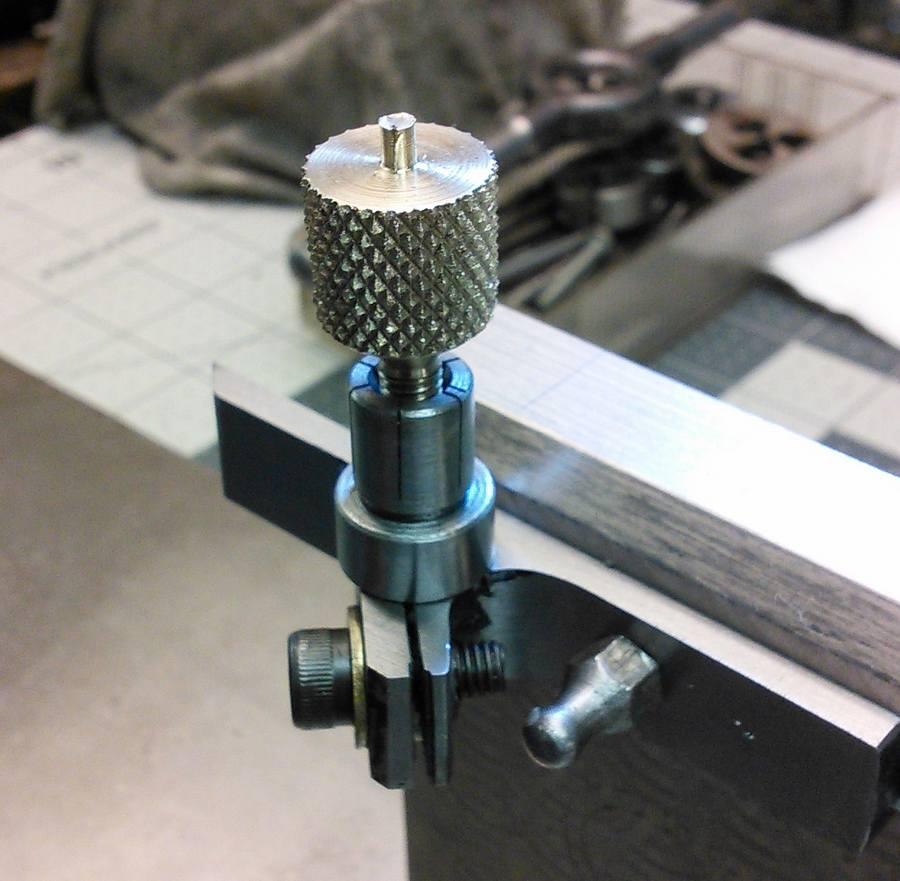

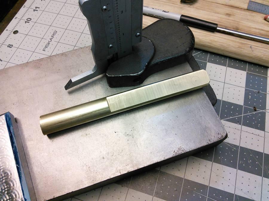

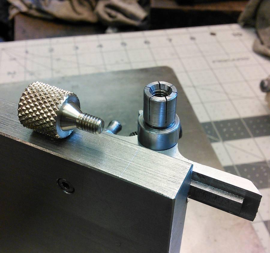

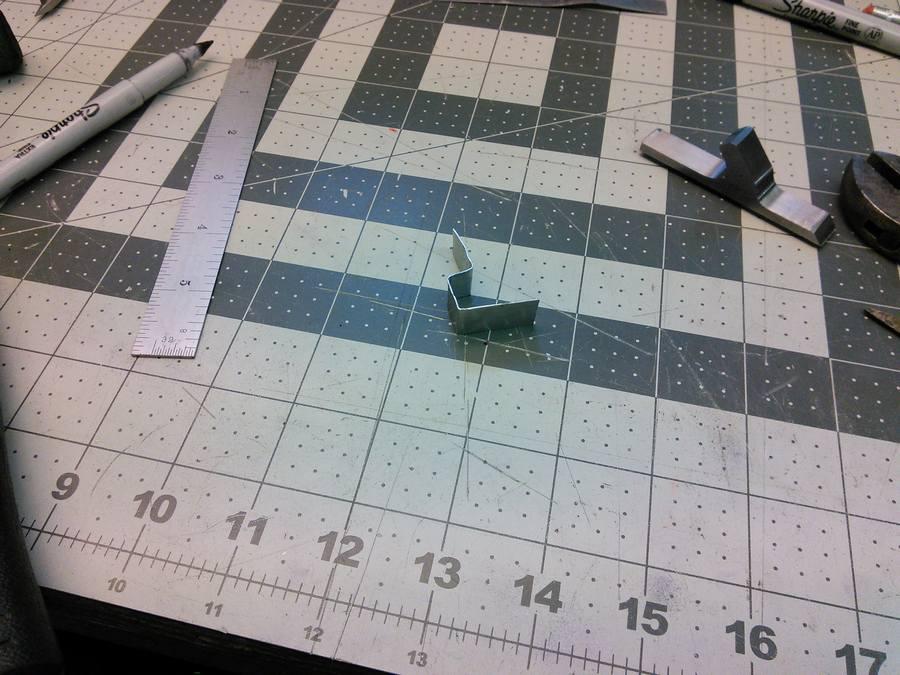

I was back in the shop for a few hours yesterday and i focused on the scribe / stop arm particularly on the pivot pinion.
The scribe arm cannot have any play in it and needs to be held rigid yet rotate smoothly, i was going to loctite the arm on the pin but i thought ahead and pondered i may want to add another attachment to it so i opted for an expanding mandrel action so i slotted six slots in the pinion and threaded it 10-32 and gave a 60 deg land for the brass threaded knurled thumb screw. I also opted for a lugged circlip to hold the pinion in the pillow block housing keeping it located while the arm raises and lowers.
I so enjoy not working to planned designs as I like to add and subtract features as i go, i also find working this way you never end up with what in the first place you wanted to do its just plane fun.
Enjoy and be happy as Vladimir would say...   :D    Anthony.

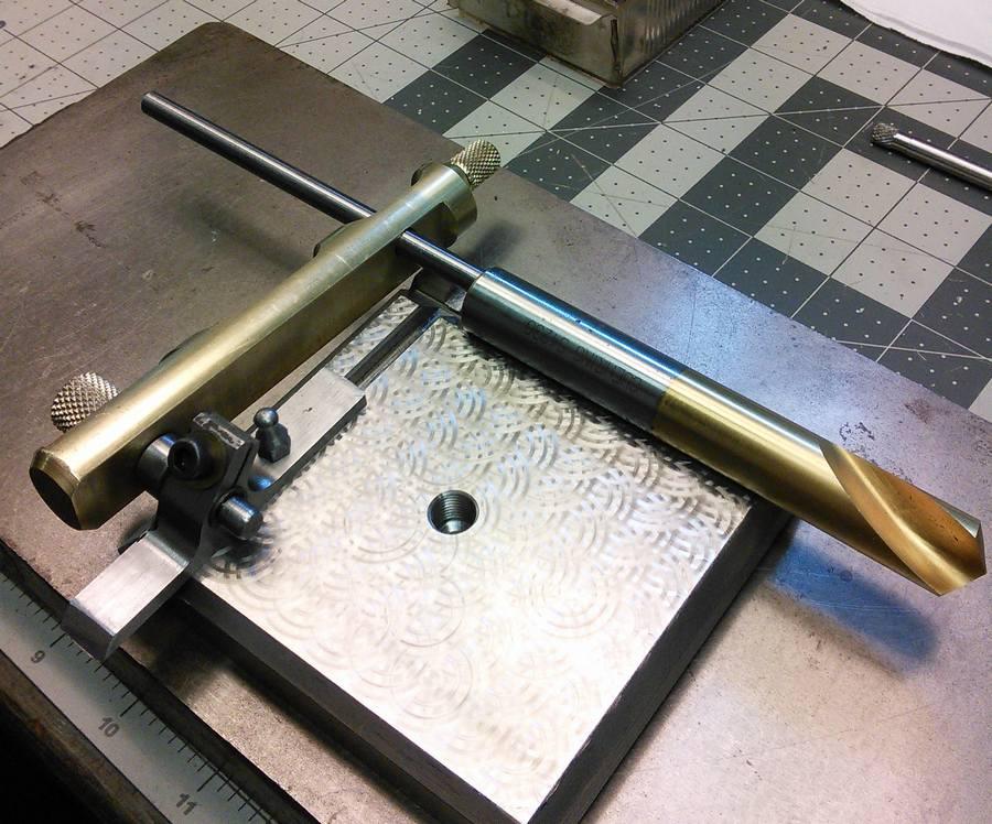

Finished up a couple of things I am very happy with the action on the pinion its tight and there is no deflection or flexing in the arm. I am now working on the scribe pin holder and i am putting in holes to fit my Sine plate platen so this can be used on angles which will be a nice feature because it will eliminate V-Blocks on some set ups..
