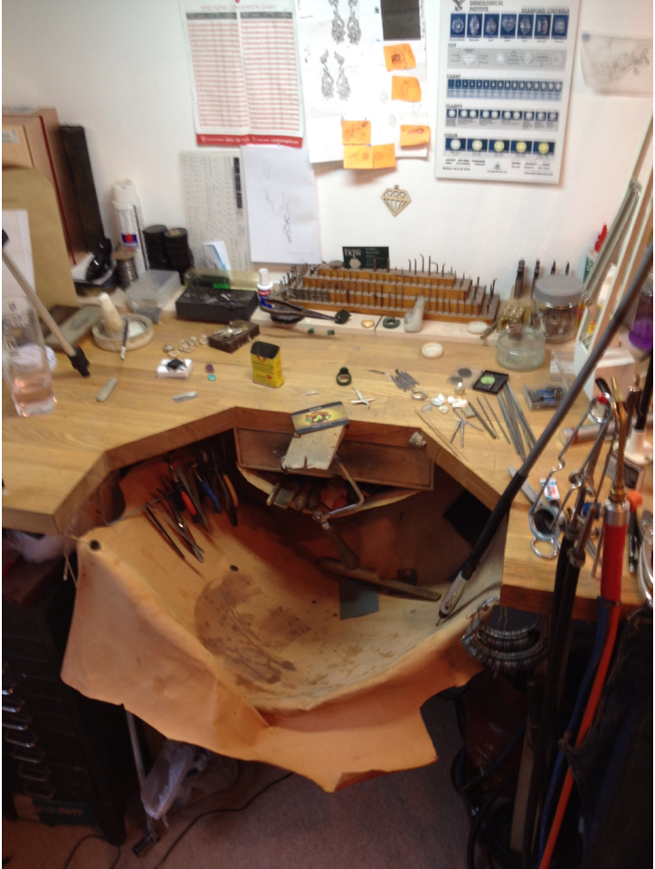

I built a jewellers bench top I can mount in the bench vice on my steel bench.  The jewellers bench can have a tea towel pinned underneath to catch fasteners etc.   Very handy for working on small and intricate parts.   Something like below.
