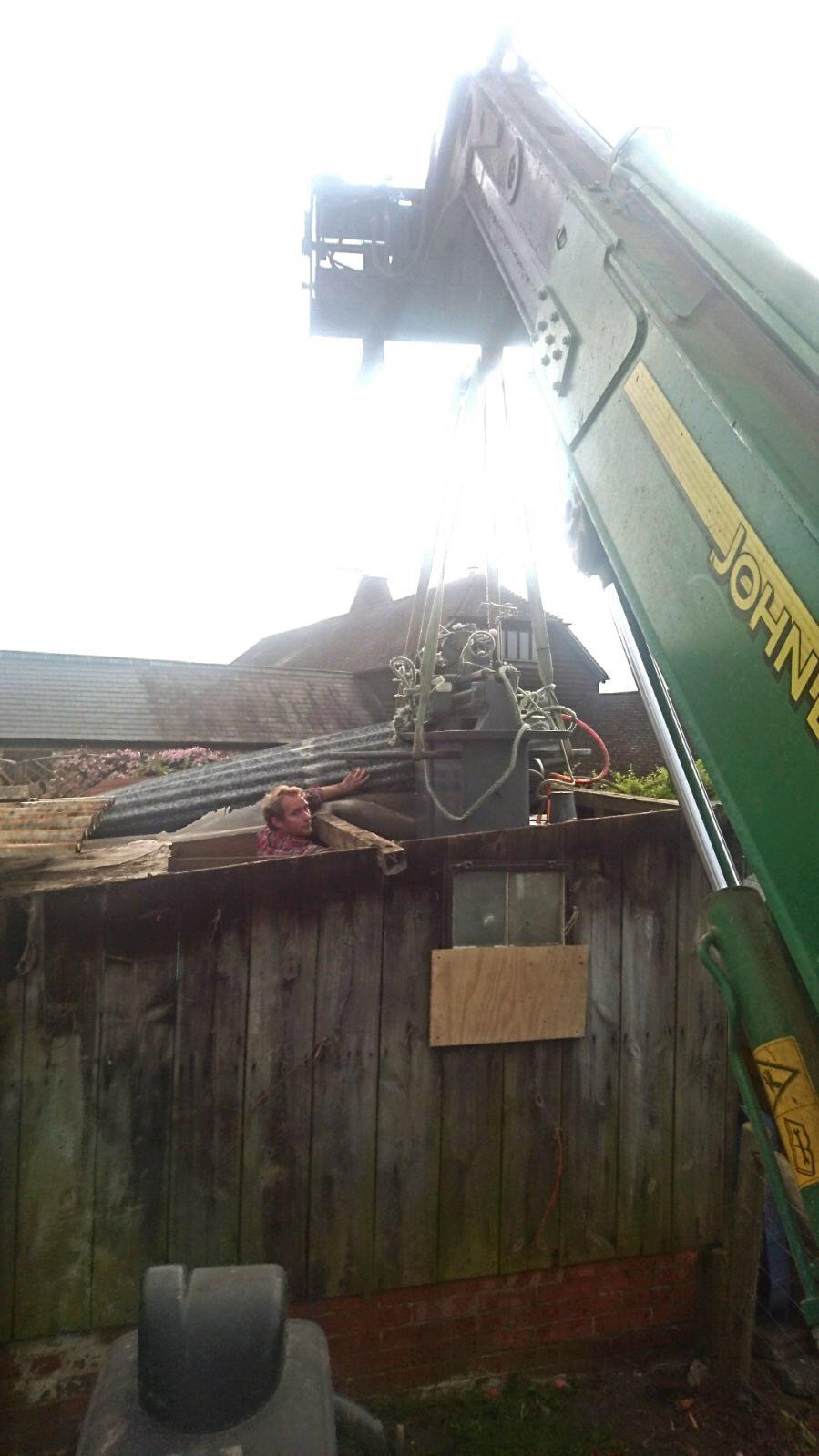

I work as a farmer in the Kent countryside. Have just started to get a workshop going with the acquisition of a Harrison 140, should be collecting it early this week.
Won't go in via the door so having to take the roof off and boom it in with the telehandler!

The Harrison's flight into the workshop for those that wanted to see it.
Not the best, but the only picture I have.

As you can see it's Quite tight. Had just over an inch clearance each side.
Despite having a few big barns I decided to use the smallest possible space available to me to squeeze the workshop into! Mainly because it's 3 foot from the back door!
