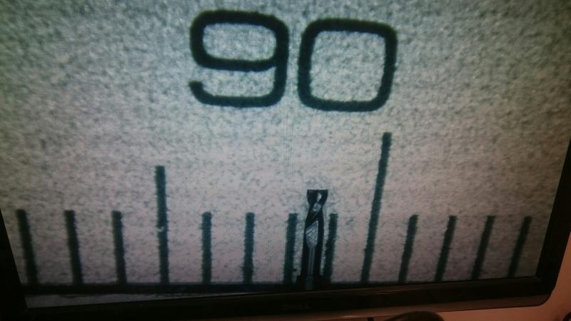

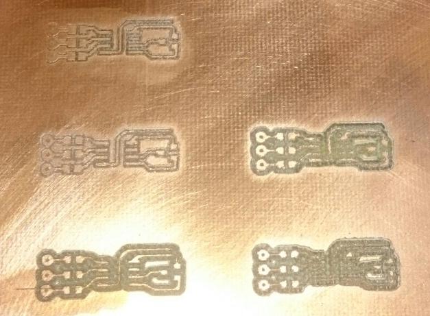

I thought I'd give isolation routing a go in the X3 with the 60Krpm sub spindle.
It went well enough that I've ordered bits to take it to the next level.
Lessons learned:
  • Generic engraving cutters aren't close to well enough balanced to run at more than 30KRPM.
  • Small (0.5mm) carbide endmills work wel (used a v cutter in the attached).
  • A vacuum hold down fixture is important for keeping the stock flat..

Say hello to my little friend!

Have you tried Voronoi style traces?
Offline PK
  • Posts: 369
Re: PCB routing
« Reply #5 on: April 25, 2017, 05:34:22 PM »
You know, I'd never heard of them.  If the tool chain is short I'll give it a go.. Sadly the ball screw rebuild that resulted from this attempt has turned into a bigger than Ben Hur 'Cluster F&#k' of a job, with stripped threads and......
