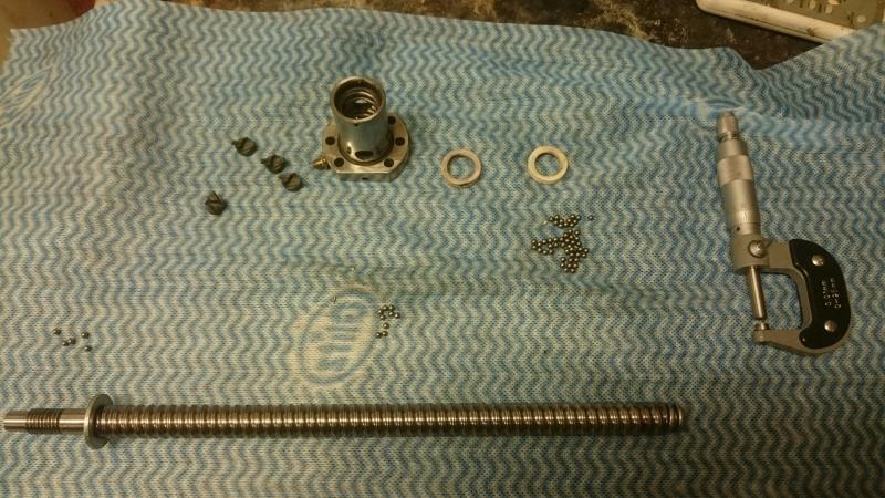

Remember boys and girls, without mechanical stops, you're only one GCode typo away from a ballscrew rebuild!
G0Y820..... What was I thinking?

OUTCH!
Ballscrew snapped? What else?

Software limits would also be a 'good idea' perhaps

OUTCH!
Nah, it just wound the screw all the way out of the nut and deposited all those little bearings in 6 years of accumulated swarf and muck under the table.. I think I recovered them all.. :-(
You can see in that pic that I've already tapped the end of the screw to take an M8 bolt, that'll hold  a plate that will stall the stepper if I try the same trick again...
It took 5 minutes to drill and tap that screw. It'll be an hour or so to rebuild the screw and reinstall it....
How does it go? " No one has time to do anything properly, but we all have time to do it twice!"
Yep, a hole drilled in the base and nail hammered in to limit travel would have worked too.. Hell, just about ANY amount of thought and effort could have prevented it!

PK,
To quote yourself from August 2016:
To rephrase:
Basically, you don't need limit/home switches on a basic machine.
Limit switches would have saved you some work! :(
