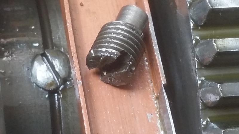

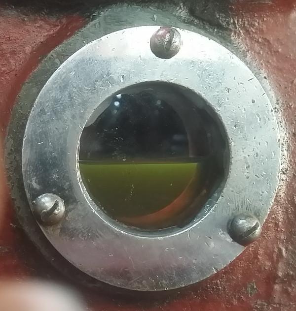

Finally changed the oil in my Edgwick Head stock. 5 imperial pints (2.84litres) of ISO VG 100 hydraulic oil. the only way to get the oil out was with absorbent rag, it was about half full when I started!. I changed the sight glass as the original was cracked and leaking, nothing special, an old bit of glass cut round. I don't think the oil had been changed in a very long time, fine tooth chips, but nothing alarming.
The thing that prompted me to write was that I found a screw in the bottom of the headstock, (photo below) I think that it has been replaced by the screw that is on the left of the picture as the screw is locked with a couple of centre punch marks and not the wire ring that the other screws are locked with. Adev, could you look on your manual on the exploded diagram of the headstock(Plate S.P.1322) to see whether the screw in the photo below looks like part no 308,  the plate in my copy is cut off on the edge of the gear307!
Thanks in advance, Matthew

Funny these things that 'turn" up! I'm pretty sure my screw has already been replaced!
Cheers Matthew
