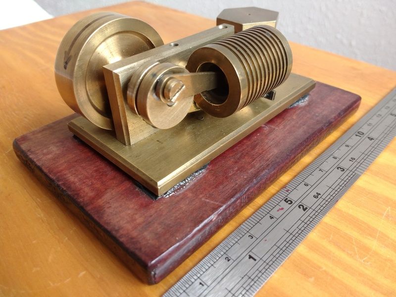

Mid February, another orphan flame licker arrived. This one's, tiny!   :scratch:
 As I understand. Made in Germany. Travelled to Denmark. Then to Hereford. (UK). Finally, to my door, in Derbyshire.
No arrival pics. Here's, Little Munchkin.......
Bore, 13mm. Stroke, 11mm. Not ideal dimensions.......

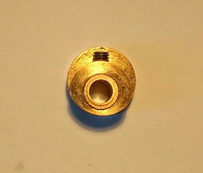

The cam, was an eccentric.......
Now, it is a 120* cam. With 6mm lift.........
The undersize, alloy piston. Was replaced with graphite. The cotton wick replaced with s/s mesh.
I've done all I can think of, to bring this orphan to life.........
Close. But, no cigar! (I think, I'm trying to change the laws of physics)......
Any further ideas? Anyone? Pleese.....

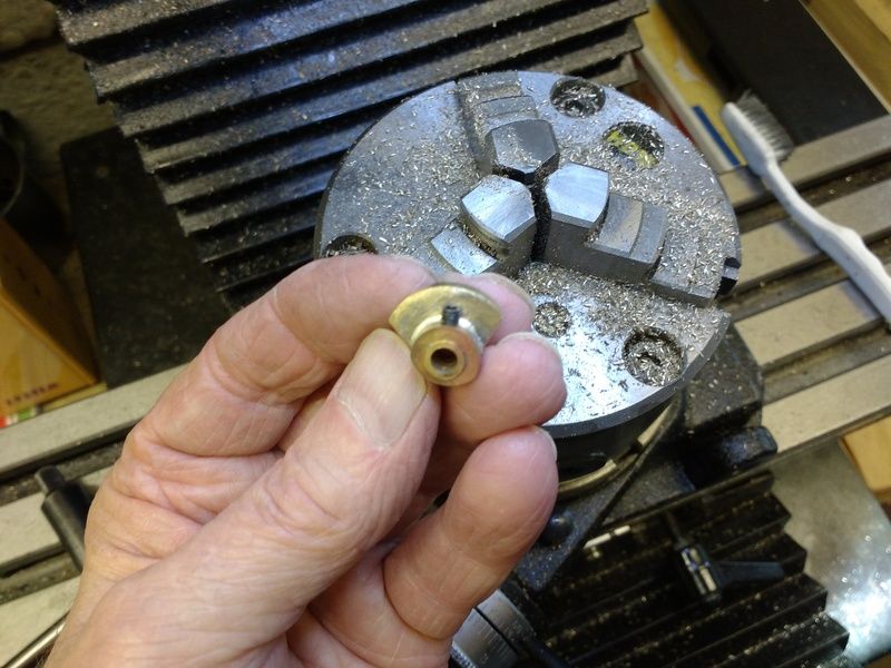

After some deliberation. I made a couple more mods.
New cam. This time, 180*. Which seems more logical, to me.......
Modded the wick tube, slightly. To give a wider flame, at the port area......

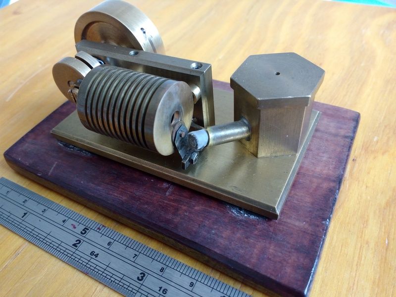

The test, (not quite), run......
That's the second time, it has perked up, on camera!
 Though..... Mrs. Drillin was doing the filming. (We all try harder, when She's around).......  :thumbup:
Seems. The only mod left, is to ditch the 1/4" dia saucer, and fit a shim valve. Like Poppin(?).....

 Do you think it really matters?  :scratch:  ..... As long as the port is fully opened/ closed. Any, over movement, would be absorbed in the very imprecise timing.......
Frankly. I couldn't get the disc any lower down. Cos' it's too close to the operating lever.......
Anyroad!
 After making two, shim valves. Which broke, as they couldn't stand the necessary bends, to seal the port......  :bang: :bang:

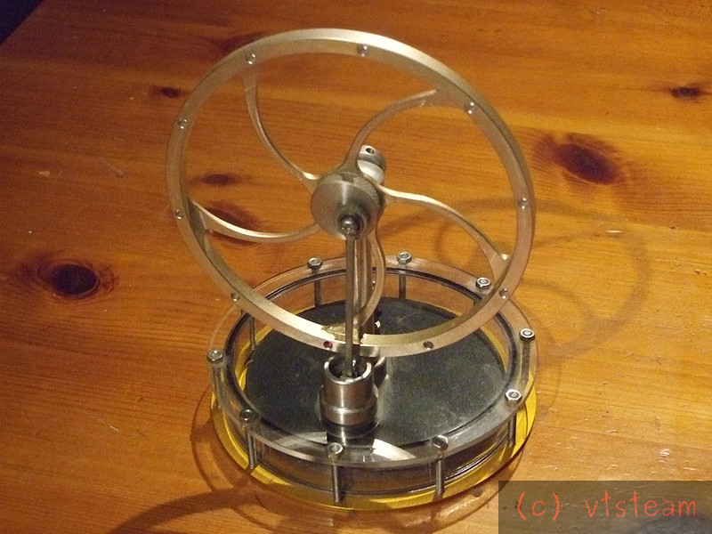

The LTD? I'm a bit disappointed, no-one thinks it is worth a comment.......  :scratch:
I guess, everyone has moved on. There's little interest in engines, on here anymore.......  :(

I love engines David -- just hadn't seen that one, because I often don't watch YouTube links -- they're blocked for me (I just see a black square in the post), unless I specifically enable them for some reason. Sorry to others also, who only post videos, and not pix -- I rarely read those threads, unless what your video is about is explained and there are photos in the post -- just me..... I'm a reader more than a viewer.
Anyhoo, love the little engine David, and the LTD, well what can I say, but obviously I like that one, since I've owned the same one for several years! Here's mine:
BTW when I first got it I did an experiment with it, I made a new displacer from white ScotchGuard and it worked quite well with a porous displacer -- as a regenerator.
Anyway, the more engines the merrier as far as I'm concerned!

I have to agree. The two engines, do show a close family resemblance.....
But. Based on Eric's enthusiastic reaction.
 I assumed, he was referring to this posting....... https://madmodder.net/index.php/topic,12389.0.html

That one is beautiful too... But I was talking about the one in this post.
