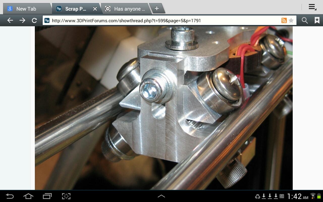

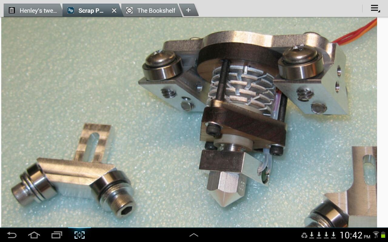

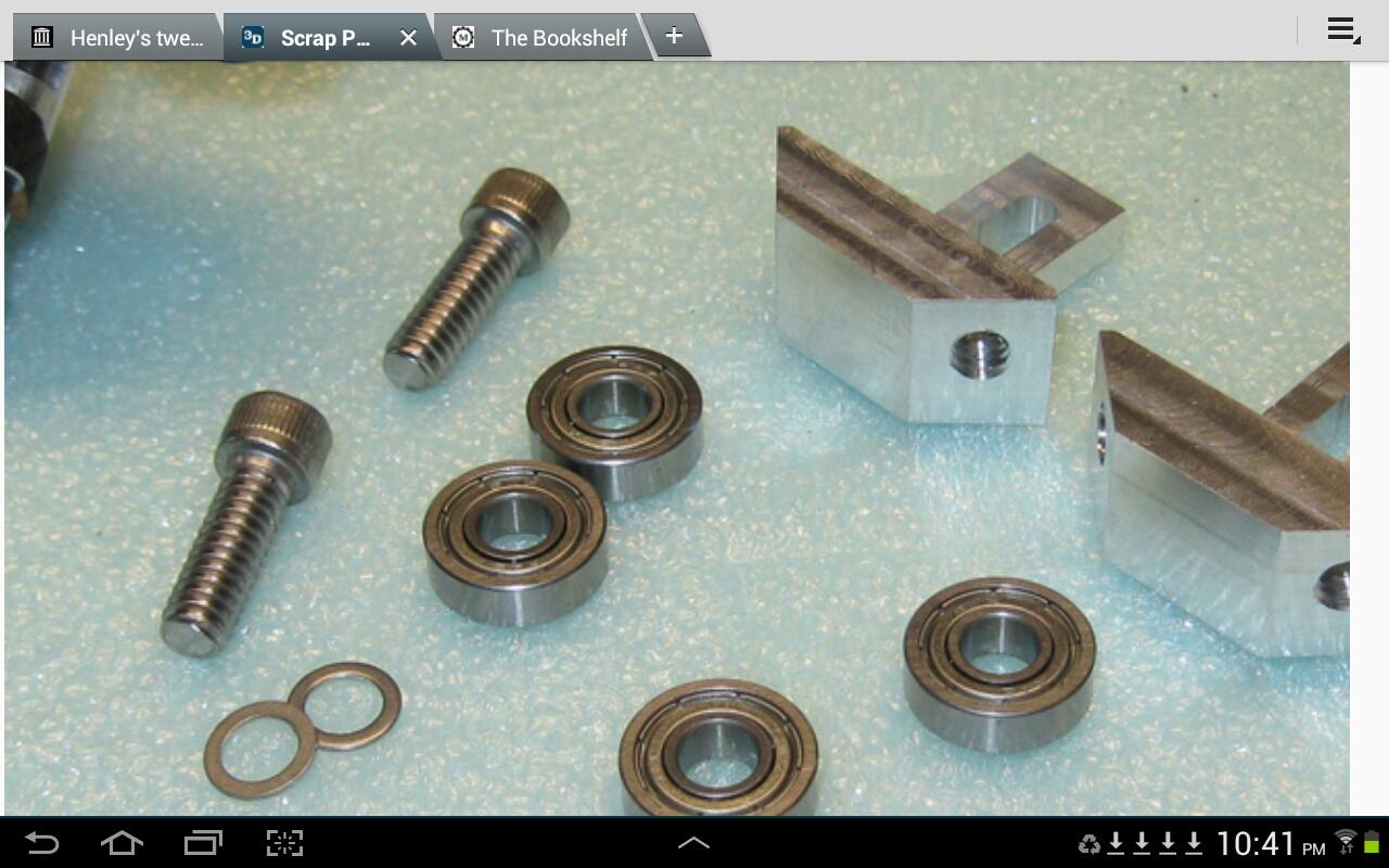

  • Posts: 1284
Re: 3D printer build log
« Reply #12 on: May 08, 2017, 04:03:37 PM »
Here's a idea I thought was good

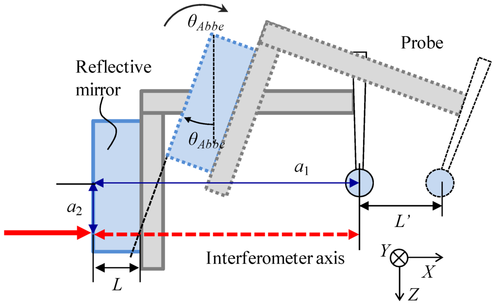

« Reply #14 on: May 09, 2017, 05:38:48 AM »
In my experience (albeit limited), super rigidity isn't particularly necessary for a FDM printer. Vibration and resonance control are far more important and having a rigid all metal frame doesn't automatically eliminate this. In fact it might even make it more difficult to manage. I suspect (but can't prove) that having dis-similar materials in the frame might help break up resonance and might actually be advantageous. The forces and loads on a 3D printer are not really going to stress the frame and joints unless it is really poorly designed and / or put together. ...
I have no doubt that this observation is true to some extent, but I think that it's pretty much the same thing. Bit like flipside of the coin. Good question here is what is good enough and where the error budget goes.
There are some little hobby projects I am working and then there are some pretty big machines we build at the work, they have linear rails from 100 mm to 10 metres and nominal sizes of linear rails from 25 to 65 mm and up. Some "axis" are electrohydraulic, some electronic servo system. I may have learnt a thing or two from them.
All (steel) frames are flexible, increasing pipe/beam diameter makes structures stiffer and you can make servo loops faster compared to increasing the beam skin thickness.
Filling structures with concrete without much attention to some very exotic details is a bad idea. Immovable structures filled with various substances can have very good damping, but it all really "depends" on scale. Sometimes for unseen high frequency dampening internal stringer/plate might do the job, or carefully placed heavy weight highloss mat might do - for some violent shaking (that is not only very obvious to see but it's so hard that rattles your teeth off) might be dampened by loose glass spheres or granules of metal. Sometimes it just best to kill the excitation if you can.
Some stuff you really need FEA and accelerometers/impact hammer and megabucks equipment/software.
BUT some stuff is pretty easy and straight forward. Like putting rails/actuator on same plane and CG of the moving part as close to this plane as possible. And avoid at all cost forces/gravity to change loading direction. Few years ago I could not spell "Abbe error", now I have a rough idea what it is and recognize it....basically it is when angular error manifestes itself in linear (unwanted) motion or error:
http://www.mdpi.com/applsci/applsci-06-00156/article_deploy/html/images/applsci-06-00156-g012-1024.png
That I see in very many designs.
What I'm trying to say here that I definitely see merit here in this design. X/Y axis are very close to each others, which is good. What might be worth of having a look is that when X/Y axis shakes this structure, it will move in relation of the table...worst case scenario is that X/Y axis will excite table and table might move random direction, more than doubling the error. If that comes to play, making frame uprights more rigid, or dampening the coupling into table OR alternatively making coupling into the table more rigid should overcome it. Anyways I think that top of that machine shaking is easier to fix than Abbe error inherent to many design.

Thanks for that info Pekka, That's the error (abbe) I'm trying to avoid. If I'm understanding it correctly, I did have this error on my mill for a while, the head was trammed to the table fine, when I used a short spotting drill to start a hole and then raised the head up to fit the much longer drill bit in I found the tip of the drill-bit was slightly off from the spotted hole, despite the head reading ok when I trammed it!! (I ended up having to tear the head down completely to shim the castings to get everything correctly set up)
