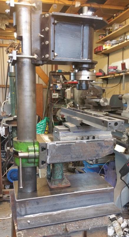

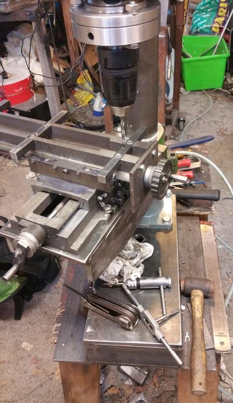

Made the base while at work today and fitted the column to it tonight. I could do with a decent square as it seems a tad off but I cant be sure my set square is accurate, however there is one major problem with the 76x38 when its tight it is spreading around the bed at the bottom but not at the top so the head is being taken off square so I either need to use something better or weld something in to stop the bottom spreading.
In pic 3 I show the table in about the position it will be on the knee and the hole in the base is where I am planning to put the lifting screw for the Z axis, I would welcome opinions on wether I should move that forward nearer to the center of the travel? my first thoughts where that the screw should be reasonably close to the column to ensure the knee would move smoothly but I am not too sure now.

« Reply #78 on: May 03, 2017, 03:18:40 PM »
 :ddb: I am happy now because I put the knee on and did some clocking, with a tool in the collet and everything tightened up I got .07mm twisting it from side to side not sure how that compares to other small millers but it seems pretty good to me and it should improve once I get the origional head casting sorted rather than the bit of channel the best bit though was from the knee to the column and putting weight on the knee I got .01 if you want to be picky .02 but that was a lot of pressure.
Sorry Vtsteam but it seems my gut feeling on the position of the lift screw was correct I thought I would test with a jack and on center it locks up on the column I could move it forward a little but since I have already drilled the hole I will stick with that.

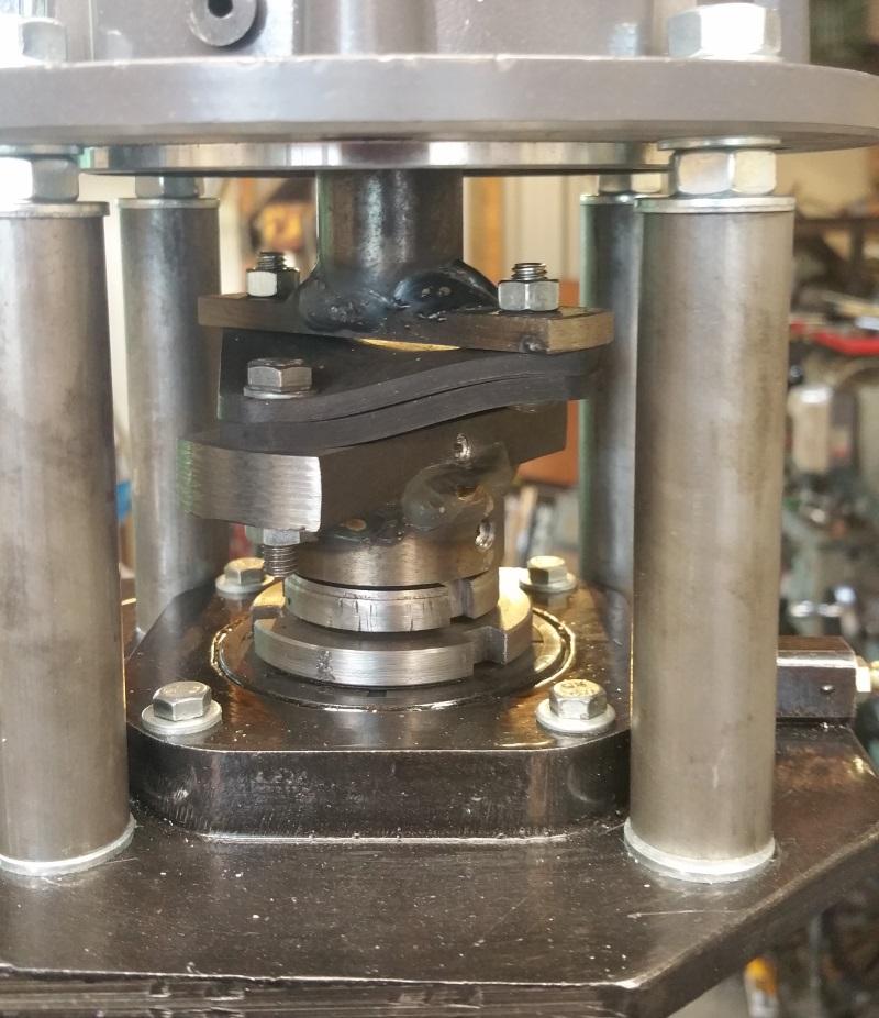

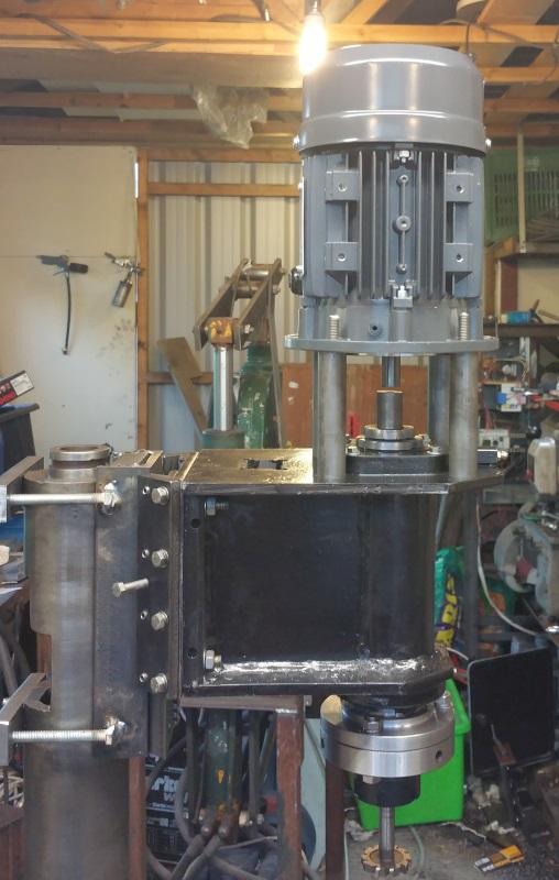

Re: Another homemade milling machine
« Reply #80 on: May 04, 2017, 05:31:27 PM »
This is where the motor will sit just need a coupler.

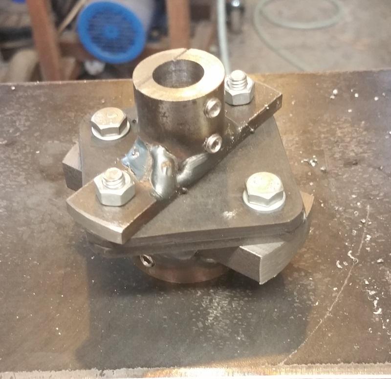

« Reply #81 on: May 06, 2017, 03:45:51 PM »
Made the coupling and fitted it but needed to have a bit more height even had it running so I am a happy almost mill owner  :ddb:

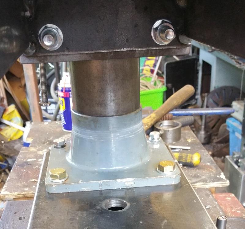

« Reply #92 on: May 10, 2017, 05:10:56 PM »
I have all the supports in place but while using the machine I found it impossible to find the right place for the lifting screw (well jack at the moment) too far forward and it lifts the front and locks up on the column on the way up too far back and it locks up on the way down there is a sweet spot but obviously this changes when you move the Y axis.
So during a repetative drilling job at work I started to think about it and looked at the column on the drill which has a big lump of cast iron hanging from a round column much like the mill and the lifting mechanism is part of the casting so I am going to see if putting the screw back in the place that Drummond intended it to be will solve the problem.
I need to slightly redesign the bottom a little as the hole that the screw will need to go through is being used to secure the column. With this in mind I dug out a bearing housing which will make a support for the bottom of the column.

« Reply #94 on: May 12, 2017, 04:24:32 AM »
Yes if moving screw to inside doesn't help I can machine the Drummond tail stock to bolt it onto the knee which will add just short of 2 inches and if I put it at the top it won't effect travel.

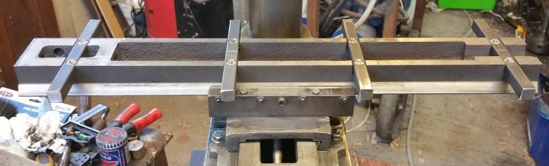

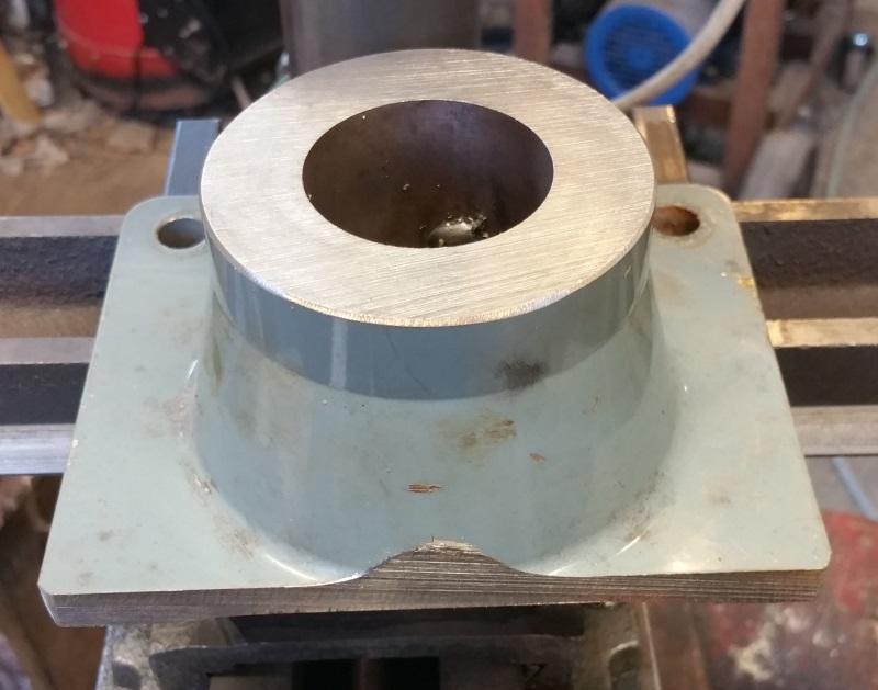

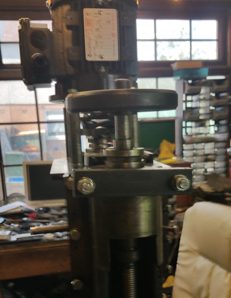

« Reply #95 on: May 14, 2017, 04:34:05 PM »
Busy weekend not just with the mill but found time to get some things sorted I bored out the old bearing housing and added it as support for the bottom of the column also opened out the origional holes and tapped them to M10 so it should be secure enough. I have the handle for the screw located at the top for now which will be a pain in the backside to use but one of the first jobs once table is finished will be to make a couple of bevel gears with a 2.5:1 ratio to match the M20 screw. I am pleased to say however that it seems to work well with the screw inside the column sorry pic is a bit dark.
On the subject of the table I got a temporary end plate made so I can use it to start milling the bits for the table and in the meantime I need to find a local tin basher to make a tray.

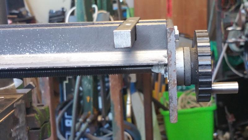

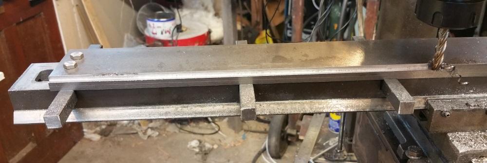

« Reply #98 on: May 17, 2017, 03:29:28 PM »

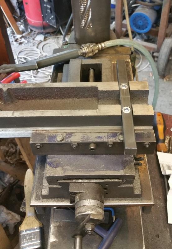

Have two of the three parts for the bed milled now, it did show up a problem for me to fix under the bed casting the nut is trapped and was held in place with a m4 grub screw which turned out not to be man enough for the job so it was replaced with two m6 grub screws one to hold and another to lock. I suspect that the X/Y table will not last too long guess I better put a axminster or similar one on my Christmas list.

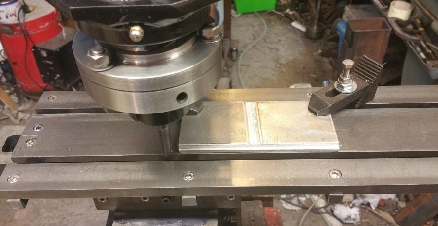

« Reply #99 on: May 19, 2017, 03:20:05 PM »
Table is together and hopefully tray is in hand very soon. Replaced the gib screws on the X axis from 4mm to 5mm and put a bit of scrap aluminium on it to test the squareness of the X to Y and I think it is slightly out but not too much that I cant fix when it becomes a problem.
