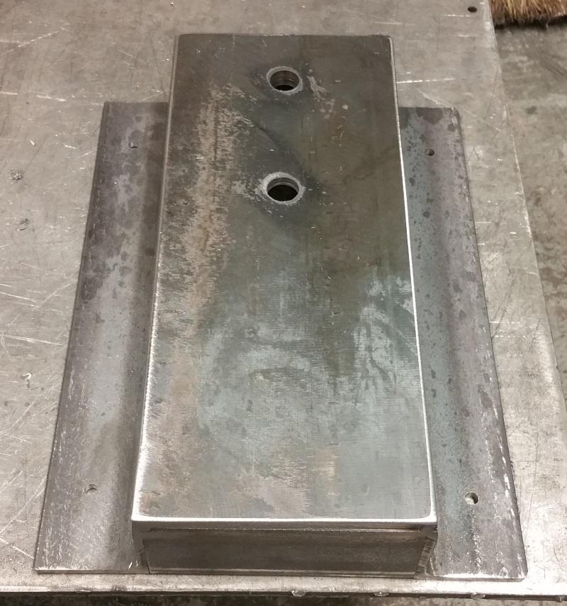

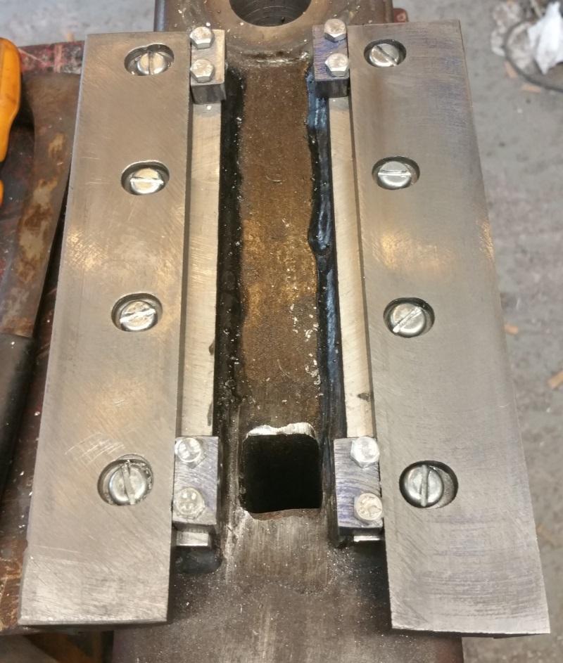

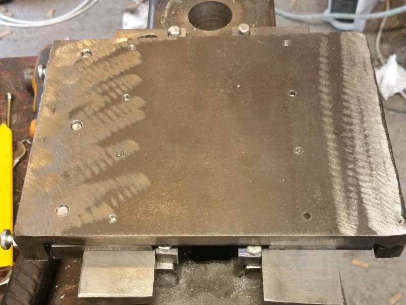

So I have now turned my attention to the knee slides and in yet another operation that would have been done better with a mill I made 4 elongated slots in each and made some blocks to help me get them lined up straight and keep them there. I have decided that I will get one side lined up as best as I can to the column and pin it, then everything will be lined up to that.

The knee is going to have to go back to the drawing board (what theres a drawing board?) at the very least temporarily as the bits are nowhere near straight I suspect its down to the rubbish jig I made to mill them on the lathe. So I am thinking of borrowing ideas from the gingery lathe and make the ways and carriage from some bright drawn stock which will hopefully get me running the mill well enough to straighten up the cast iron bits. Finger crossed.
Nearly had a major oops moment tonight while try to move the carriage along I pushed a little too hard and dropped it amazing how fast you move when your feet are in danger  :lol: that will teach me to secure it before messing.

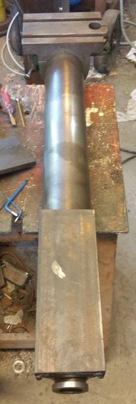

This project is going to take a little detour now in terms of the column, up until I got my Harrison I was using a past its best Drummond round bed with a broken head casting, this has been stuck under the bench slowly getting covered in various bit and pieces.
While sat in shed talking to my mate about the problems with the knee slide and how I was going to have to get something rigged up to sort them out properly it suddenly came to mind.
So I dragged it out and we sat there some more making plans and it is going to be used for the time being, this way I will have a milling machine hopefully capable of allowing me to make the origional design much better.

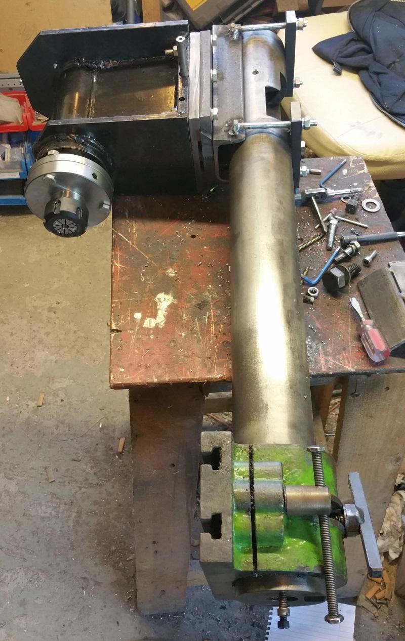

It almost feels like I should be showing this on a new thread but I guess I can get away with it.

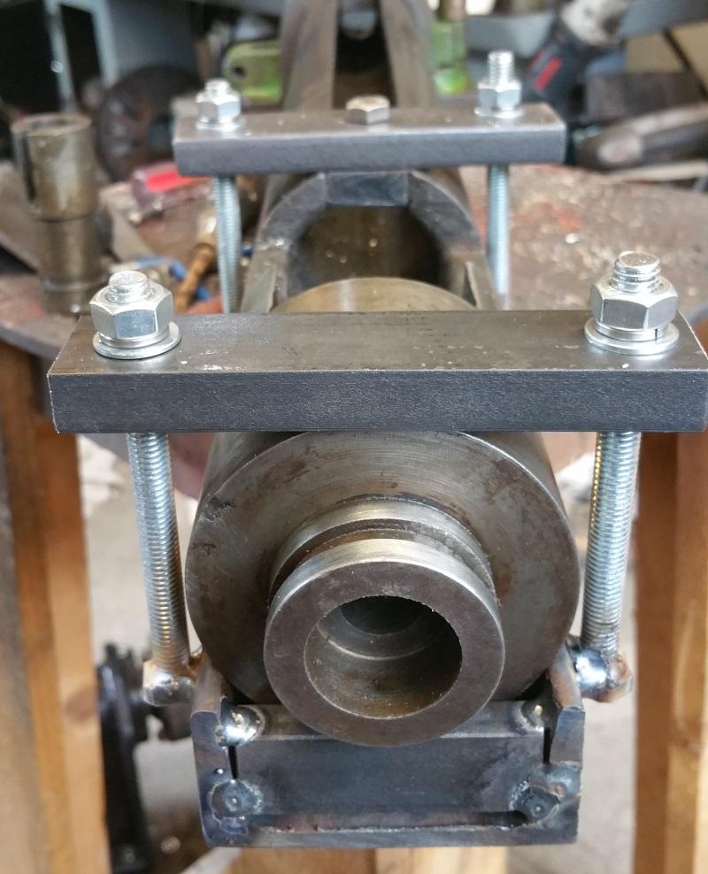

So a bit of 76X38 channel is a good size to sit across the round bed from the Drummond, the main thing about this detour is to not damage the Drummond bed as I have other plans for it. I welded four bolts to the sides of the channel and cut some bit to clamp the channel, on the bottom clamp is a piece which will make sure the bed will not break under stress and also ensure the head will not move.
Next I bolted the head slide onto the 76X38 channel (which I didnt take a pic of) and fitted the head so as you can see I am still going to have both the head and the knee moveable.

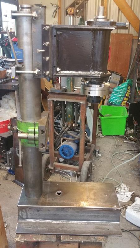

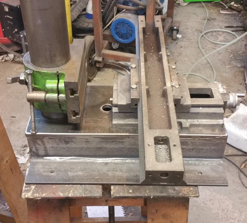

Made the base while at work today and fitted the column to it tonight. I could do with a decent square as it seems a tad off but I cant be sure my set square is accurate, however there is one major problem with the 76x38 when its tight it is spreading around the bed at the bottom but not at the top so the head is being taken off square so I either need to use something better or weld something in to stop the bottom spreading.
In pic 3 I show the table in about the position it will be on the knee and the hole in the base is where I am planning to put the lifting screw for the Z axis, I would welcome opinions on wether I should move that forward nearer to the center of the travel? my first thoughts where that the screw should be reasonably close to the column to ensure the knee would move smoothly but I am not too sure now.

I'd vote for the center of the X and Y travels on their slide ways should be under the axis of the head spindle. And the Z screw also under that point.

With regard to the channel guide on the head, maybe I might try adding two small plates welded to form a Vee inside the channel legs, so the pillar now slides against that Vee. Each plate would weld to a leg, and to the channel center line, inside.

The center of the X and Y will be under the spindle axis to maximise the cutting area. Looking at most of the milling machines on a Google image search shows me manufacturers don't seem to have any rules regarding the position of the lift screw. However my machine is no where near the weights they are dealing with so under the spindle axis seems reasonable to me too. As for the head I think I am going to trap a block between the column and the channel for now and sort it out properly later. Now it is annoying me as the plan for the Drummond bed was to one day make it into a decent and saleable lathe again but I am liking the way this is going so much that it's unlikely I will change it now. So sorry to anyone who was following me while I wasted time up to now.
