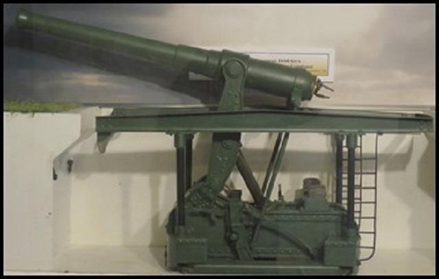

« Reply #2 on: March 20, 2017, 03:28:19 AM »
Sparky, that mechanism reminds me very strongly of the 'Moncrieff' disappearing gun mount - Google it !

« Reply #6 on: March 20, 2017, 02:04:18 PM »
The disapearing guns were used at Fort Rod Hill in Victoria BC sadly they didn't save any but you can see the implacements while there.
