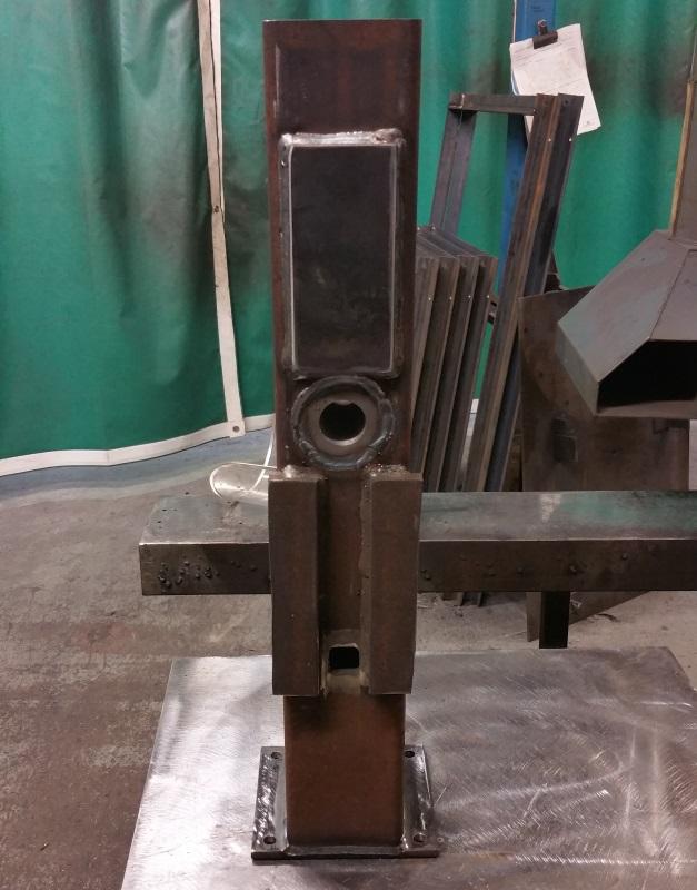

I am in the process  (among all the other stuff) of building a milling machine. I am currently working on the mast of it and can't decide if I should add a bit of tube which would give me the chance to add horizontal capabilities in the future. Just how useful is horizontal? Does it allow you to do much that you can't with vertical?

So there are advantages in which case that solves my dilemma I will put the necessary bits in for future use

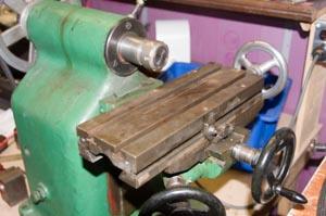

I have (only) a horizontal milling machine. I have nothing to compare it to except the milling slide on my ex-Taig lathe :-)
It seems sturdy, the only issue I have is seeing clearly how to line up for hole drilling etc. A small mirror and good lighting helps.
No idea what brand this is, but price was right. I too missed an Atlas mill on Kijiji last year for CA$500. Then this came along at CA$200 and now a happy camper.
DRO's are on the way which completes what I need for now.

I had pretty much already convinced myself to include the capability but wasnt sure I would ever use it but it seems there is good reasons to include it so I brought the neccesary home to turn on my lathe. I wont do anything more about it just yet however as I have more than enough to be going on with as it is but it would have been much harder to do later as I am thinking of filling the upright with concrete.

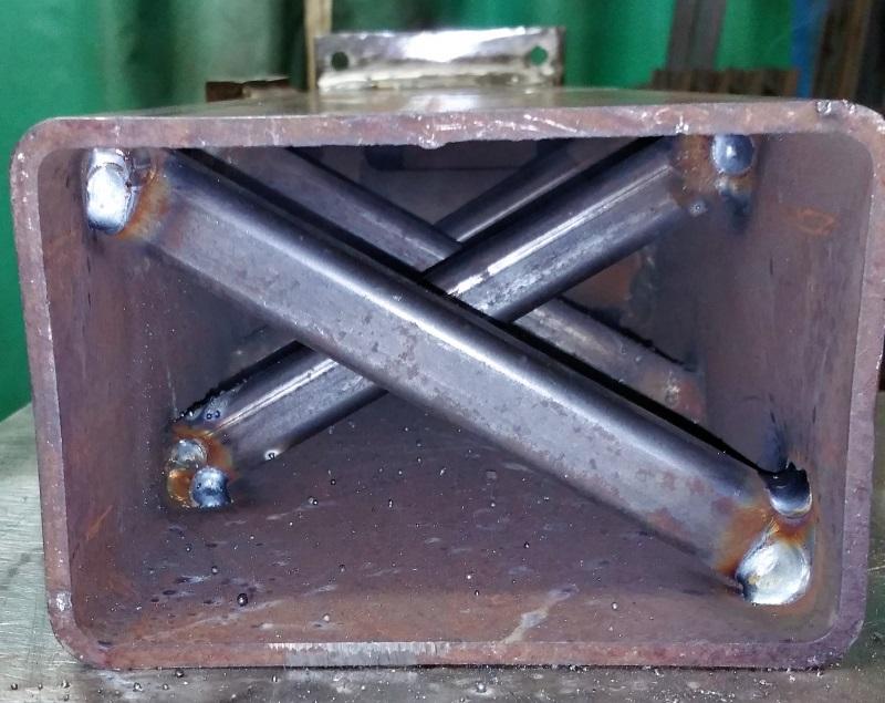

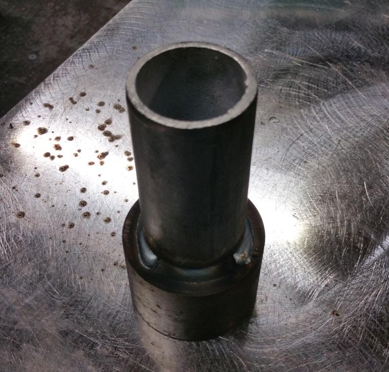

« Reply #11 on: March 10, 2017, 11:55:48 AM »
As a little teaser for the thread heres a few pics of what i have done so far: first pic is the part to allow the horizontal shaft to be mounted then the upright of the mill and finally the bars inside to hopefully stop any twisting during operation I am hoping this will be enough without filling it with concrete too but will see.
