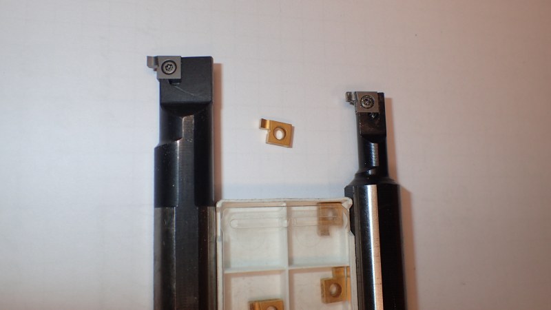

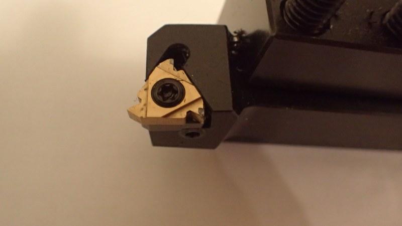

I have got outside threading tool + insert from RDG, not happy with insert. I have some better external/internal threading tools, but I don't know which inserts to buy.
I would like to stick 16ER and 16NR inserts, because there is pretty good selection for different thread profiles. But which brand and where? Big tamale would be selection of full profile metric threading inserts.

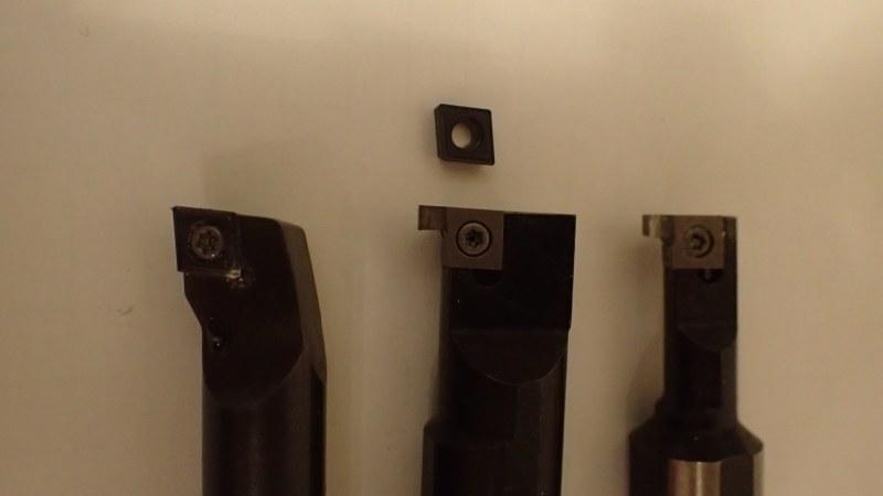

Annother thing is groovin inserts, specially internal grooving. This far I have used very happily Mesa tools stuff, but when I need precise width I need to grind the insert.
I have been considering MGMN inserts and bars for them, but three internal/external tool + inserts will add up in price and still I would be grinding the inserts.
I have three or four nearly unused SECO:n internal grooving bars, but only one isert for each. Can't find tha inserts for them. 16 mm internal groving bar has a ID of SNP0016M9 and the bit looks much like a CCMT09 insert, but it is more square and has a projection sticking out of it. The insert is nice to sharpen and modify. Just can't find them.
Very temped to go back to HSS, but they don't hold as well as inserts.
Suggestions?

I use the same inserts and get them from Shop APT in Edinburgh. Not the cheapest around but I have no complaints.

I have the same incerts from RDG and recenty cut a 8 tpi thread to a sholder , and the bump behind the the cutting edge cut the last thread when I droped the half nutts , and then had to wipp the slide out at the same time as the the half nutts , I will be grinding that off before using it next time , there is on line catalogs to help find incerts for your holders .

This SECO appeals ti me because I have two different size internal grooving bars and that insert model is nice on that account that single holder can handle inser widths from 1-3 mm (nearly). Internal retaining ring width is 1,0 mm from 12 - 23 mm hole nominal sizes and then 1,2 mm wide from 25 mm and up. Therefore two holders and two inserts would cater my needs pretty well. Inserts are bit more wide.
I'll check eBay if I can find the two smallest sizes and maybe two widest and then I would be pretty much set for intenal grooving. If I can't find inserts, I'll need to buy smallest MGMN insetrs and bar type you posted.
Threading a separate issue, I'll try different brand insers (partial profile as sugested) and see if it does the trick.

After few hours of googling, ebay, amazon etc. I managed to buy one pack of widest grooving inserts for this Seco bar...noticed that NA favors imperial designations and most of the times shipping is a killer....but found SECO Inserts (10 inserts) 9NR 103FG CP30...which means just the right one, but unfortunately they are coated, I prefer to grind noncoated.
Still trying to find few of the thinnest standard sizes, they actually might show up on reasonable price.

Got some Seco inserts for my internal grooving shanks. They work and did no cost arm an leg. They travelled back from Canada! :)
