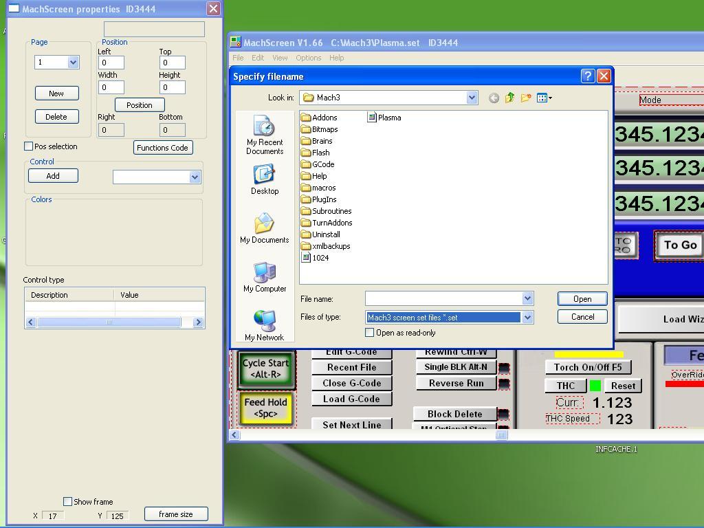

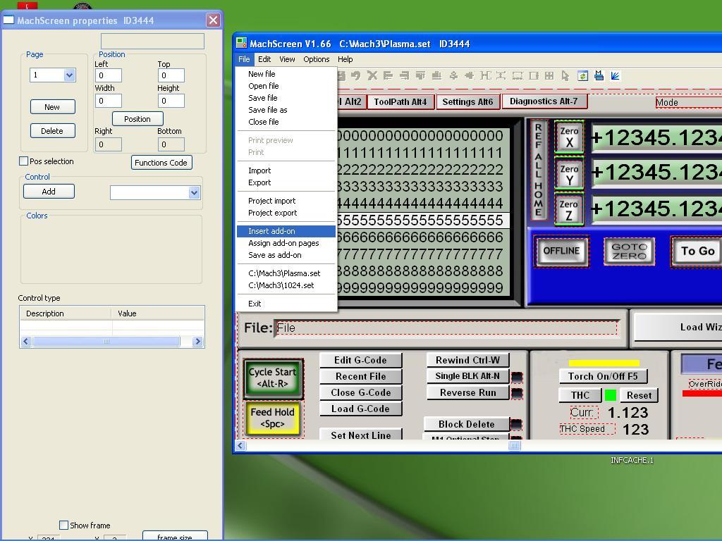

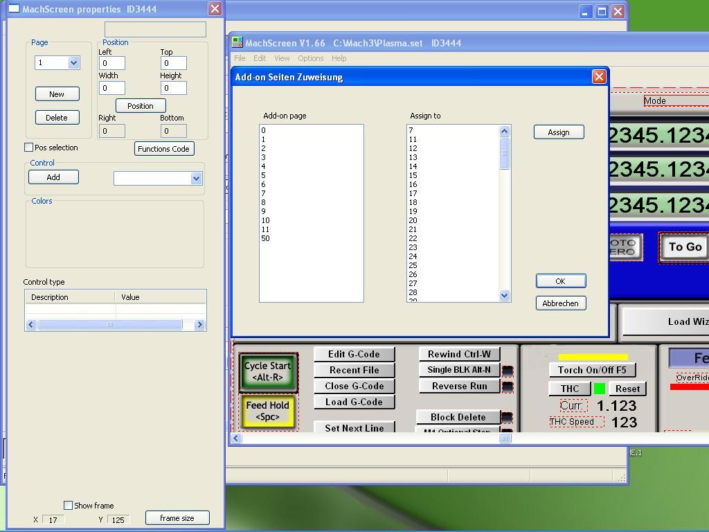

Use the screen editor to find out which page number you want from the a Mach screenset.  Then close the file for that set.
Open the Plasma screenset, choose File -> Insert Add-on (Screens1), set file type to .set (Screens2) so that the Mach3 screen sets show - select the set you wish to copy the page from.  Then (screens3) choose the page number that you want to copy, and a spare page number to assign it to in the Plasma set.
Having done that you may well have to add a button (best on page0 show it shows in all screens ?) to open the new page.  Open screen.page is  standard button function.
Hope that helps.

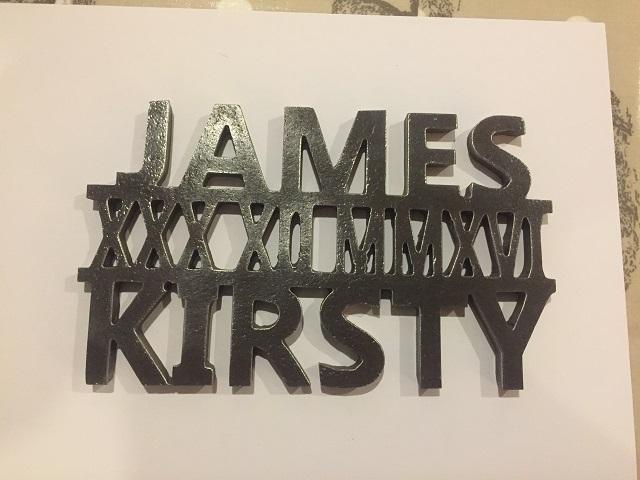

To prove it was all working after the re-wire I cut a little memento out of 3/8" plate  for my Son and Daughter in law to remind them of their recent wedding - another thing to gather dust  :lol:

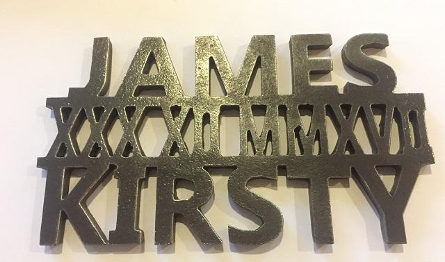

« Reply #11 on: February 22, 2017, 11:44:04 AM »
Can anyone spot the (not deliberate) mistake on that memento ?
 :bang: :bang: :bang: :bang: :bang:

« Reply #13 on: February 22, 2017, 12:13:05 PM »
Is this their future recent wedding you're referring to Andrew  :)
Re: Calling MACH 3 experts
« Reply #14 on: February 22, 2017, 12:39:00 PM »
That's the one !
Error corrected - drawn in Inkscape I'd only saved it as an image and not the original text, so to remove the excess "I" I had to place a white box over it  :bang:
Still it's all a learning exercise  :ddb:
The other one will do for their first wedding  anniversary  :lol: :lol: :lol:
« Reply #15 on: February 22, 2017, 12:41:21 PM »
Just bandsaw the rightmost half-inch (or whatever) off it!
« Reply #16 on: February 22, 2017, 12:49:22 PM »
That WAS my first thought when I realised what I'd written Dave - but  not quite following through on the learning thing - so it got a technical solution  :lol:
