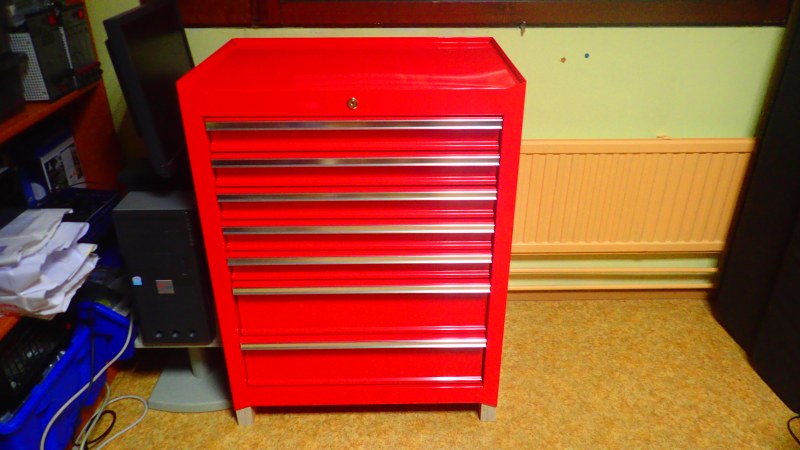

I was designing a surface plate stand around a tool cart (to have all dial gauges etc. convinietly at hand). When I got the tool box home, cleared the room and moved stuff around I found the place the tool cart, but it would make very bad place for the surface plate....too close to window and radiator.

Planning to see how much space is there and buy a small tool chest with drawers to fit inside of the frame, but that is not that critical.

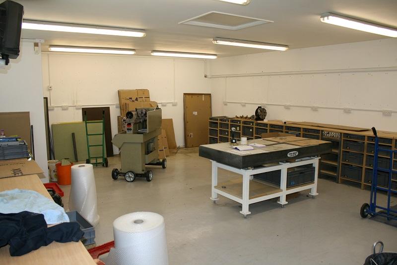

The surface plates on all the cmms at work have five feet on which the plate rests. There are two extra either side of the single adjuster to ensure the plate cannot tip should some pillock sit on it (even though the smallest plate weighs 200kg and the big ones several tonnes) .
That sounds like a good idea. I've always thought the end with one support was a bit precarious, if not dangerous. Is it safe to assume these two extra ones are adjusted with a small gap and not normally touching?

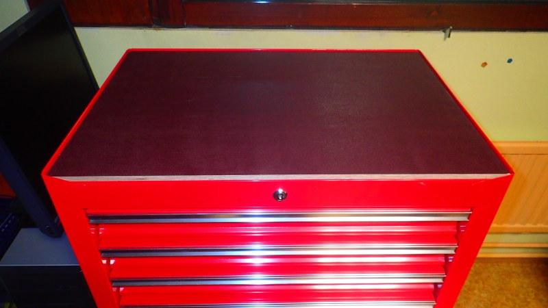

I put some "sleeppers" under the tool cart and filled the drawers with measuremet istruments. The original castors and rubber mats stink big time. No way I will put antything that toxsic stench inside. But the tool box is perfect size, many drawers and trawers are veny nice size. Some cheap ones have very shallow drawers to limit weight you put there and then one or two way too big to cut the cost down.
I'm thinkking of putting a wood top on this tool chest and putting there one cast iron 400*400 mm surface plate and leave some space there.

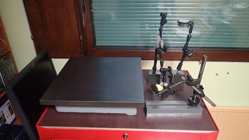

Got sidetracked with the tool chest, filled it with metrology stuff (except the ones that will be in garage).
Could not find near correct size table top material, bought some wiremesh plywood and cut it to size. I'm using it only as another table top.
Therefore I haven't started yet with the actual surface plate table. Bit stuc with three point adjustment. Fine thread would be very familiar, but I'm also considering 1:50 taper pin for fine adjustment.

My small granite surface is on 3 felt pads used for furniture.  It doesn't seem to matter the pads are soft as they compress under the weight of the surface and still provide 3 points raised from the surface below and will only tip a few mm if you get too much weight on the edge.  I guess cork pads would work just as well.
Another option would be to hot glue ball bearings in place and shim them if you need level.
