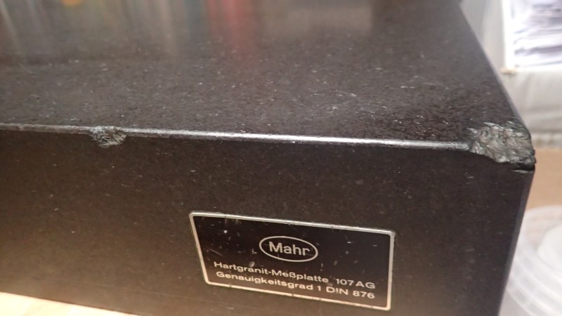

Unbelievable......
I have two surface plates, one is cheap chinese 200*400 mm and it is pretty accurate. I have faith in it, because it gives logical results.

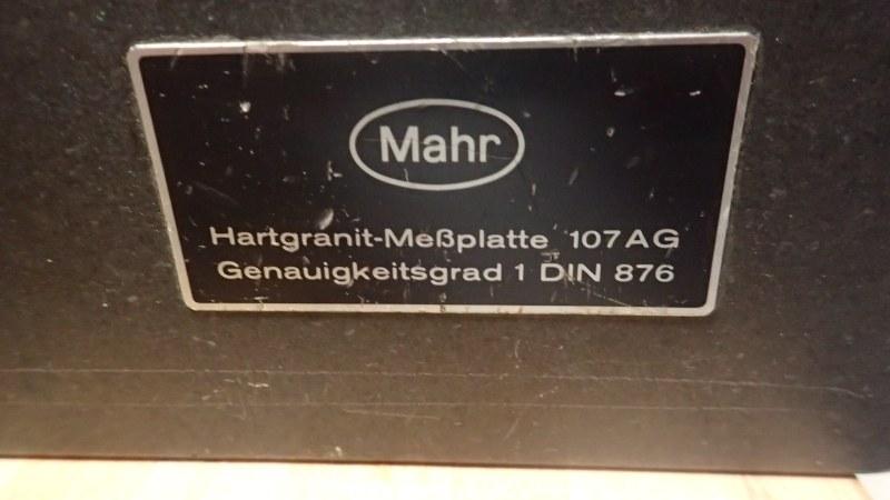

Then I got one almost free, just perfect size, 630x400x100 mm, brand name (MAHR), but it has edges chipped, dents all over, one end rough and what is worst, it is not very straight!
I used brayer and rolled pretty thin layer of blue and armed with SIX straight edges of varying pedigree from 400-1000 mm length.
Idea was to check all sides and diagonals. I did 8 lines and union flag patterns with one straight edge a time, cleaned the edge and leveled the blue on surface plate between each.
Looks like the surface plate has low front, worn on the middle and rough spot on one end.
Pretty annoying really, because that was supposed to be my reference to check all other instruments.
I am pretty sure that only way out of misery is to buy a new or checked surface plate. Nobody here seems to have heard of surface plate reconditioning for a private person. It's only 75 kg or such I could transport it easily at the back of my car some 200 km. But nooooo.
Now the question: Chinese or (east) european? is there price break point that defines most likely good vs. most likely bad?

ETA: Mahr is a reputable brand in metrology equipment,so the surface plate you have is likely worn.

Mahr is a top notch manufacturer so will be the best granite available and probably well worth reconditioning.

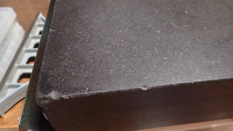

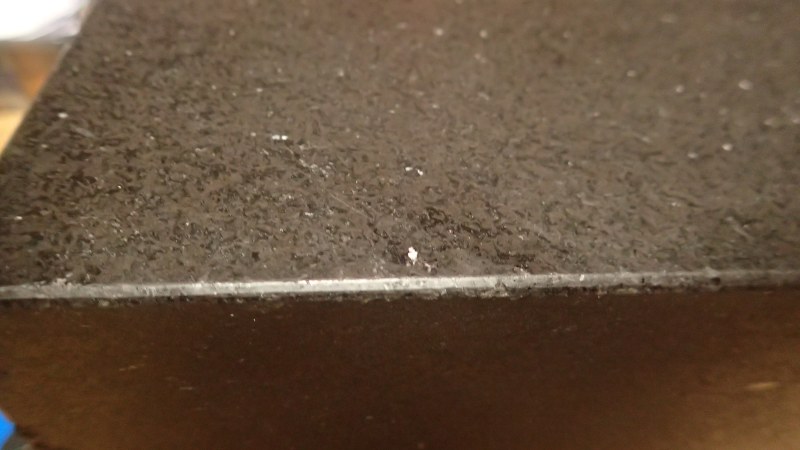

Some pictures of the hangar queen.....

Yup, you still have a paradox.  You're comparing multiple unknown surfaces to one another.  You have no idea when the straight edges are being printed whether the surface plate or the straight edge isn't flat.  Even if three of the straight edges printed perfectly in multiple positions on the plate, as unlikely as it is you could still theoretically have a spherically concave or convex surface.  Desirable for optics, not desirable for machining.  Try printing a concave to a convex and you won't see it.  Take 3 concave/convex in any combination and you will.
While the chunks out of the edges are nasty, you've still got a nice chunk of quality granite there.  Of course, I'm going on the assumption that Mahr wouldn't put their name on crap, but I have no evidence for that.  Even it it has some nicks, it still has potential to be a very nice plate with some work.
