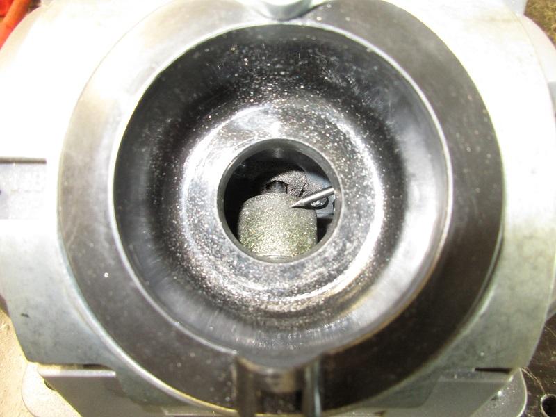

Recently I purchased a drill doctor as MSC had them on special offer and although  I can free hand sharpen drills but  have good and bad days  and find smaller sizes a bit of a pain.
Playing around with it I thought of the possibility of using it to sharpen Tungsten electrodes for tig welding

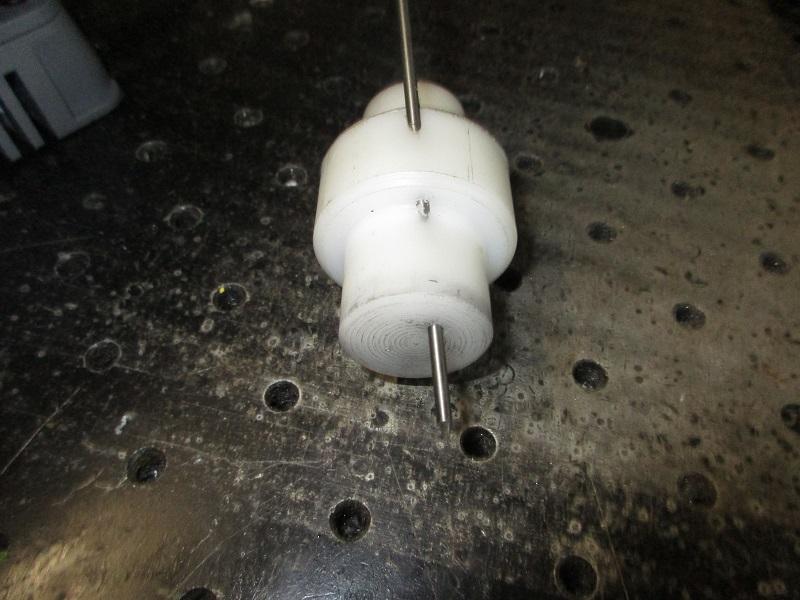

 So I made up a plastic adaptor to go into the position used for reliving the drill point

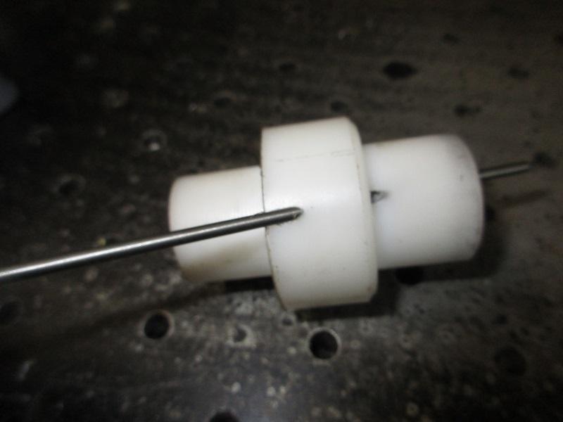

 I drilled a 2.4mm  hole through it at about 15 degrees offset to the centre line .

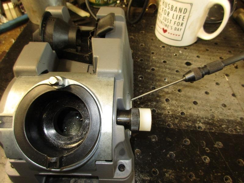

Inserted a 2.4 mm electrode  into the hole and set the plastic adaptor so the electrode would make contact with the diamond grinding wheel .
I made the adaptor so that it is a tight fit in the hole in the drill doctor .
Then turned the electrode with a pin chuck .
The result is very passable     Mike
