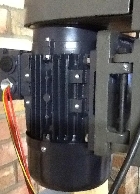

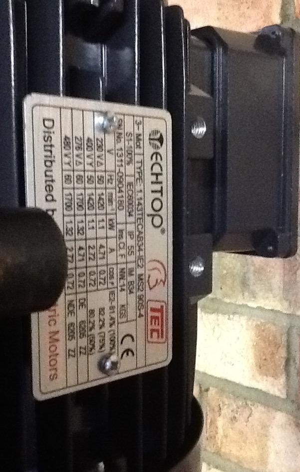

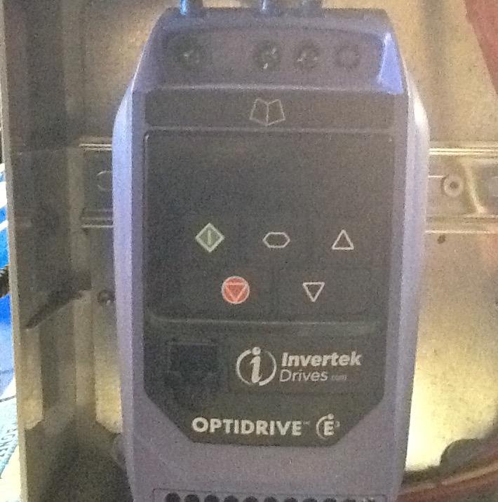

Moving swiftly along to the next in this series of millmodding,I'm doing a 3 phase conversion using an inverter.
Pictures of the motor and inverter are already in the riser block thread so I wont show them again.
So after removing the original motor, the new one is bolted in place. its a direct swap, both are frame 90 size, so I wouldnt expect any issues here.
The motor was prewired with its supply cables, all I have to do is run some flexy trunk from it to the inverter...
More to follow, meanwhile the obligatory picture ot two. :zap:

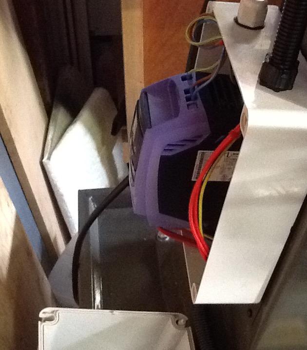

So,had a bit of a break from posting about this.....
Its all done, wired up, inverter programmed and away we go..
I mounted the inverter enclosure on the back of the mill, seemed to be the most logical place to put it..Out of harms way and close to supplies and motor.

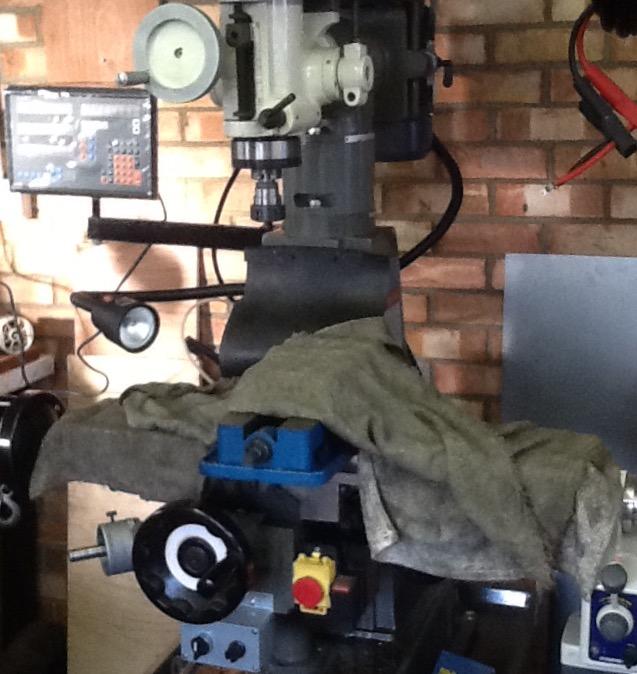

Now the most difficult part of this mod was deciding on where the controls were going to go :scratch:
I had already mounted them into a suitable box and after much agonising, I settled for just under the Y axis at the front on the knee....
  • Posts: 2540
Re: 626 mill motor/inverter mods
« Reply #3 on: December 14, 2016, 09:54:33 AM »
After trying out the controls and generally messing with the mill, I concluded that their location was justified.
I was going to try and combine the nvr switch with them but I could'tt get a box suitable to house the whole lot....Anyway it looks ok, just need a label now for the FWD-OFF-REV switch and speed pot..
See what you think?

Let me just clarify one thing here about my installation.......
I'm running a 1.1kw 3 phase motor via an Invertek 1.5kw inverter.
There is nothing between the output of the inverter and the motor, this is directly wired with 2.5mm2 tri-rated wire....run in conduit.
On the input side, I used the existing wiring that fed the run winding of the original motor. This supply goes via the nvr switch, as did the start wiring( subsequently removed..)
The nvr is interlocked with the chuck guard( although I'm not actually using it, the wiring has been removed) and the pulley cover atop of the machine.
Normal Stop-Start of the mill is taken care of via the Fwd-O-Rev switch that sits along side the speed control pot. These inputs are wired to the control terminals on the inverter.
In the event of a supply interruption, the machine power is cut, in the event of an emergency the power is also cut, this is the job of the nvr switch....it is hard wired and is not subject to the software of the programmable inverter, this is in line with standard industry practise...
So, there you have it...hopefully clear and simple....
