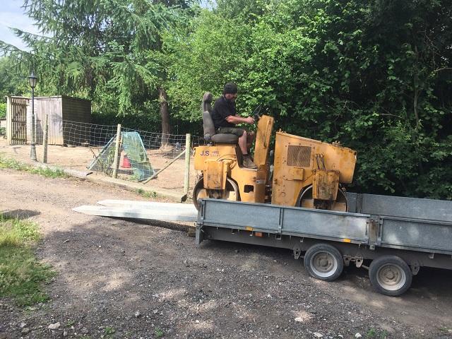

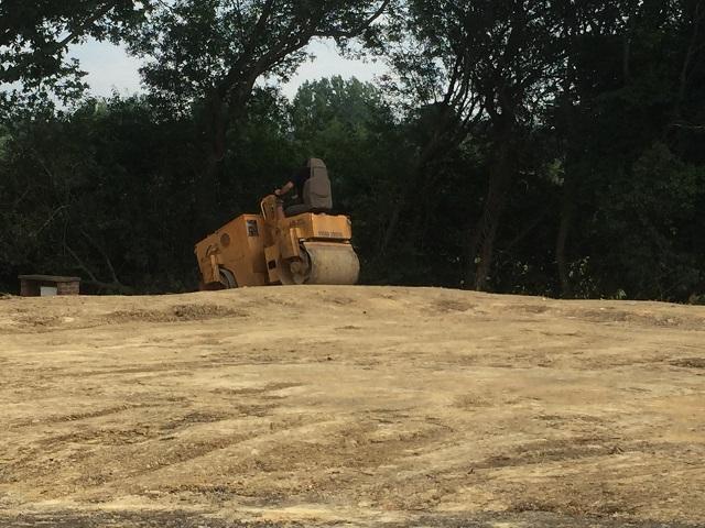

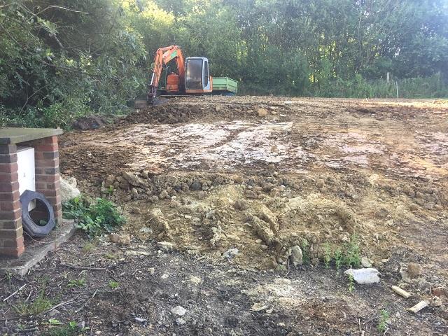

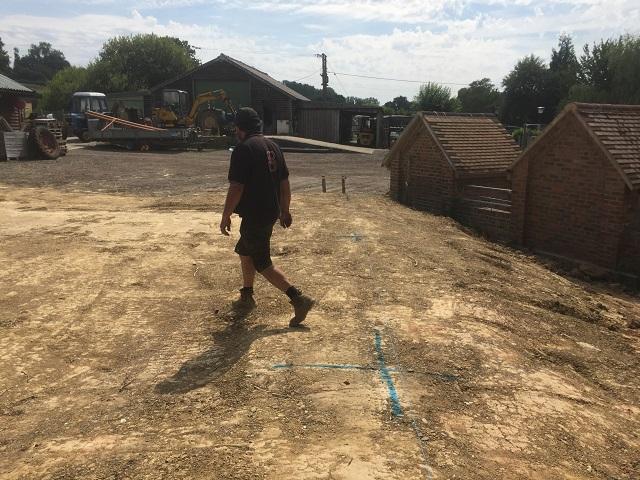

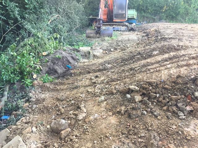

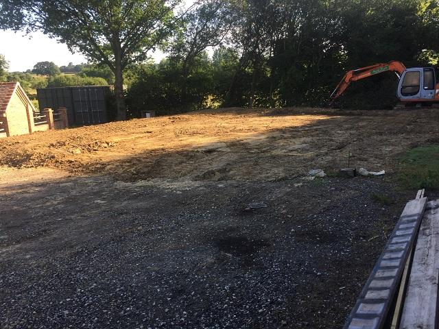

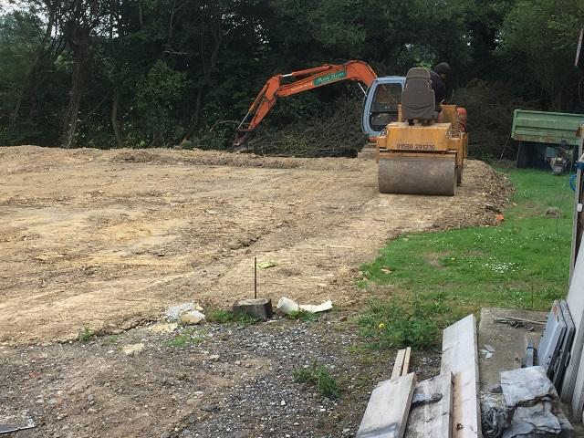

So yesterday afternoon Darren returned to spread load #13  and start forming the shape of the base. He sculpted the ramp that will be needed to gain access to the scrap of land behind the shed, battered all the edges and hollowed the centre of the site, building up and compacting the edges where the  pits will be sunk for the concrete pads for the steel work to sit on.
It's still slightly softer than we want, so later today he's bringing his twin vibrating roller to compact it some more before digging the pits.

Talking of mending, Darren wasn't able to come as planned as his vibrating twin roller ceased vibrating on one drum - internal drive shaft sheared off that joined the hydraulic motor and the eccentric weight. However a bit of fetling and he came today .

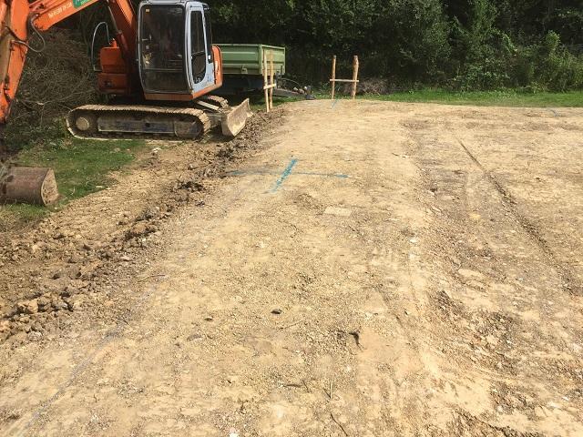

The idea is to compact the periphery where the pits will be sunk for the concrete pads, but actually he went over the whole thing, and it has certainly made a difference.

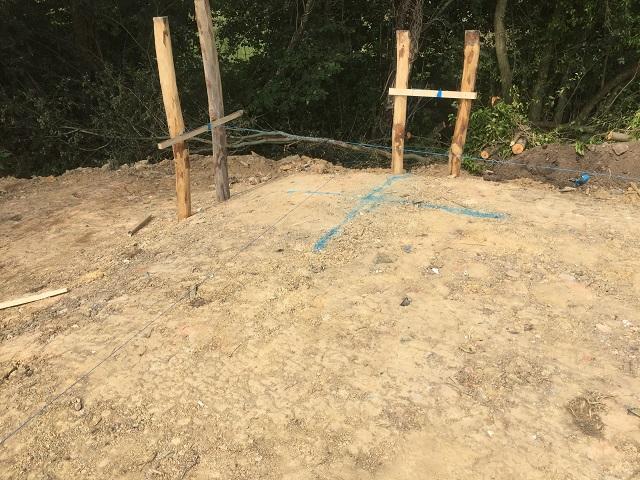

Then he went round putting up the 'profiles' to give the building outline in string lines, to mark the centre of each vertical beam. As there is the possibility of rain in the next day or so, and as the concrete is ordered  for noon on Tuesday, he's going to return on Monday and dig the pits then, so that they are not left open too long.
Concrete coming from a firm called Woolycrete, which is appropriate as we had an unexpected lamb born last night by one of the Jacobs Tegs who shouldn't be breeding until next year - so I suppose that Harold the Ram is going to be done for child molesting  :clap:

Andrew,
I'm curious about what class of deadweight roller you would need to give the same effect as the vibratory?
  • Posts: 9051
Re: New Tractor Shed
« Reply #134 on: July 06, 2017, 02:06:46 PM »
Well the deadweight of that roller is about 3 tonnes but I reckon you can treble or even quadruple that for a vibrating roller

A 3 tonne vibro roller will make ground easily firm enough to use as a road. Usual spec for a piling mat is roll every 300mm but that's gotta ho!d a 60 ton piling rig - and pass a plate test which is something you don't wanna fail coz you'll have to dig it all out and do it again.
I've also seen people pop a shutter by over-hunting a vibrating poker. It can build up a lot of pressure and lift the shutter up if it's not pinned down enough or simply burst it if it's not built sturdily enough.

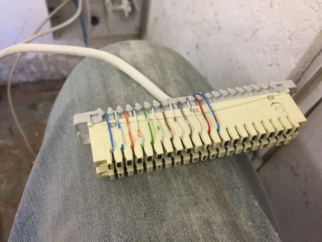

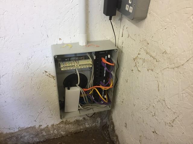

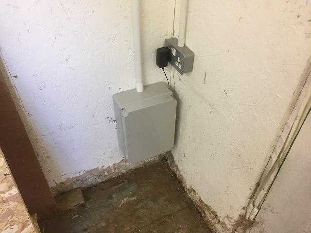

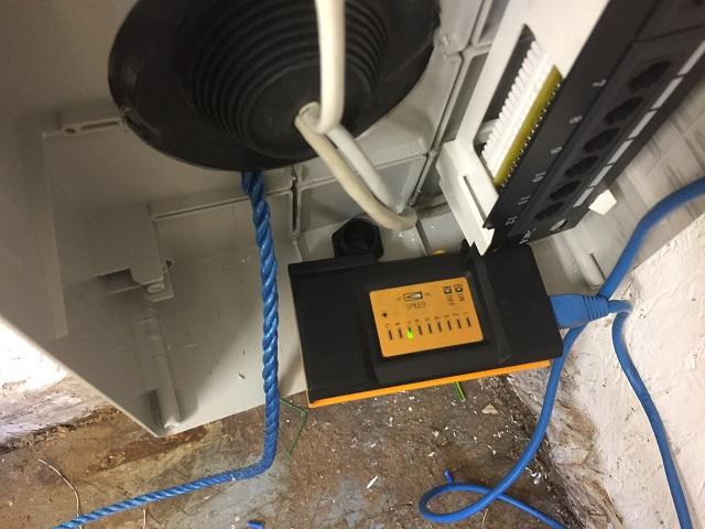

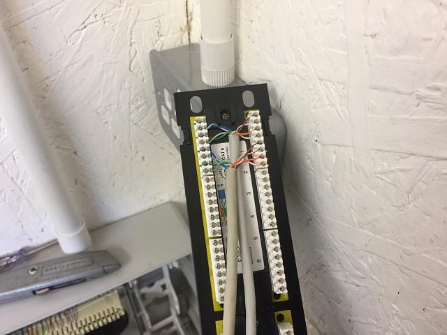

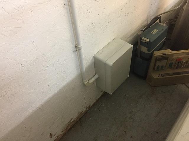

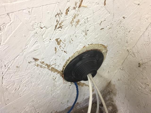

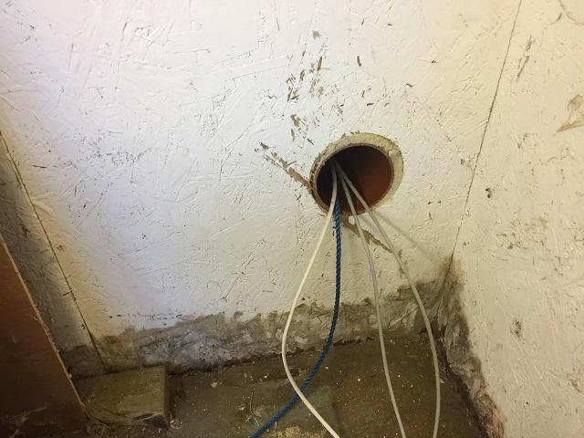

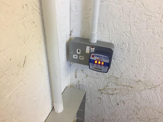

So as the structural bits are on hold until the concrete is poured hopefully on Tuesday, I thought that I had better get some of the infrastructure brought forward ready.

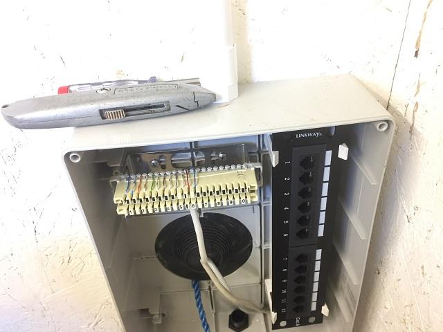

Between each of my buildings I have laid 110 mm underground drain pipes as ducting, and this has proved very useful over the years as bits have been added to telephone and Ethernet networks. My main workshop is connected to my Woodwork shop by such a duct, but it has never been used. As the Tractor Shed will derive it's services from the Woodwork Shop it was time to pull some cables through. Already it was connected to water and compressed air via 25 mm blue MDPE pipe, and had a heavyish 3 phase feed, all of which were laid in a separate trench when the building was built. But I want Ethernet in the Tractor Shed so that wired security cameras can be put up, and while I was at it I may as well pull a telephone cable through.
Each end of most of these inter-building ducts are terminated in a plastic box housing a Cat5 (or 6) Patch Panel and at least one Krone telephone connection block. Several have an adjacent ethernet hub to fan out to local connections.
So I pulled through a 6 pair telephone cable and two Cat 5e ethernet cables, leaving a pull through rope in the duct for next time.
While I was about it, I wired in an extra socket close to the termination cabinet, ready for the associated hub, which this time is so small it will fit in the cabinet itself - far neater.
« Last Edit: July 07, 2017, 01:25:43 PM by awemawson »

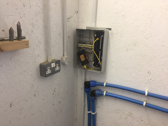

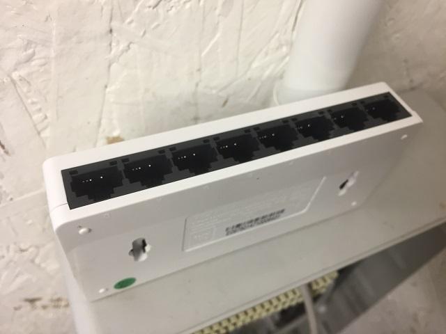

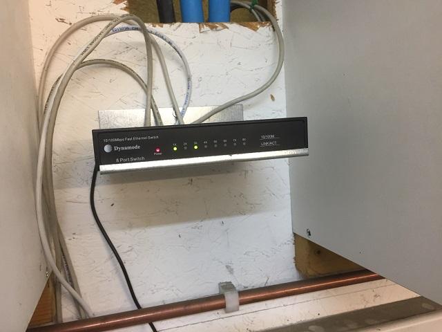

Then I wired up a double Ethernet socket placed close to where I want a camera pointing at the building works. The idea is that one of the two Cat5e cables coming from the main workshop will be patched through to the Tractor Shed, and the other feeds the Hub which services local needs like this camera.
Having run basic tests on the wiring using my handy two part cable tester I then crammed in the tiny hub and patched things ready for the camera.

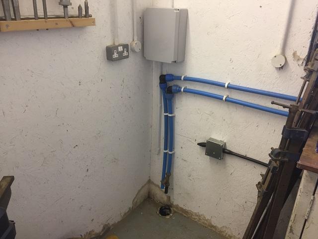

From the Woodwork Shop there is a 4" corrugated duct going under the rammed base for the Tractor Shed. This will be intercepted when the concrete pads have gone off, and brought up via large radius bends into the shed itself. This will take the full works (Water & Air in 25 mm MDPE, a 50 amp 3 phase feed, and 6 pair telephone cable and two Cat5E ethernet cables
So the next job is to prepare the cabinet to terminate the start of this duct in the workshop. Anything further will have to wait until the shed is up.

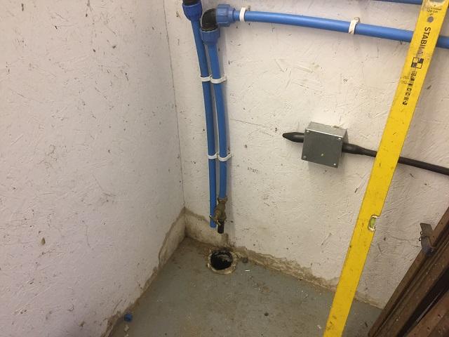

Today I finished the last link in the chain to get Telephones and Ethernet into the Tractor Shed, or at least close to a duct that will lead to it !
Just pulling cables into existing trunking, making up yet another termination box with a Telephone Krone block and a CAT5 Patch Panel, wiring them up and testing.
.... all I need now is to put a Tractor Shed on the end of that last duct  :lol:
