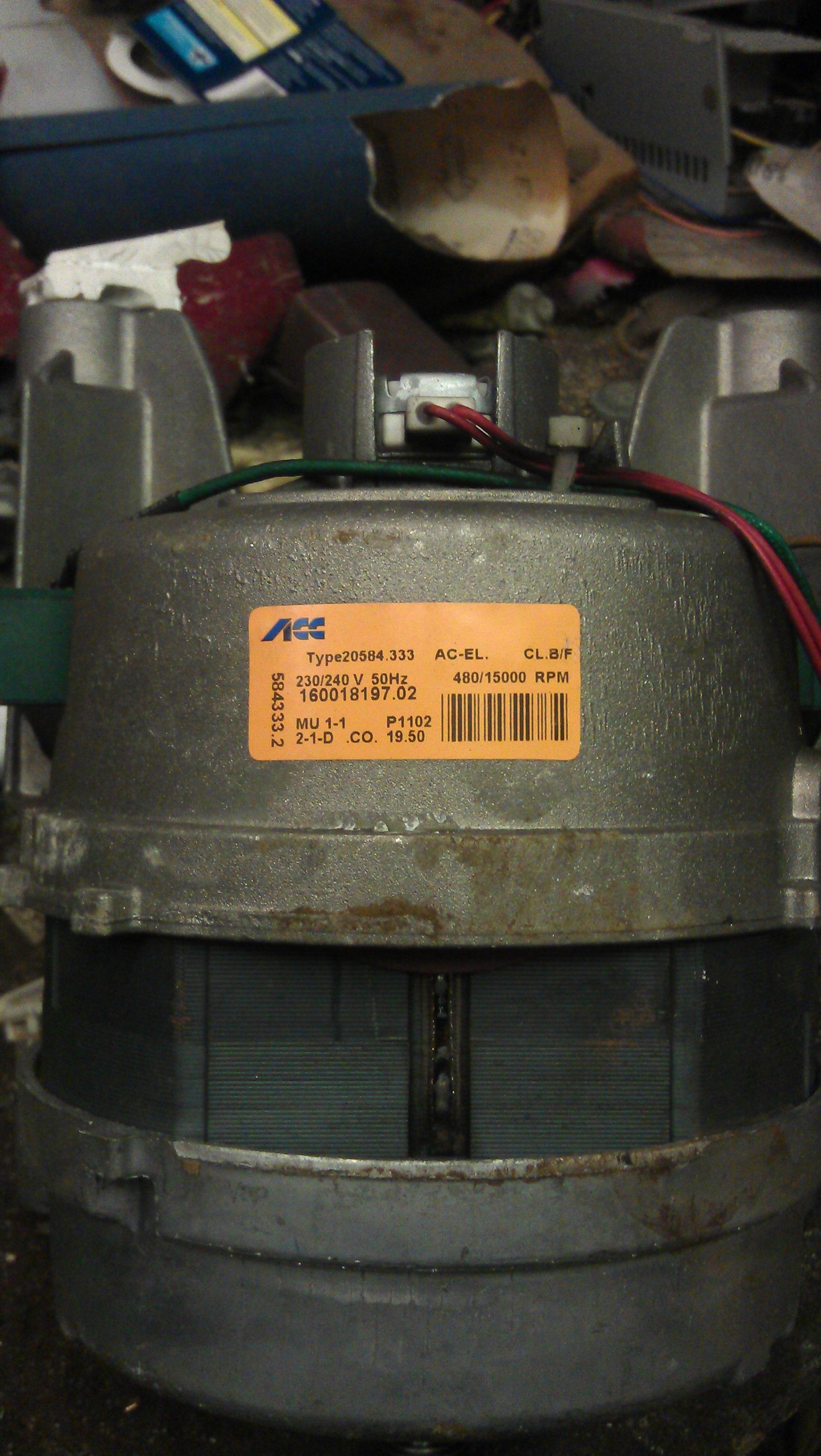

Offline speedibee
  • Posts: 24
Re: how to make a speed controller for a washing machine motor
« Reply #5 on: November 16, 2016, 05:22:06 PM »
Yes the motor has brushes . it was from an indesit 1100 spin washer . I think its called a universal motor

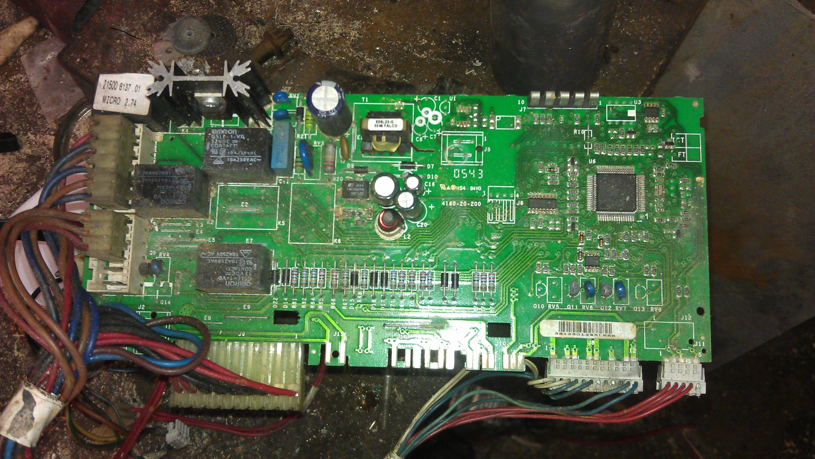

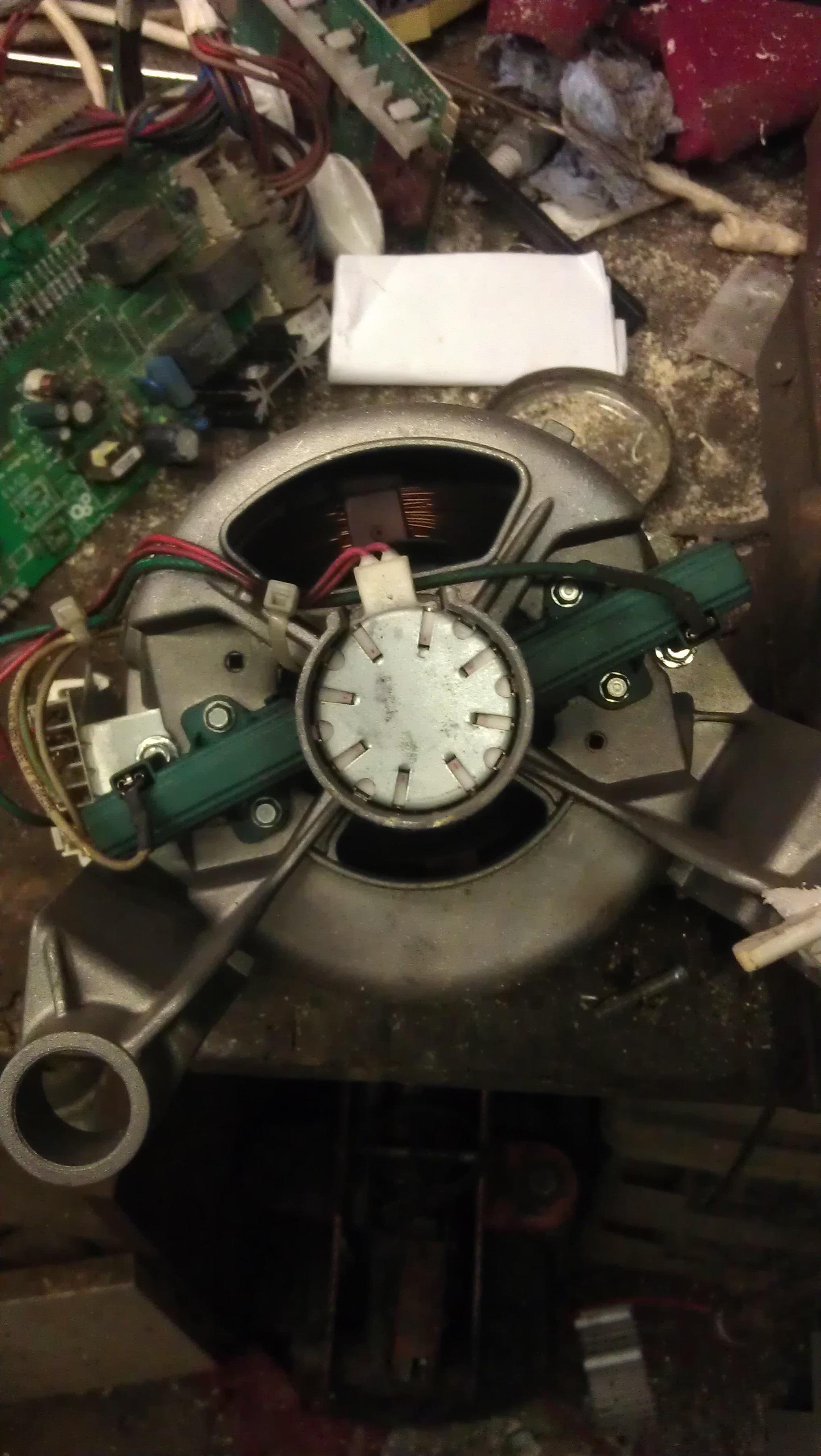

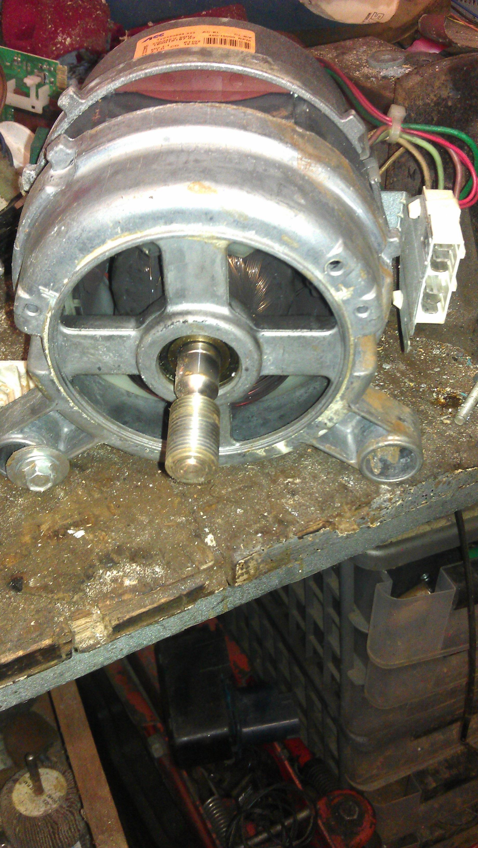

Offline speedibee
  • Posts: 24
« Reply #7 on: November 16, 2016, 05:47:17 PM »
some motor photos and one of the original control panel

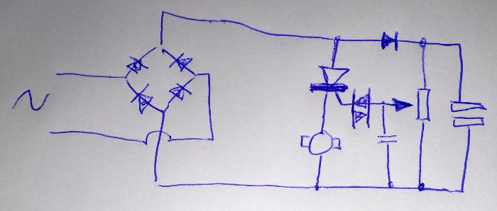

Offline picclock
  • Posts: 613
« Reply #8 on: December 18, 2016, 10:35:21 AM »
I think these motors are DC controlled, and if memory serves me correctly mains powered via a full wave rectifier (or at least they used to be :-)). A simple controller can be made by using the  dc voltage generated by the motor rotation to trigger the thyristor when the rotation, and generated voltage falls.
Its a very simple circuit that gives excellent speed regulation vs load. The downside is that there is no mains isolation so that touching any part of the circuit could be lethal, so serious insulation and earth leakage protection mandatory.
Parts must be 400v rated (240*1.414), though the pot can be quite a high value, say 50k. Diac and thyristor to suite.
Circuit operation. Rippling DC from the full wave rectifier is fed to the Thyristor/motor series  circuit. The speed control pot wiper is connected to the diac and a capacitor. When the voltage of the wiper is greater than the diac voltage plus the motor generated voltage the diac will switch to conduction and discharge the capacitor into the thyristor gate triggering it. If the motor is too fast the voltage produced will be too high to trigger.
« Reply #10 on: December 18, 2016, 08:00:42 PM »
A couple of questions... please tell me to go google it if it's easier...
What's the purpose of the 2 capacitors? I presume the large one on the RHS is to reduce ripple, and the small one between the DIAC and the pot is to negative bias the diac?
Approx what size should the capacitors be?
As the pot is at up to 400v potential, presumably a boggo carbon track pot can't be used... Firstly, what component would you recommend there, and second, how hard would it be (famous last words...) to replace it with some kind of computerised pot?

Offline picclock
  • Posts: 613
« Reply #13 on: December 19, 2016, 03:08:21 PM »
The capacitor on the pot wiper is to allow a large pulse trigger current to flow when the diac voltage collapses. This means you can use thyristors with a relatively large trigger current, say up to 25mA. Larger capacitor = more trigger current. 0.1uF is good for most cases. Can also have capacitor low end connected to thyristor anode (motor side). Not a lot in it except capacitor voltage is then vdiac max say 40V - probably better to do this if you are making one.   The other capacitor on the RHS is to smooth the rectified AC, and will need a voltage of 400V. 10uf is plenty, 1 uF is adequate. You can work  out the ripple voltage. For a 50K pot current is around 6mA. CV=IT - near enough in this case. In the 10mS before the next pulse with 1uF 6*10-3 * 10-2 /10-6 =0.6v ripple - more than adequate in 340V (1.414*240). With a 50K pot you will need a 2W wirewound controller. There is no reason not to use a 100k pot with a 1W rating which might make things simpler.
To replace the pot with a DAC would not be difficult, but the output voltage would have to be very high so likely a simple transister buffer/amplifier would do. BF338? video deflection transistors may work for this.
Circuit speed regulation is excellent, and will allows full control from zero up to peak voltage - vdiac (~310V).

« Reply #18 on: December 27, 2016, 02:22:22 PM »
Hi Speedi
480 to 15000 RPM will require some serious gearing down to work on a lathe.
Being a universal motor it should work through a "KB" speed controller  as John Rudd Suggested.

Offline Bee
  • Posts: 41
« Reply #21 on: January 01, 2017, 01:40:29 PM »
The whitish blob on the back of the motor in one of your photos is a speed sensor. In the washing machine's controller which uses an IC controller this feedback is what enables it to run a steady splosh splosh splosh on the wash cycle. Worth using that if you can figure the wiring for the controller.
