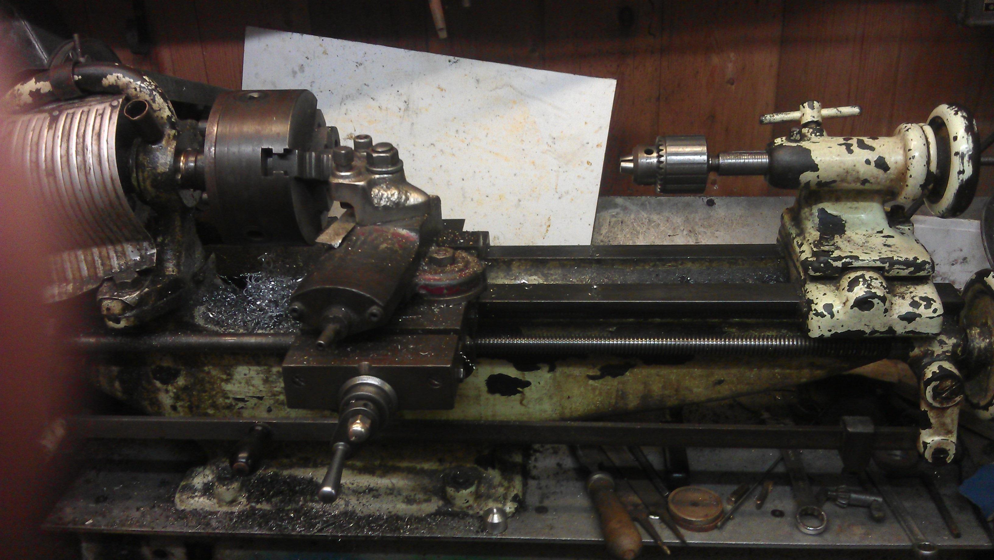

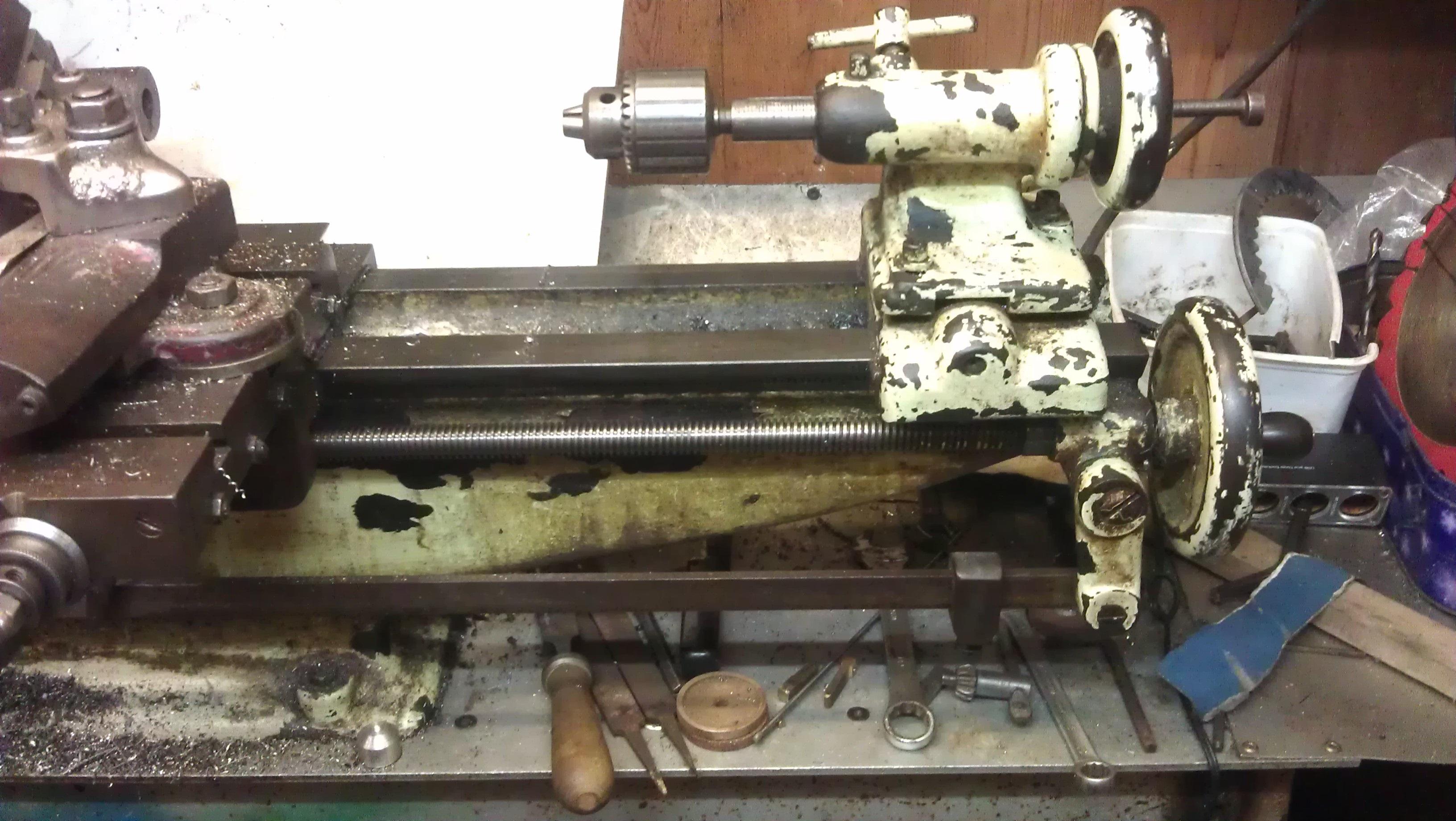

this is the lathe I inherited from my dad . it has no manufacturers name on it ,or any other markings , I know it pre war because he got it from the place he worked before the war . but that all I know

Early Drummond I'd say. Do the change gears have two holes in them for taper pins?
EDIT: Yeah Drummond B   http://www.lathes.co.uk/drummond/page5.html

Thanks that's it . got it in one .

As the others said, its a Drummond B. I have the Admiralty version of the same machine, a B.S with proper apron and power cross feed, they are pretty capable machines for their age. Much more sturdily built than my other machine, a Drummond 'pre-A' flatbed from 1904 which has the same overall form but much more lightly constructed.
The number on mine is out on the tailstock end of the bed somewhere.
Are you planning to keep it and use it - I hope so, nothing like using a family heirloom :)

I have been using it , made a couple of stirling engines .  cant figure out why the saddle drive won't disengage automatically , to engage it  I have to pull the bottom bar to the left , and that's the way the auto disconnect would push it . so I'm a bit stumped , really it needs a bit of a refurb ,but I have so many other projects on the go I don't have time :)

It is an early model B because the later ones did away with the 'basket handle' above the headstock which didn't stiffen it up as well as they expected. Worth joining the Yahoo Drummond group which has lots of info but if you aren't already familiar with Yahoo it doesn't work very well with Microsoft Browser.
The cross bar for the auto-disengage is so characteristic you can spot a Drummond from 300 yds away. Above the drill chuck key in photo 1 the clamp on the bar is supposed to be set on the left of the saddle. There is a drop down bar missing from your saddle that comes down to push that clamp and the cross bar to disengage the drive.
