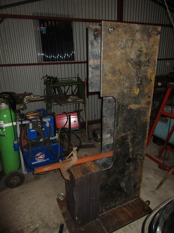

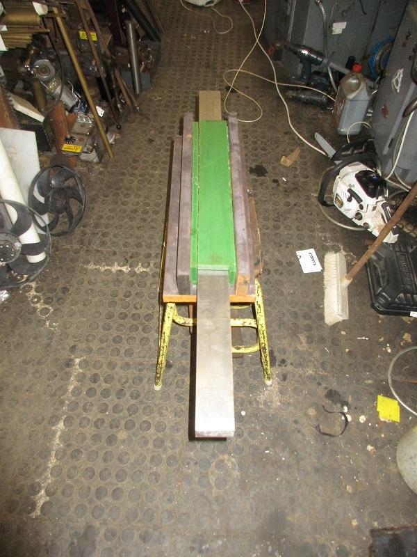

 To make my wooden  clock tower I needed to make some framing pins to hold it together before the final fitting of wooden pegs.
I need to make about 20 of them and after years of using hammers[usually a 7 pound hammer with a short handle as a club hammer] my wrists and elbows are starting to get worn out. So I decided to build a power hammer .
Searching tinternet cme up with this site https://www.kensiron.com/kz100
Brought some steel  and started making this
Steel plate are 6 feet by 30 inches and 12mm thick, anvil is  12 inch  by 1 inch plates by 24 inches long  and will be bolted into a frame with the idea that they can be removed to make it lighter to move  .
 Base plate is a piece of 30mm thick plate
The hammer will be a 1metre length of 65 by 50 bms sliding in oil impregnated nylon and operated by a 60mm bore hydraulic ram running on compressed air

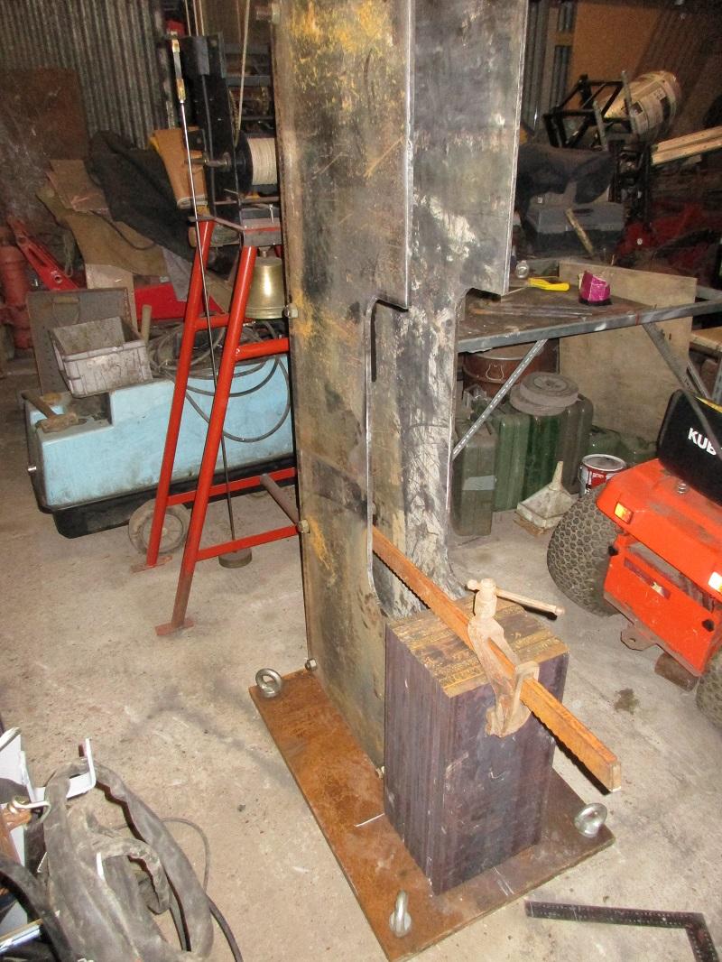

« Reply #5 on: November 09, 2016, 06:23:21 PM »
Unfortunately I won't be doing much for a couple of weeks as I am a bit over run with that nasty thing called work .
Have a couple of things to ponder   .
 I intend to use a Hydraulic ram as I have one of the correct size and   heavy duty air rams are expensive . I am not sure how the seals will stand up but will use plenty of oil in the air . Also intend to use a  5/2 hydraulic valve to control everything as 1/2 bore 5/2 lever operated  air valves seem to be hard to find  . Finished weight should  be about  1 ton
The next problem will be on how big a lump of concrete to stand it on
A friend of mine who has  a  modern Sahinier  power hammer has it bolted to a block of railway sleepers  that sits on a concrete foundation but not bolted down  It works well so might go that way. Anyone got a big compressor for sale?  Mike

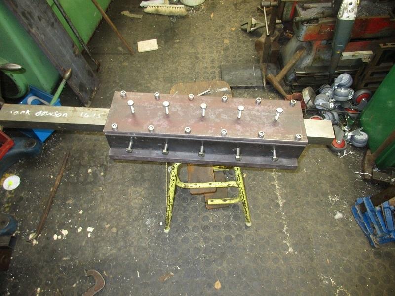

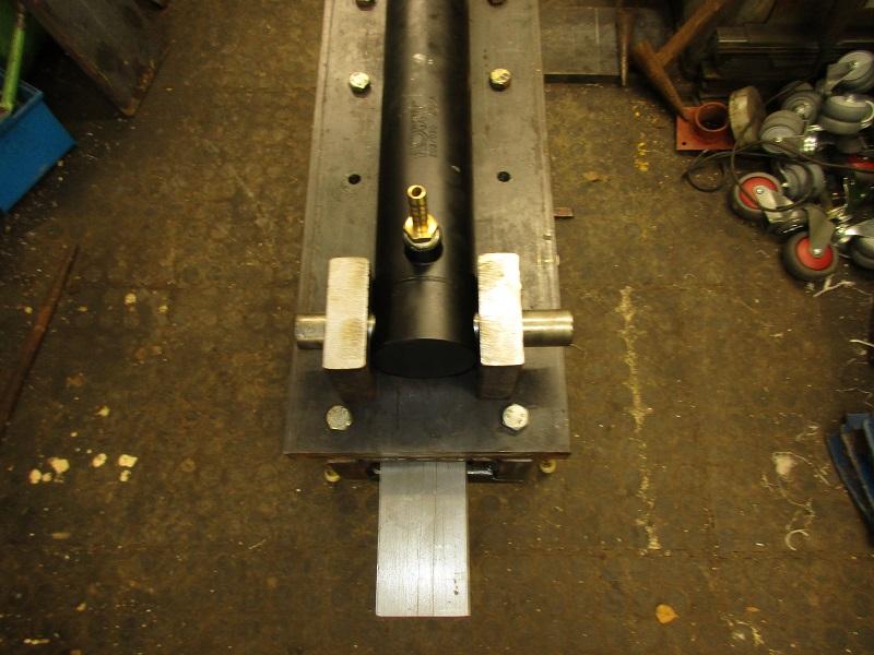

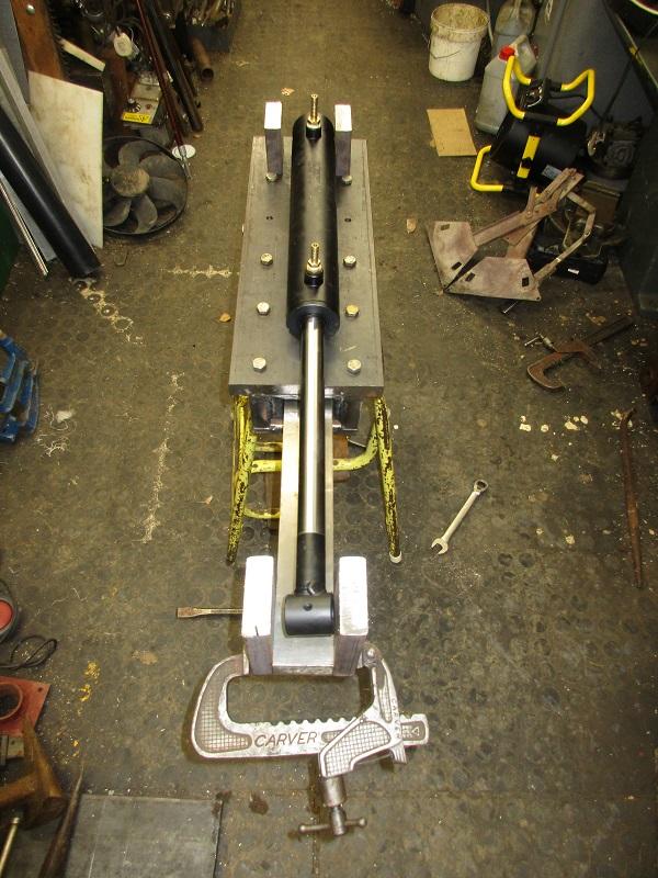

« Reply #7 on: December 08, 2016, 04:47:19 PM »
Made some progress on the hammer guide and ram mounts today.
 Should be ready for starting to weld it together soon
Its starting to get a tad weighty now , the ram guide is all 25mm plate  and  with hammer shaft weights about 150kgs
Next I need to obtain some large lumps of steel for the hammer head and anvil block ,need 2 blocks of steel about 150 mm square .
 http://www.anvils.co.uk/ sell tooling for power hammers but at about £250 a piece which is a bit more than I want to spend .
I will try and get some railway track to modify  Mike
