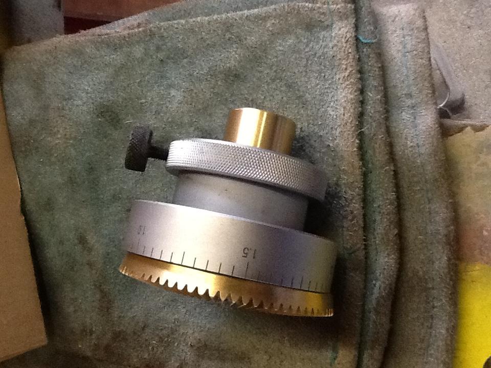

Re: 626 mill power feed install
« Reply #12 on: October 29, 2016, 10:20:28 AM »
Sorry fir the lat reply, been out with the granbairns.....
The align unit uses a bevel bear bearing on tge leadscrew, driving it via keyway....
So one I have the power unit mounted, the bevel gear needs boring to fit the shaft diameter, the  the keyway needa enlarging.....
This int no 5 min bolt on job....I'm goung to have to think about what is needed to make it all work.....

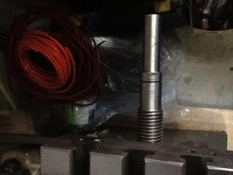

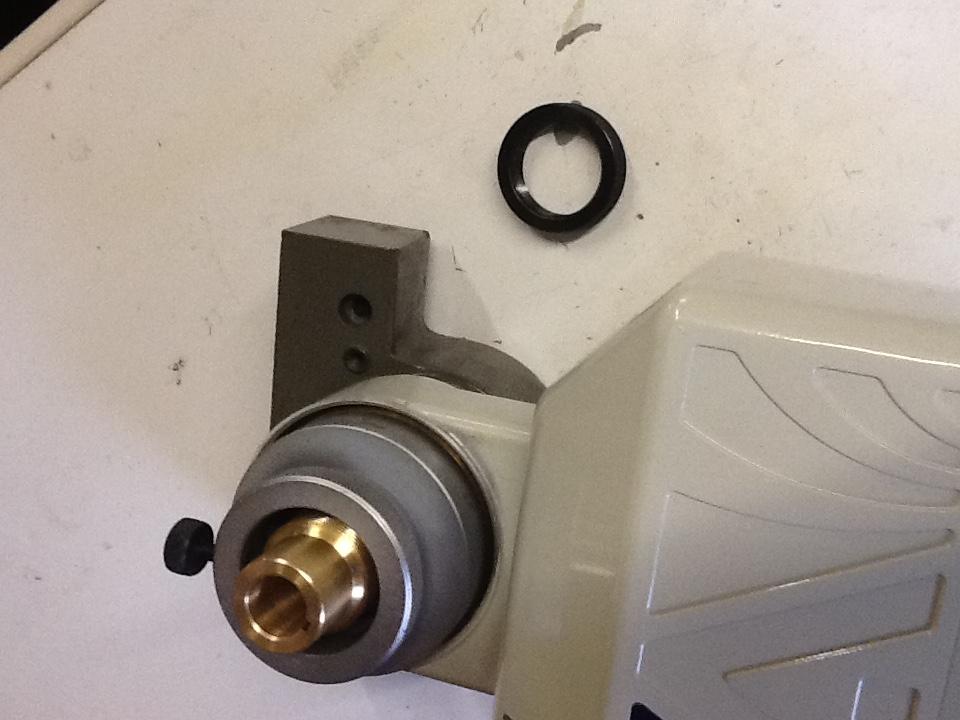

« Reply #14 on: October 30, 2016, 12:50:21 PM »
Some photos.....
« Reply #15 on: October 30, 2016, 12:51:57 PM »
Here's one of the shaft.....
And the bevel gear with the dial....
Offline BaronJ

Very nice but he doesn't want to fit a wiper motor, he's already bought the align unit.
John they normally come with the generic 8 ? page handbook which is really next to useless unless you have a Bridgeport which they were made for.
Just had a look and found the manual and downloaded it here.
http://www.stevenson-engineers.co.uk/files/ALign%20Power%20Feed%20Instruction%20Manual.pdf
Can't see these things fitted on the left because the controls will be at the back ? Not sure if they can reverse ?
On the few i have fitted to other machines i have stubbed the leadscrew and mimicked the imperial sizes of a Bridgeport which is what the Align expects.
TBH I don't like these units. Under-powered, the plastic gear in the bottom is a hand grenade waiting to go off, in fact they often fit a spare inside the bottom cover, just check ?
But main reason is as you switch from right to left or just engage feed it moves the pot as it shares the same shaft and the friction seal isn't good enough.
[EDIT]  pretty sure I have some spare Align castings for the RH side of Bridgies that never got used on other machines.
If you want one to carve up then shout up.

The biggest issue I have now is recutting the keyway in the bevel gear.....
« Reply #19 on: October 30, 2016, 02:58:25 PM »
John,
Just stripped a new spare unit out to see if they will reverse but no the drive for the vertical bevel is offset.
If you get stuck I can open your gear out to 16mm with a reamer and pop a new keyway in.
« Reply #20 on: October 30, 2016, 03:22:27 PM »
John,
Thanks for checking the handing issue, I'll stick with it as is..
Greatly appreciated..I'll bear your offer in mind...for reaming/broaching. :thumbup:

« Reply #21 on: October 30, 2016, 03:50:22 PM »
Presupposing your mill and drive unit came from the same supplier, can you twist their arm for a spare gear to machine, then if it goes wrongly is not lost? You should not have to do any fitting/machining but that looks like the required solutioion. Not so bad when you are trying to cobble something up but disappointing when you have paid the going rate and debt with the specialists.
