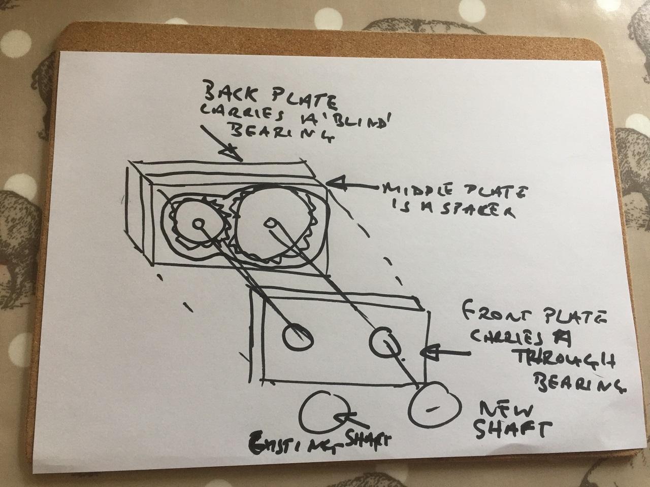

Eric,
Can you not make a flat gearbox that bolts on round the main shaft and has a 2:1 ratio presenting a shaft where your missing one is and running at the correct speed and direction?
I imagine a sort of sandwich arrangement, two flat plates and a spacer a little fatter than the gears, suitable bearings for the new shaft, and filled with a little oil.

« Reply #7 on: October 26, 2016, 09:40:15 AM »
Eric, a quick C o Cad sketch
The cam shaft goes half the speed of the crank shaft so you need a pair of gears with a 2:1 tooth ratio. Drill the rear plate to pick up the mounting hole around the existing shaft. Gasket paper between the plates and drill an oil filling hole somewhere
That looks like it could be a good solution. I would just have to find gears that would work as I am not setup to cut my own gears.

Yup. Gonna keep the old engine for a bit. I will use your idea of a flat gear box. Need to design it and find gears that work...

« Reply #22 on: October 27, 2016, 01:20:18 PM »
A perfectly acceptable keyway can be made by:
a/ turn a plug to be a tight fit in the bore of the gear
b/ drill a hole slightly smaller than the width of the keyway so half is in the plug and half in the gear
c/ remove plug and hand file embryo keyway out to full size using a four square file
It actually doesn't take long as the drilled hole removes a lot of the material and acts as a guide
