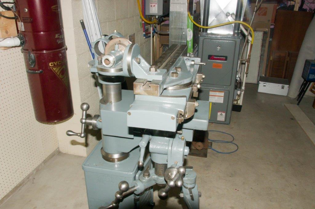

I have normal size universal grinder and trying to lean how to use it.
Noticed that magnetic chuck would be a nice idea.
I think that relatively small and lightweigh would do. However, never havin had or even used one, desided to use some time to get my act together before shelling out some money to buy a random one.
* Do old ones wear out or break under normal use?
* Is small (I don't see myself grinding really big parts) fine or do I shoot myself on foot?
* New ones seem to be mostly permanent magnetic type, but some used ones seem to be often electromagnetic type.
Little time ago I saw one old surface grinder for sale, it had almost full table size electromagnet chuck...for 400€. It was huge......
So....what should I know?

Caveat: My surface grinding knowledge is limited, however:
Nice, accurate grinding of long parts is difficult with hand feeding and no coolant.  BUT you can always use more "table space" for setups and additional in-situ measuring.  Go with the vice that provides the most area while still being practical.
I'm not sure about the magnetic on/off elements, but the table surface should be relatively easy (in fact, almost certainly necessary upon installation), to true up with the grinder itself.  I'd suggest that it not be the first thing you try to grind though.  As long as it's flat enough to hold a part well, forget about how parallel it is to the axes and just try surfacing a few smaller parts first, maybe in a small grinding vice.  Then once you get a feel for the machine, go at getting the vice flat/parallel.  If, as you improve your skills, you find that you didn't do it as well as you thought, just do it again.  Take off the absolutely minimum required to get a true surface.  If there's a spot that's really bad and you need to go really deep to clean it up, think about whether you can live with just avoiding that area.  It will be fine if it's out of the way.
I've only used the permanent magnet type, which I think work very well for small machines.  One benefit is that your work doesn't get launched if you have a power failure.
As I'm sure you know, but I'll remind you, YouTube is your friend.  Suburban Tool has a couple of surface grinding videos with nice little tidbits of knowledge thrown in there.
One more thing: DUST!  Obvious, but I wouldn't even try to put it in my living space or near other nice tools without really good dust collection, or perhaps coolant controls it well enough - though no fist hand experience with coolant.
I'd love to get one myself, but do have access to one at work.  Unfortunately it does not get treated like the precision machine tool it is supposed to be.

hi PekkaNF its you lucky day  I do a lot of grinding  as part of my job so I will deal with the important stuff first NEVER levee the grinder running once you have dun you bit of grinding always switch it of  yes I no people will say that they don't but when the wheel is up to full speed it can look as if the wheel is not spinning so you cum a long with a peace of cloth to wipe the table dawn next mint your hand is court up in the wheel grinding wheels at that speed don't cut they burn so its harder to get treatment at A&E right that's the boring bit over there is sum good books out there on the youse of grinders next bit the table eclipse recommend having the table Servest every so often and the good working life of a table is 15 years after witch they recommend a replacement table the tables at work is Servest on a yearly bases be carful if you is grinding the table level the modern ones ant a problem the older ones  that youse brass as a in fill in the segments on the table if you have the wrong stone on IE one that's soft the stone will not cut the brass but will cut the steel so you end up with a wavy table    right the grinding of small components set then to a angel on the table with plates ether side of the component  always grind in the opeset way IE if you remove the component that you is grinding don't put it back on the table the same way turn it rawnd    hope this helps

You should take a look at the Deckel S1 Universal manual, it has lots of set ups for collecting dust at the source.
I am going through a similar process with my Cincinnatti Universal from 1915
