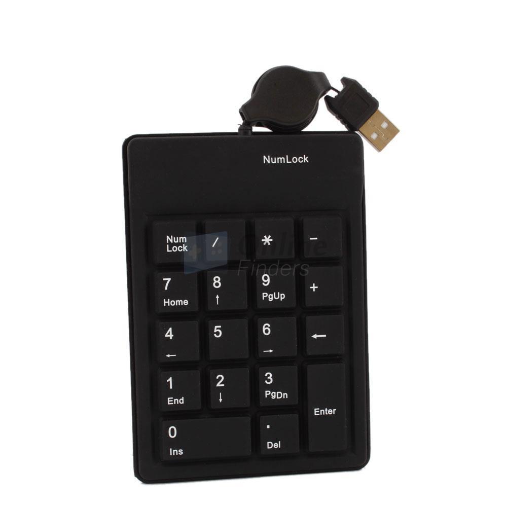

As a temporary fix I ordered this from China for the princely sum of £3.89 including postage
http://www.ebay.co.uk/itm/222200675479?_trksid=p2057872.m2749.l2649&ssPageName=STRK%3AMEBIDX%3AIT
Just unpacked it and I suspect it'll be good for a while. Totally sealed rubber membrane over the keys, and although I've not tried it on the MACH3 machine yet I don't see why it shouldn't work, as it does plugged into my laptop. Win7 loaded drivers for it happily without my intervention.
The USB cable is very thin and rather short - hopefully if I can find my USB extender then I can use this for jogging the plasma torch about, slightly remote from the PC

« Reply #8 on: October 29, 2016, 11:28:58 AM »
Pleased to report that it works splendidly under MACH3 - so I just need to extend it's USB cable to a sensible length for wandering and I can then jog the plasma cutter anywhere I like and be close enough to see it's in the right place (this plasma table has a 1.5 metre square cutting area)

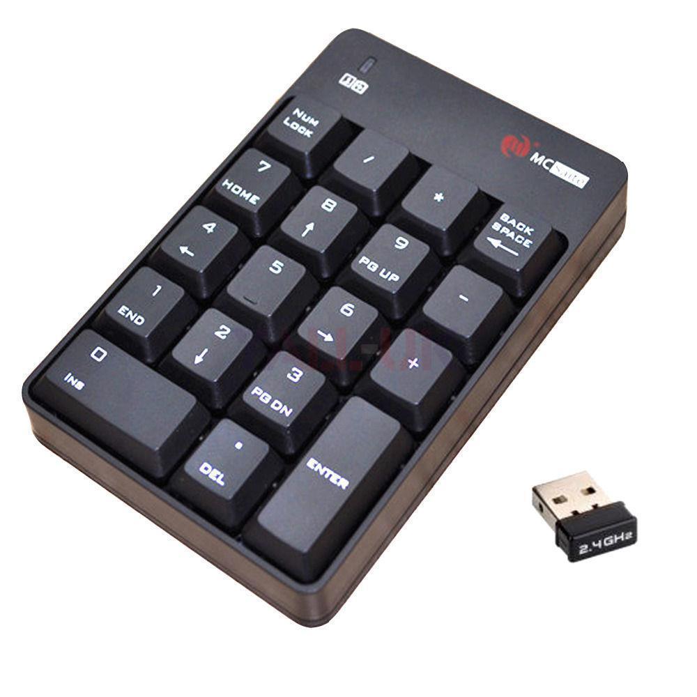

Although the wired keypad worked ok, I replaced it with a wireless usb one illustrated below and it's excellent. Only about £9 including postage  :bugeye:

I'm still very impressed with that little Chinese numeric pad - I know it will eventually fall foul of sparks from the CNC Plasma cutter, and in fact I have a spare on order awaiting that eventuality  :thumbup:
(after all they are cheap as chips - £8.95 my latest one ! )
