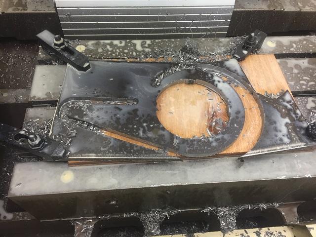

Way back when I often made panels for multiple gauges and indicators and the like from thin sheet
The trick was to stick the metal sheet to some fine faced plywood before drilling and cutting

Maybe 'profiling cutter' will get the results you want?
When I've done aluminium front panels in the cnc mill previously I mount them on a spoil board, and cut them out with a 6 mm end mill, or smaller if the detail dictates.
Years back I did make up a clamping frame to suspend panels an inch above the mill bed, allowing plunge cutting right through, but the vibration and drumming of a 19" x 1/8" standard panel was too much. Mounting to a spoil board prevents most of the drumming.

I would have thought any carbide cutter would deal with 1.2 mm steel.
You could use the same method as you outline above, but leave plenty of waste on the cut  (say 2 mm) and then go around with the mill and clean it up. That way you won't need to use very small cutters,

Many years ago I made a fuse/switch panel to a boat. I used 3 mm aluminium, because any thinner or steel was no go.
I used 22 mm floor grade (extra strong) MDF as a sacrificial board. I drilled the fixing holes (that actually were used to fix it in the boat) and used them and panel printed out of transparency to mark the holes.
Inside the cutouts and over the holes I put thin doublesided tape.
MDF was prepared/clamped and one side had a strip of wood epoxied and milled straight. The strip was needed to index the panel straight before dropping it down. Good luck trying to straighten panel with double sided tape......
I used plenty of screws to clamp down the panel.
I milled the cutouts plenty of trough, but left generous "tabs" on longest sides. Then I screwed down the cutout, with a screw that had a large head, some unscrewed portion that was excactly same diameter that the slot I milled. After the hairy bit I found out that you need two screws on every four side of the square cutout. Phew.
There were some blemishes, but luckily I was working on the back side of the panel, none of them showed up on final work. I left some cutouts with the tabs, because It was not too hard to cut the tabs out and file straight parts.
Needs plenty of clamps to support thin sections between the cutouts. I used plywood.
Round holes cut with camfer bits came out perfectly camfered and clean.
I cleaned up the face of the panel with solvent and abrasive sponge. It came out nice.

I will go with sacrificial mdf under and lots of screws holding the cut outs and also use the main mounting holes.
Will try a 3 flute carbide cutter running fast (1000 - 2500) and see what happens
I will leave tabs on the cutouts and nip them off and file to true at end of job.
Also mount the work face side down!

Forgot to mention that it is pretty cruicial to use thin doublesided tape. Thick foam type is no go. Another thing is to put piece of tape under fixing hole and washer on screw, it's surpricing how little pressure is needed to buckle a thin piece.
