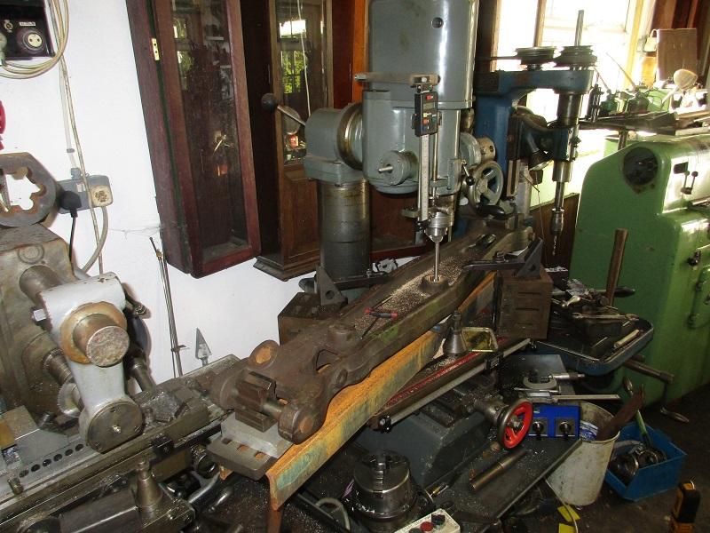

Another job today . This one is a front axle from a 1929 John Deere tractor . It had already been bored out and had a bronze bush inserted but it had been badly done and was not squared to the axle  It is realy a bit too big for this machine which is a Arboga milling machine so had to use a piece of channel to make the table  longer , bored out the bush and fitted 2 steel backed glacier bushes . It looks a lot better now
