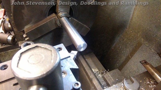

Went into the workshop today for a bit of a tidy up and get ready for next week.
First job on the bill is fifty 20mm diameter shafts, faced and chamfered to length with a M8 hole in both ends.
Now this job calls for a back stop in the spindle and a bed stop to get to the finished length of 176mm. That bits simple but if the bed stop is set for that length you can't get a chamfer on in the same operation.
So something I have been promising myself for at least 8 - 10 years is a turret stop.

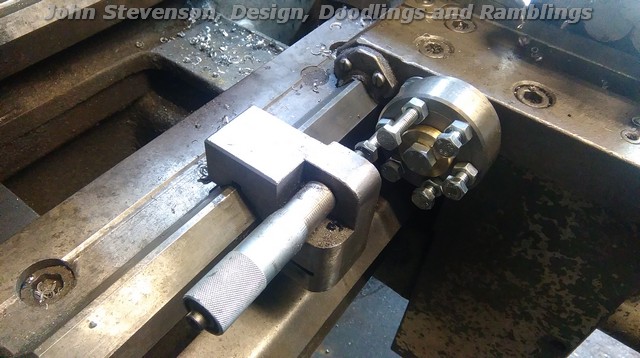

So hunted around the offcut bin and found a thick lump of steel and a few holes and a brass bush later we got this.
The micrometer stop was there before and just located onto a button on the carriage. this button has now been replaced by a spring loaded ball detent.
Now allows me to face to length, then move nearer the chuck to chamfer off.
Only 8 or 10 years too late  :clap:

It's one of those things you don't use often, but when needed is a godsend. I made one years ago for my Colchester Master - made two in fact and put the second on eBay and was very surprised how much it fetched. Even put spring loaded ball bearing detents to give it click stops  :ddb:

That looks very functional.
Where is the ball detent?
Micrometer limits a little extreme distance span, but probably will cover most of the needs ever. I have basket case capstan lathe that has a long rod to allow some serious versatility, but modern HSE probaly would have a fit.
