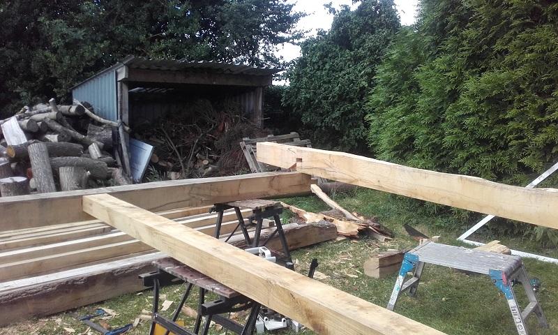

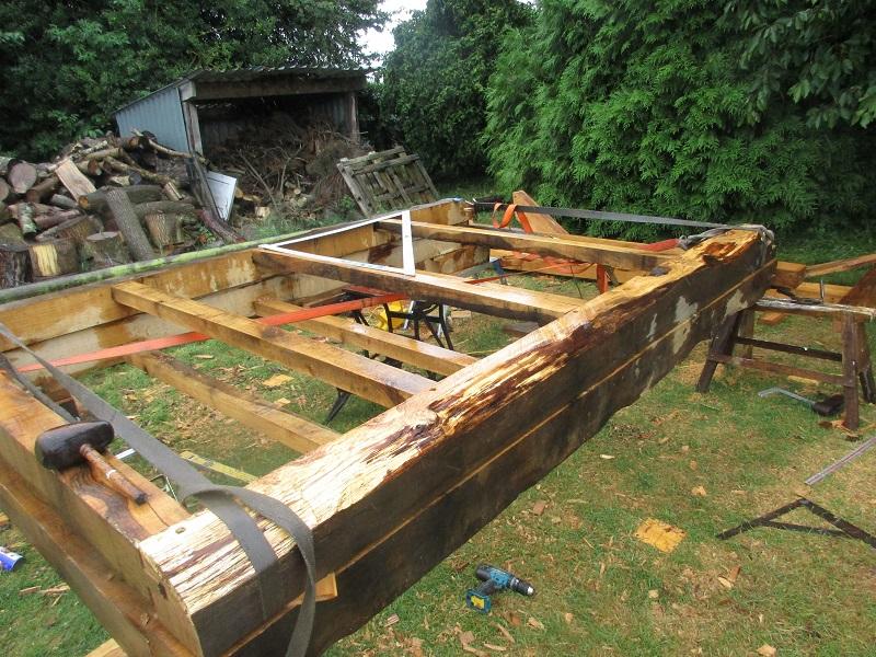

This is the start of the frame for a clock tower . Its 2.5 meters square by 4.5 meters tall and built out of fairly low quality green oak ,
Its all wood that was rejected by the saw mill so was nice and cheap
Because its only rough sawn and  not very square I have marked all the joints using a plumb line and dividers

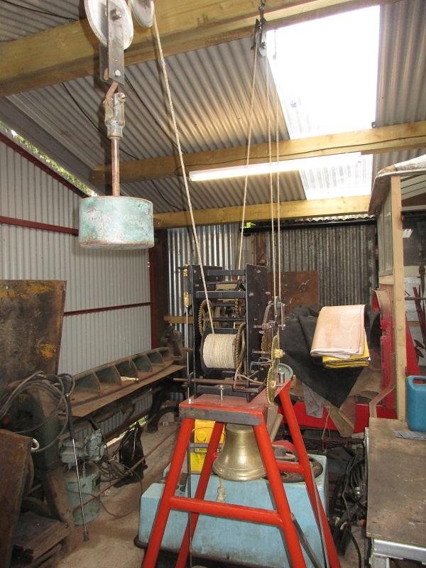

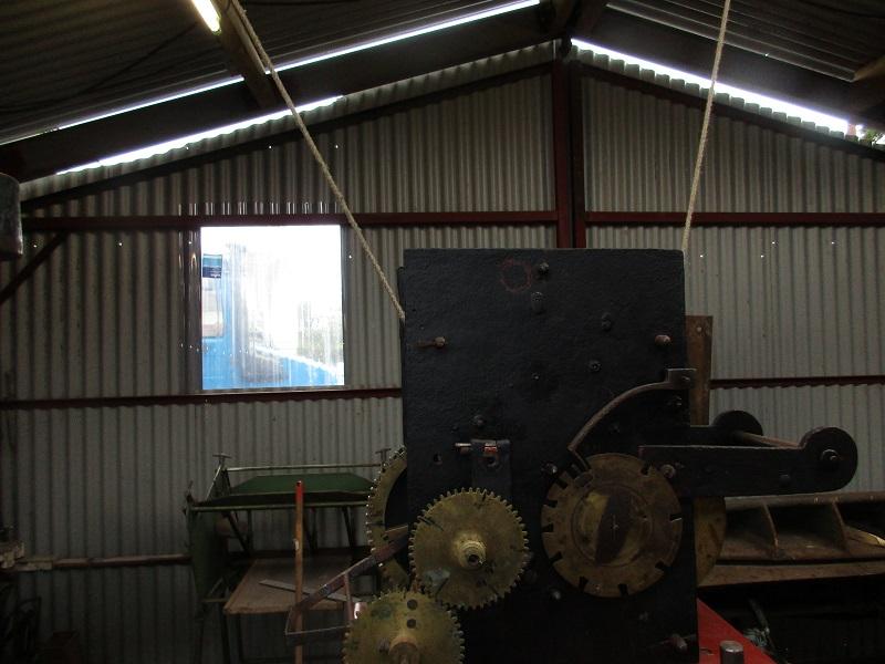

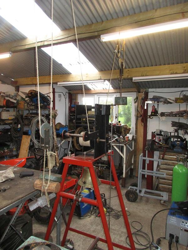

The project is to build a full size wooden tower housing a large turret clock and a 8 foot dia clock face complete with chiming on the hour .
The tower will be 10 feet sq and 16 feet high with a pitched roof . Not made much progress but hope to have it up by next spring. Working on the clock at the moment
The wood comes from Whitney    http://www.whitneysawmills.co.uk/  Eugene if you are near Leominster drop in and have a chat I am usually about and the kettle is always on  Mike

Some pictures of the clock for the tower
