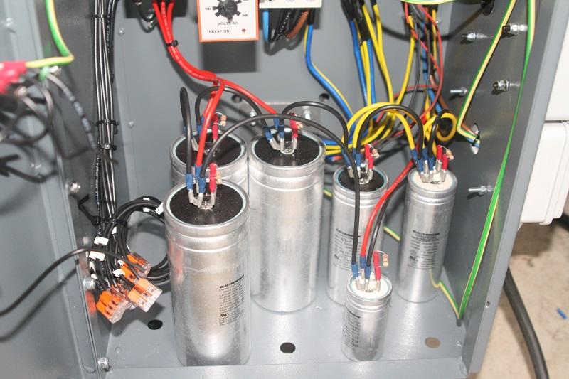

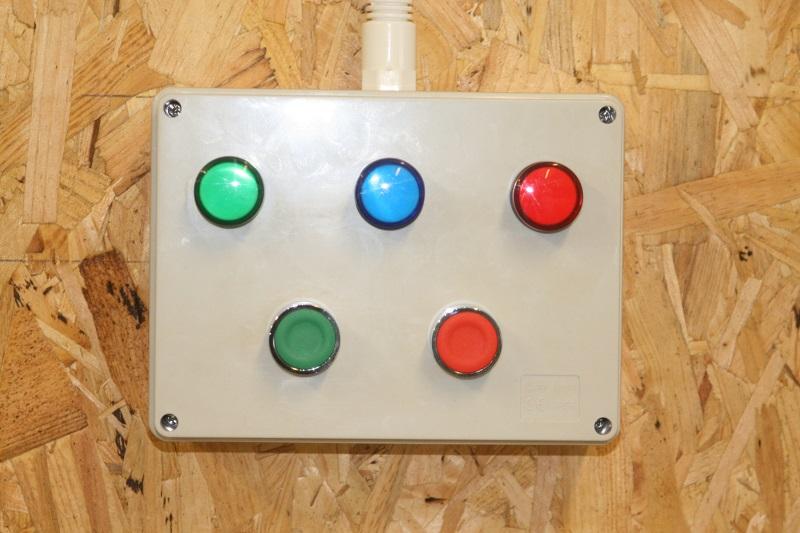

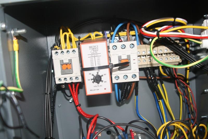

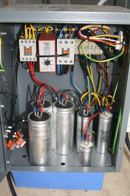

« Reply #10 on: September 04, 2016, 05:18:59 AM »
Here's a few pix of the inside of my Transwave. They do mention in the small print restrictions which specify the size of feed cable and MCB size and also the max size of a single motor.
Not quite sure how to include text between pictures, so that first. :scratch:
1. whole of the insides
2. top half
3. bottom half
4. front plate
5. remote box (awaiting labels)

« Reply #11 on: September 04, 2016, 05:23:21 AM »
Just noted Andrew's post. My Transwave came with the 5 wire 415v output feed incorporated already, but the mill did not, so had to just replace the mill supply wire.

 :clap: :clap: Nice one Pete  :thumbup: thank you for taking the time to take the photos , its good to see whats actually in the box .
