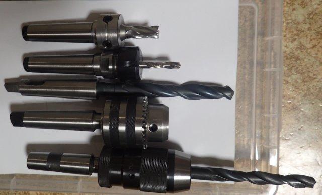

I seem to be running out of daylight increasingly often.
Stubby drills solve problem easily until 8-10 mm diameter, but larger, specially 16-25 and over is a problem.
1. Mount: MT3 shank is long, straight shank would be nice, specially 16 mm dia. How is the Rotabroach type?
2. Drill length, are there drills that would have close to same lenght, short shanks over 12 -> 20 mm (or close) diameter?
Thank you,

I seem to have a collection of large drills that have either been cut short with an angle grinder and re sharpened, or extended with a welded on shank.
You just can't win I guess...
IIRC rotabroach cutters mount on an arbor. So making an MT3 or parallel shank adapter shouldn't be hard???

I got rotabroach cutters mounted in a collet to give me more daylight , but they are smooth cutting and will cut large holes in one go , run slow as they are difficult to sharpen the offset teeth corectly .

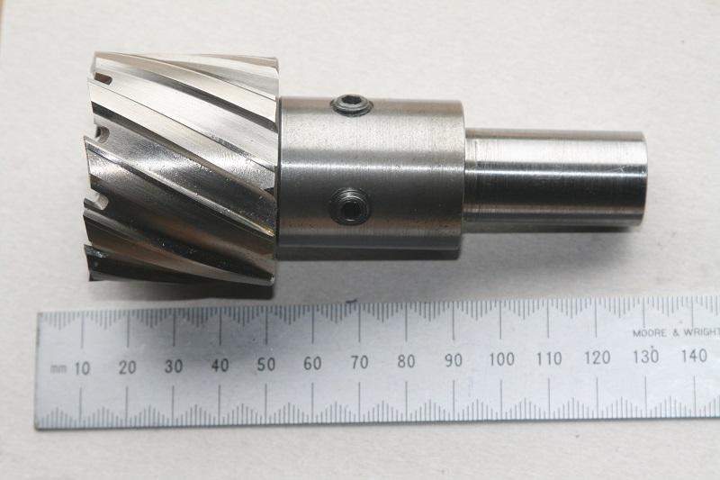

« Reply #5 on: September 02, 2016, 07:03:38 AM »
I use the Rotabroaches in an adapter made to fit the 20mm R8 collet. The short ones are good for about 25mm deep cuts, but need frequent clearing. My adapter adds about 75mm from the collet nose to the broach cutting faces.
Re: Thick stubby drills
« Reply #6 on: September 02, 2016, 11:31:03 AM »
Thank you, I think that rotabroach is way to go. I went to buy one 20 mm dia short rotabroach....they had none. Bummer.

« Reply #7 on: September 02, 2016, 12:00:35 PM »
I use mt3 collet without slipages so far, the largest rotabroach I have is 35mm tct tiped runs between 80 to 120 rpm , depending on the hardness know power coolant just a spray bottle , mag drills run slow a search on the speed should help there .

OK, got a set of most likely sizes. Rotabroach brand. It's going to take week before I'll get them, bit time to figure out how to mount them.

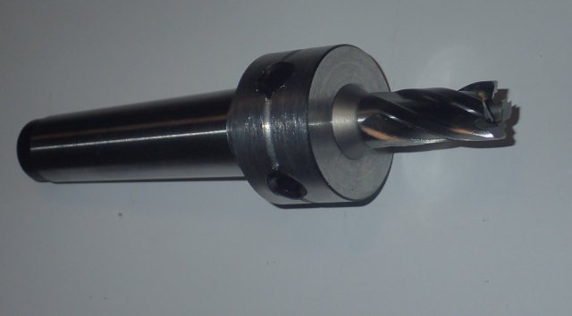

« Reply #11 on: September 06, 2016, 08:21:23 AM »
Haven't got the Rotabroach cutters yet, thinking of minimum cage length MT3 to Weldon adapter.
I'm considering making a simple MT3 to 3/4" adapter, minimum length. Nothing complicated there. However rotating coolant inducer would be interesting and probably even useful.

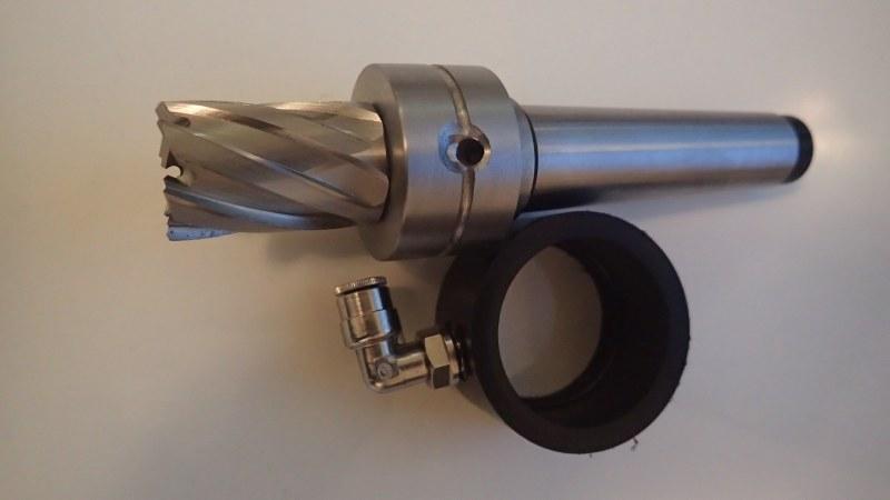

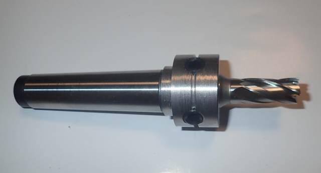

« Reply #15 on: September 15, 2016, 03:20:28 AM »
Finally I got my parcel....PostNord sat almost week atop of it. Express my hiney.
Anyway I got real brand name Rotabroaches, set of short 14-20 mm dia and extra 25mm OD. Rushed to make an MT3 minimum lengt adapter and plan was good, but the MT3 blanks that have been joy to work before turned me down. This one was made of mysterymetal and it was proverbial to work with.
It had a nice 40 mm ground outside, checked it and it was true, drilled and bored the 3/4 hole, with some difficulty, beacause the material was "sticky", got a little oversize hole (19,06 mm). Then I turned the oil grove (planned to place an angled hole from it to rear of the cutter recess. All well and original ground surface was saved for the cutting oil seal (Grub screws were M12*12 and could be shortened just a bit to clear Nylon or acetate bushing that plays the role of the seal....or that what I had in my dreams.
Went nearly acceptable, but when I threaded the M12, it raised the metal around the thread. Had to turn down the perimeter and now it is not anymore good enough finish for any kind of seal. Bugger.
Had no time to test. Hope it works. I would have liked the blank a tad longer (it is 30 mm long, dog ate 7 mm of it at the tail and web left behind of the weldon seat is thin. But that was only thick enough blank I had.
Well, I call it POC.

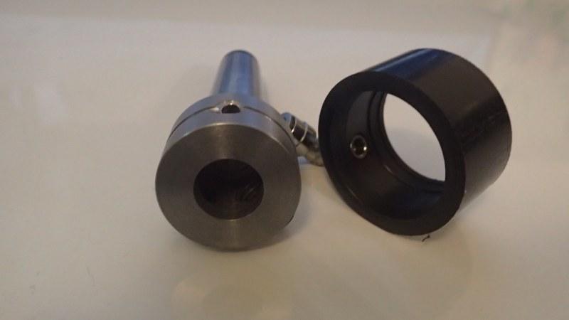

« Reply #16 on: September 16, 2016, 02:59:16 AM »
Got parcel from Germany, same size/weight parcell ordered a little later 1/3 price of P&P and 1/20 of aggravation...looks like I'll be ordering more stuff from EU than from Brexit. :lol:
Anyways I declare this partial success. I was planning to use this one to check coolant feed troughh nylon bushing, but the MT3 blank does not finish easily to any kind sealing fit without resorting to grinder and that creates it's own set of problems....mainly the fact that I haven't used mine yet.
Got 30 mm ID 42 OD ball bearing and same size shaft seals, planning to make other adaptor for trough coolant feed.

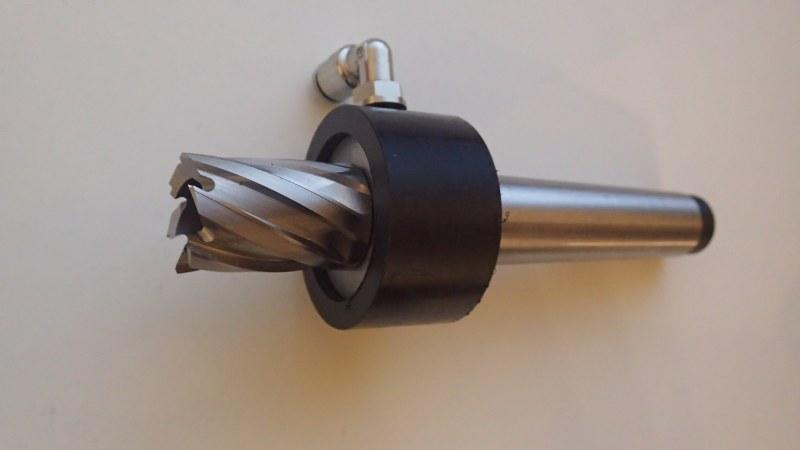

« Reply #17 on: October 12, 2016, 03:04:14 PM »
Just a little progress. Have to add reaction bar to hold the inducer. I don't want it to do flail imitations.
Not sure how well it will hold the coolat, but that piece was an off cut and it't the first try. No lipseals or such.
With third (coolant) hole it starts to look bit like a swiss cheese.
