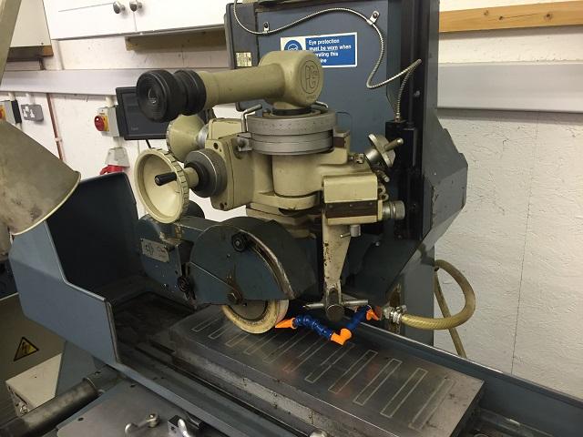

On a surface grinder you would use something like my 'PG Optidress' that lets you dress complex angles and radii onto a wheel.
However I suspect you perhaps are not using a surface grinder, but a separate spindle mounted grinding wheel? In which case you need to mount your dressing diamond onto a tilting stage that you can set to your angle and process under the wheel along a screw motion drive of some sort
