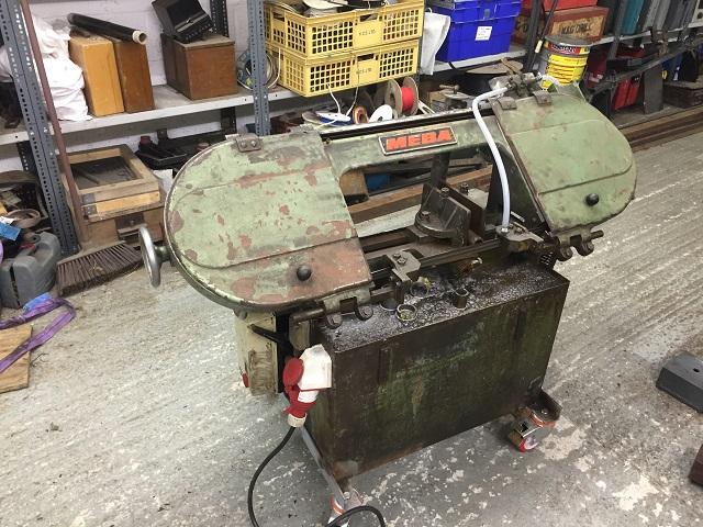

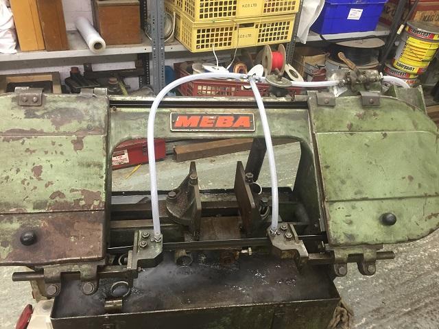

Last year I acquired a Meba  horizontal bandsaw in 'very much used' condition. Apart from putting it on wheels so I can push it around and fitting a new blade I've not used it much as the previous owner was using a total loss coolant system from a tank mounted on a stanchion.
Needing to cut some Fork Lift Truck tines I was motivated to sort it out so have recently fitted an internal tank and pump. Pump was a bit of a problem as all normal suds pumps were too tall to fit, so I've ended up using a diesel transfer pump of the sort intended to drop into the 2" hole in a 45 gallon drum. Downside was that it was 12v so have had to arrange a 12v supply as well - no matter- it's all working.
Now looking at various horizontal band saws on YouTube and eBay most seem to feed coolant to both blade guides - I seem to recall that Micktoons 'Startrite Meba' which is very similar to this one does the same. However this one only has provision on one blade guide for the introduction of coolant. Blade guides are 'handed' so are not interchangeable meaning that fluid has to be introduce on the right hand guide.
Now unless the maker expects the coolant to be carried all the way round the band before it gets to the work, then this means that the blade must travel 'right to left' so in re-wiring all the previous dodgy cabling that is how I have set it up.
But this seems counter-intuitive as the cutting forces are away from the vice fixed jaw. Also every Youtube band saw video I can find has the blade going the other way.

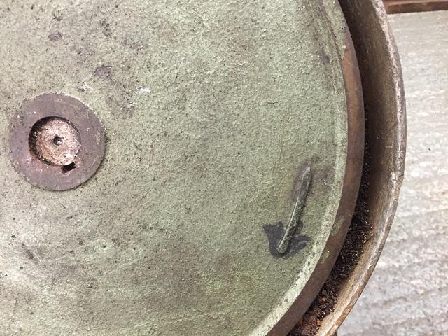

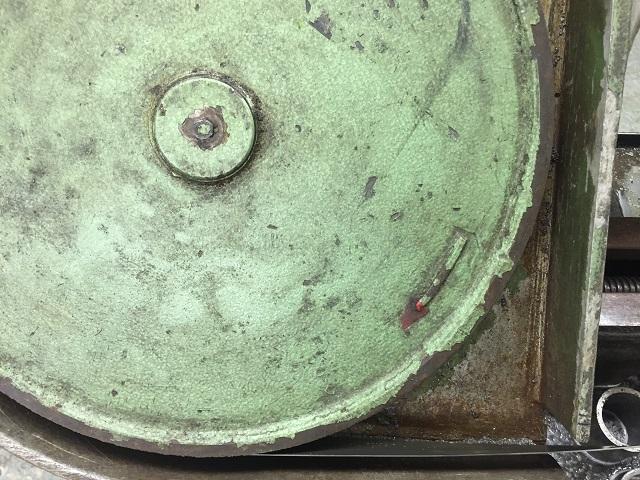

The issue is confounded by direction arrows on the wheels - it looks as though original cast arrows have been modified to point in the opposite direction.
All very odd - anyone have any experience of these things ?

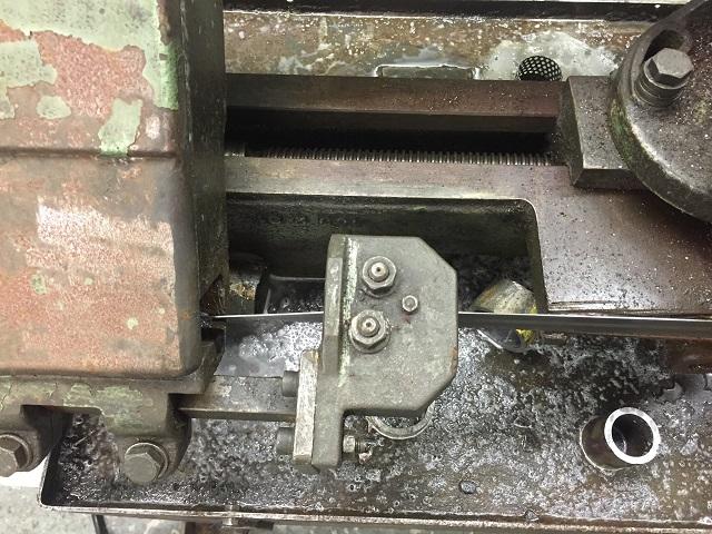

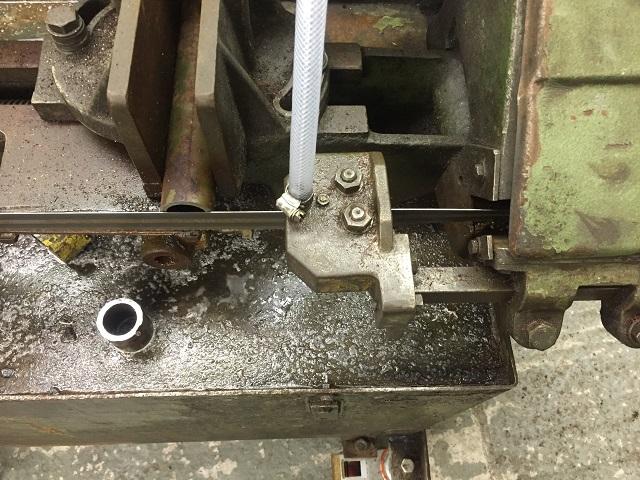

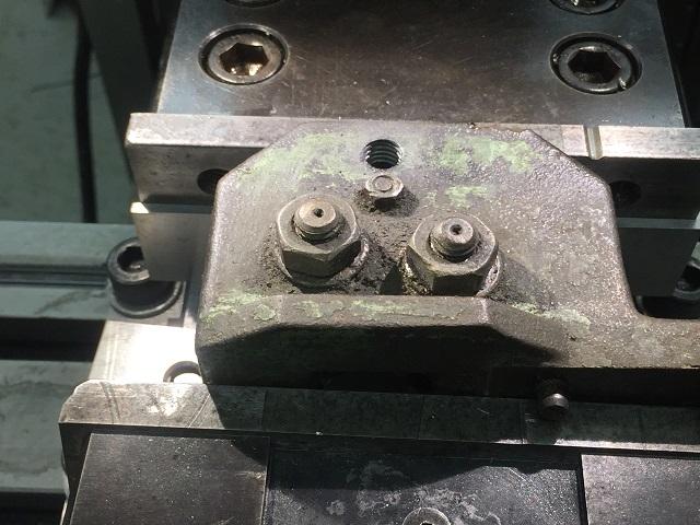

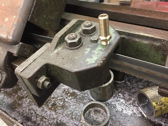

It would be relatively trivially simple to drill and tap an appropriate hole in the other (left hand) blade guide, and I may well do this if my enthusiasm doesn't die first. There is also a clue in the holes that the blade emerges from and returns to in the wheel covers, as the right hand side one has evidence where a blade wiper has been fitted, whereas there is no such sign on the left hand side.
Re: Meba Bandsaw Cutting Direction ?
« Reply #3 on: August 03, 2016, 09:55:43 AM »

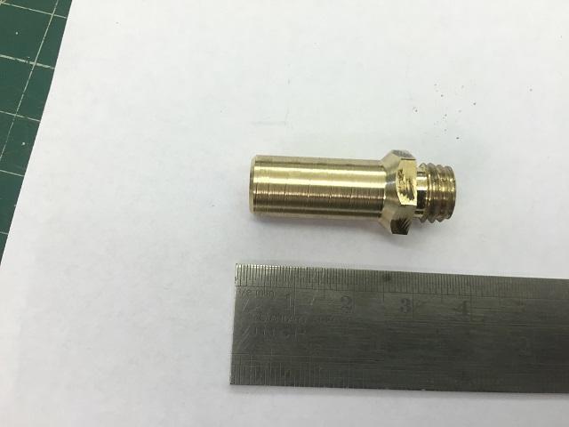

OK I've convinced myself to reverse the blade direction of travel and fit another coolant nozzle on the left hand blade guide.
To this end I've ordered up a 10 mm Tee piece for the coolant pipe, and made a new nozzle. I'll hold off fitting it until the Tee arrives. I supposed I'd better sort out the missing blade wiper - what do the team recommend - a bit of draught excluder brush or some neoprene sheet ?

Nooooooooooo,
Leave it, it's correct.
Spent a long while working with Starrett and later Lenox on big bandsaws. That big the blades had one tooth per inch.
They suddenly realised about 20 odd years ago that they had their ideas wrong.
Old way, sawing towards the fixed jaw, blade tilted down, if the blade grabbed it dug in and caused blade damage or failure.
New way, cutting away frome fixed jaw tilted up and a dig in throws it up and clear.
My bigsaw which is possibly a tad bigger than Andrew's ? at 12 1/2 " round gets double the life out of a Lennox blade. Get Lenox blades only from MSC J&L, anything else is a waste of money

Hi Andrew, I think John is right as my saw cuts away from the fixed jaw and came from Metal supermarket Gateshead , they cut lots of metal and had the saw maintained and repaired by professional company so I think they would have set it up correctly.
 All I can say is I have wondered about the direction before but I am sure the arrows on my wheels confirmed the direction was as intended on my saw. The other thing is it cuts great and straight, so I also just thought if it's not broke don't fix it lol.

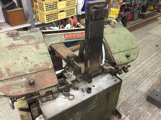

Well it seems to work  :clap:

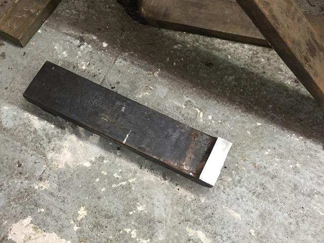

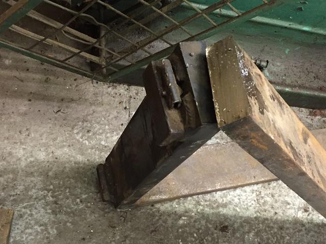

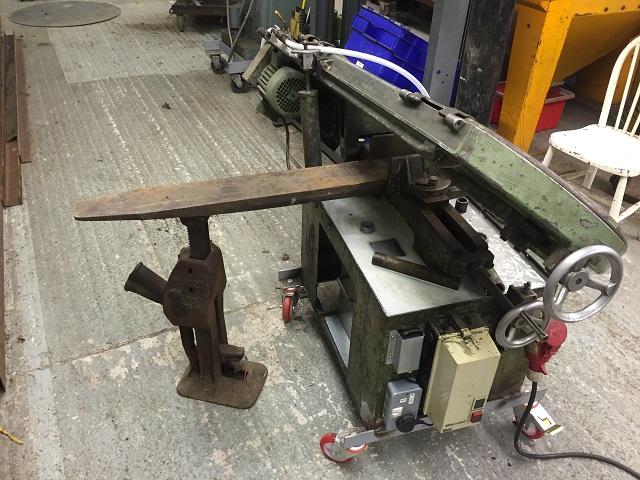

If you remember from my opening post this band saw was dragged back to life to cut up some Forklift Forks to donate material to make Vee Blocks for shaft straightening on my 60 ton press.
Impatience being my middle name I had at it this afternoon. The forks are 40 mm x 120 mm - I'd have preferred 50 x 120 but you work with what you have. The saw has two speeds selected by manually changing a Vee belt (dodgy Vee belt - spare on order !) and is running at 120 feet per minute at the moment with an 8 tpi M42 blade and oddles of coolant (must cure that drip!)
It took about ten minutes and gave a remarkably clean cut - no idea what the steel is but it will be something pretty tough to stand up to the abuse of being a forklift fork.
I'm certain now that the saw was originally designed to run the blade in the opposite direction - ie left to right - as otherwise it wouldn't need a swarf scraper on the 'entry' to the right hand wheel. But in the light of John S's comments, and Mick saying his one runs right to left that is the way I'll leave it.
The eagle eyed amongst you will have noticed I've fitted the extra nozzle to the left hand guide, but it's not plumbed in as I'm still awaiting the Tee junction.

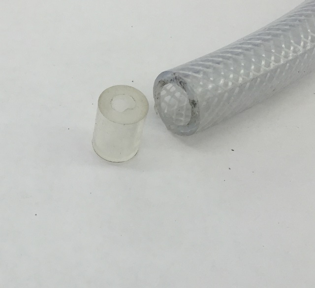

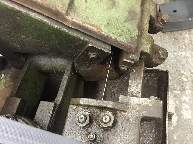

The 'Tee' piece for the coolant hoses arrived in the morning post, so it was fitted in short order. However the first (right hand) nozzle hogged all the flow, so it proved necessary to push a 'flow restrictor' down it to allow the left hand nozzle to receive coolant. This is just a bar of acrylic with a co-axial hole drilled down it. It took a few iterations to balance the flow between left and right by choosing different hole sizes.

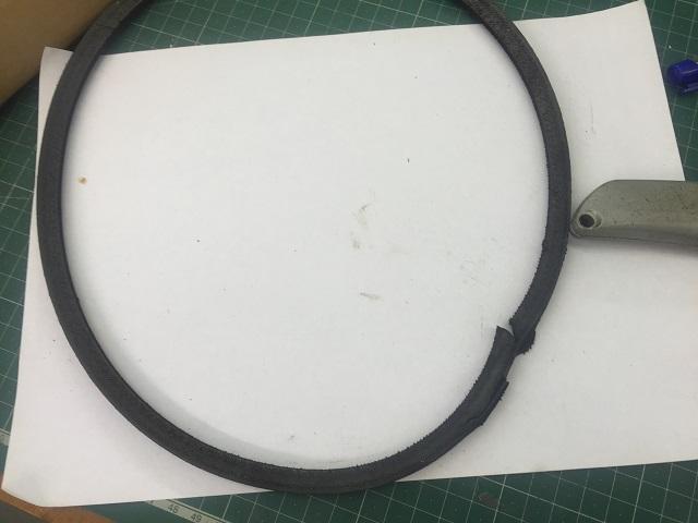

Fitted the replacement Vee belt - I reckon failure was pretty imminent !
