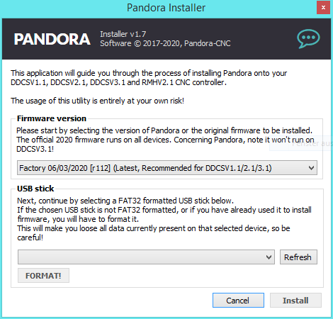

I've now also updated the Windows installer. It will now allow you to easily install the currently latest version of the factory firmware.
