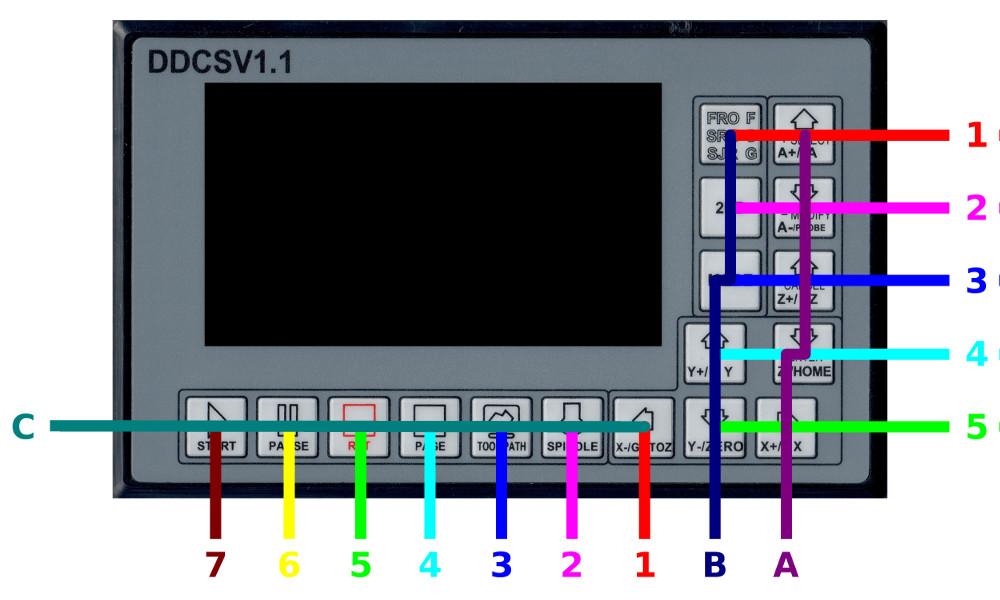

  • Posts: 7
« Reply #930 on: July 20, 2018, 02:07:56 PM »
maxx2000:
I am building a control now and would like to add some buttons to the front panel.  I can understand how you wire buttons to existing input terminals on the control, but you said that your panel buttons duplicate the buttons on the control display.  How do you wire these buttons?
Offline maxx2000
  • Posts: 27
  • Country: ru
« Reply #931 on: July 21, 2018, 01:31:33 AM »
lfriii
Sorry for my english, this is Google translator
Offline lfriii
  • Posts: 7
« Reply #932 on: July 21, 2018, 07:30:22 AM »
maxx2000:
I don't get it.  How does the picture explain how to wire control panel buttons?
  • Posts: 9048
« Reply #933 on: July 21, 2018, 07:49:43 AM »
Presumably they are selected on a normal encoding matrix, where  1,2,3,4,5,6,7,A,B are the columns and other 1,2,3,4,5 the rows
Offline lfriii
  • Posts: 7
« Reply #934 on: July 21, 2018, 08:36:52 AM »
Heiii, welcome back!!
they did indeed!!
Look
This is another company that use the same controller, and is changed
I see that the Omio control has a button labelled All Zero can anyone explain how this would be wired into the DDCSV to zero all of the axes?
Offline lfriii
  • Posts: 7
« Reply #935 on: July 21, 2018, 08:45:51 AM »
awemawson:
I am not familiar with a normal encoding matrix.  I am familiar with wiring buttons in panels.  I am tying to understand if it is possible to duplicate the membrane switch buttons on the DDCSV control with buttons on a larger panel as maxx2000 has suggested.  To do this, each of the buttons on the larger panel would have to connect to a contact on the DDCSV or a breakout board.  I do not see any such contacts.  Could you explain how maxx2000 made this work?
Thanks,
Offline russ57
  • Posts: 288
« Reply #936 on: July 21, 2018, 09:09:59 AM »
Imagine a grid of 3 vertical wires (a, b, c in the diagram) and 7 horizontal wires. (1-7)
There is a switch at each intersection which connects that row and column when pressed.
You would need to locate in the ddcsv those 10 connections and extend them to your own panel.
The switches are therefore in parallel.
(with this type of encoding you can only press one key at a time, otherwise the system will detect 'ghost' keypresses)
Russ

« Reply #937 on: July 21, 2018, 11:36:30 AM »
awemawson:
Solder the button wires in parallel with existing ones

@maxx2000
Thanks for the information. Very useful for a more user friendly keyboard.
Unit has 17 keys so likely 4 keys unmapped or unknown functions.
Set all zero button would be very useful. Can see no way of doing it from the rear panel connections. Maybe using TXD/RXD serial connections ? and injecting a code.
No real info about those pins, likely RS232, but baud rate, parity etc no info. According to manual - Used for digital display of the MPG communication.
May try to hook it up to a terminal and see what develops.
OK tried that and cannot get any output from Txd even on power up (no blinking leds on rs232 adapter). Wonder if it needs to be enabled in config ?

It would be pretty easy to build a Teensy based USB connected external button interface. I may figure something out when I get back home that does not require much soldering  :zap:
Maxx2000 kindly re-posted my drawing of the keypad matrix I traced out a while back. It's quite straight-forward, really. Each same number / letter is internally interconnected. When a button is pressed, one letter and one number will form a connection.
The little LED matrix driver on the front panel is only handling the matrix scanning (and has no LEDs connected). A, B and C refer to one direction of the matrix while 1,2,3,4,5,6,7 refer to another one.
One direction of the matrix sources the current flowing while the other one sinks it. It should be possible to extend the buttons to the outside by just putting the external button in parallel to the existing button and wiring it to the outside.
Internally, the LED/button matrix driver just connects via the flat-flex cable to a few spare general purpose I/O pins on the CPU on the mainboard.
It's a very simple connection with only a couple of wires (two or three wires - I can't recall the exact number right now, but I have it all written down somewhere).
