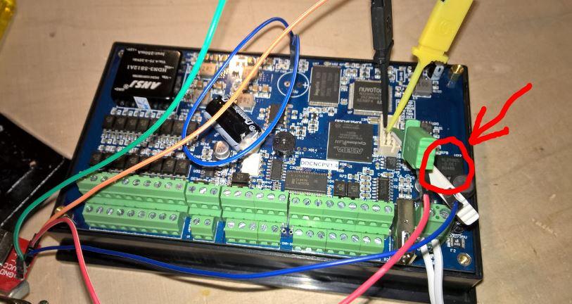

Hoping someone can help me out identifying this component. While making a new enclosure for my controller, I managed to fry it by attempting to share the same power supply with my G540.  :Doh:
It was a 48v power supply that I backed down to 32v (as low as it would go), but it must have gotten a spike and it literally blew this component. I've got it unsoldered from the board, and want to see if I can replace it. I can't read it clearly enough on the pics I've found. Any help with a better pic or actual part identification would be greatly appreciated! I'm guessing it's some sort of voltage regulator...

« Reply #912 on: April 30, 2018, 11:48:30 AM »
XL2596S-5.0E1
Sorry for my english, this is Google translator
  • Posts: 9048
« Reply #913 on: April 30, 2018, 12:14:00 PM »
Highly probable, as XL2596S-5.0E1 is a DC to DC converter so presumably was in the direct firing line from your higher voltage power supply.

« Reply #914 on: April 30, 2018, 09:43:05 PM »
Many thanks guys!!
