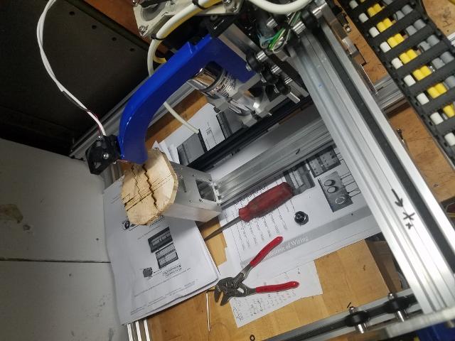

Offline WeldingRod
  • Posts: 401
« Reply #891 on: March 01, 2018, 10:36:13 AM »
JoDa, that MPG looks cool!  Mine is dumb, though.  It works well.
I thought y'all would like to see my Ox doing laser tube cutting under DDCSV1.1 control... since I seem to be the only nut using all four axies  :beer:
  • Country: ie
« Reply #892 on: March 01, 2018, 06:12:04 PM »
For a "4-axis nut" that's pretty damn good!
Will
