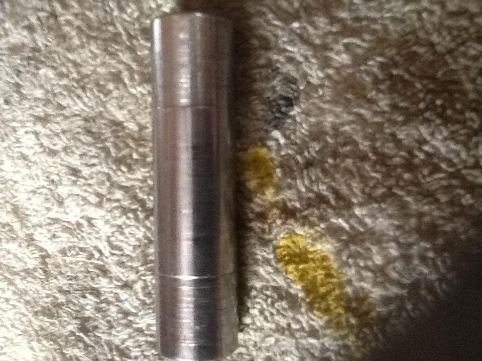

So some fotos.....
Here's the gudgeon pin.......the first image shows the worn sections where it rides in the piston bosses, the second image, the pin is rotated 180 degrees.....

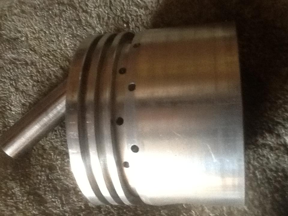

Here's the piston, the marks at the top above the first ring groove...
Re: Compressor quandry

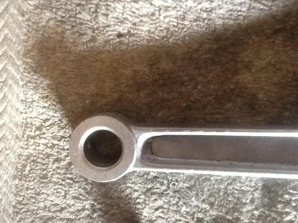

The conrod, it may not lok obvious but the l.e.e is worn oval
The second image shows the gap above the pin....

Yes, looks like low oil, the piston has definitely grabbed and nipped the ring. NEVER seen a gudgeon pin wear like that, run a file across it and see if it is not hardened properly! It is common for the soft to wear the hard, but with not enough oil and splash lube, what can you expect! I have an on-gong problem with my compressor, and my memory, The compressor develops a very worrying knock, so I check the oil, put some more in just in case, overfill it, end up with a pool on the floor, then remember that it is the motor pulley that comes loose, tighten it up, and it purrs like a kitten again. Done it three times now, think it's me age!!
