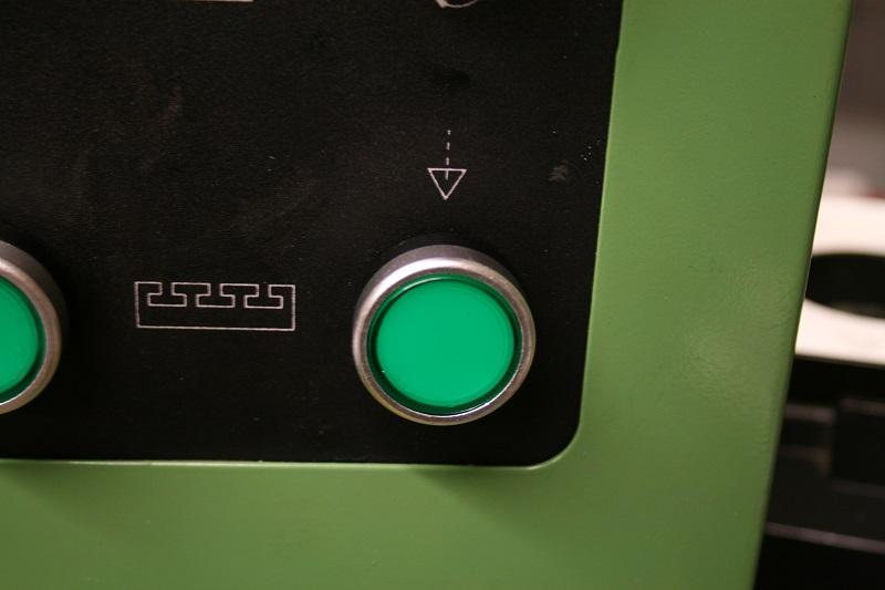

Pic 1 front view

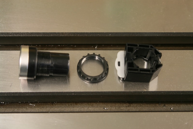

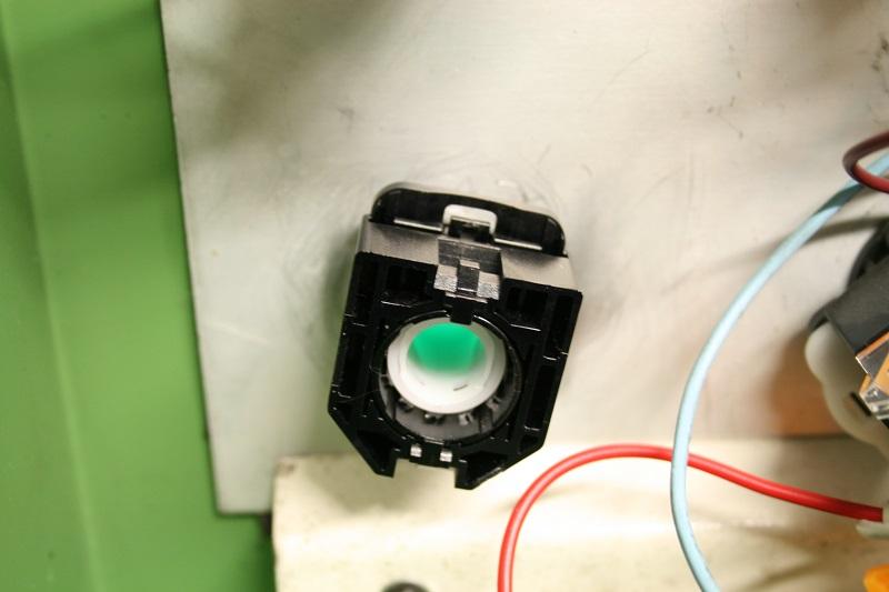

pic 2 back section removed (screwdriver lever in orange clips)

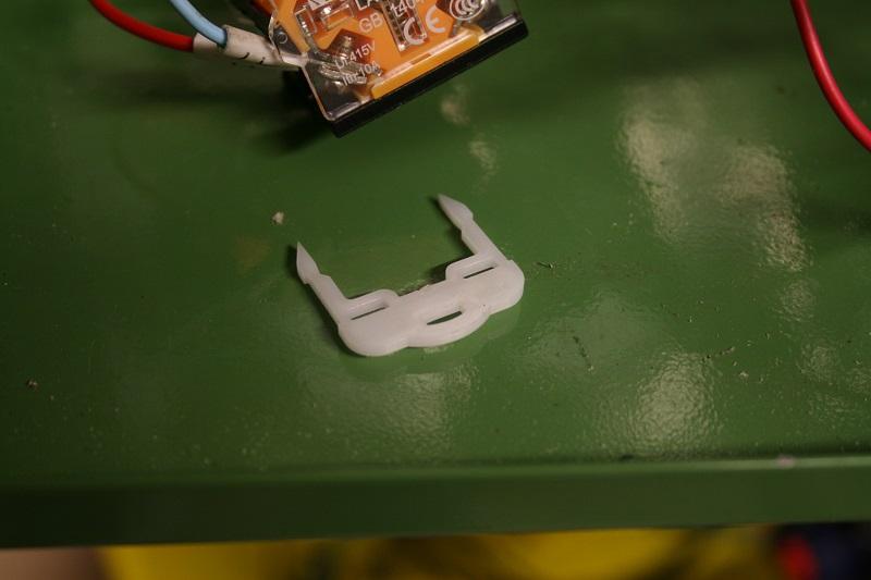

pic 3 white clip removed (which I thought was the secret)

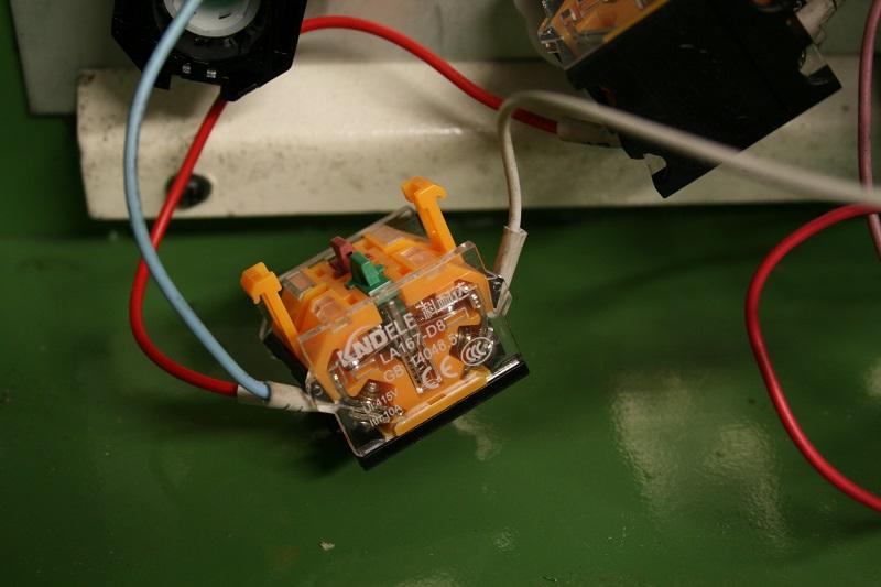

pic 4 story so far, the centre black circular section is part of the assembly from the front panel, but something is holding it inside the squarish section.

Hi Pete, I am not sure but photo from the rear of the panel with the contactor block removed, seems to show another tab type clip set up maybe ?, the type where a small terminal driver will fit in the small square hole and pry away from the center of the switch and remeove a 'circlip' type component that will be clicked into a grove in the switch body that is just flush with the rear inner surface of the panel. Failing that maybe the front screws off and the switch pushes back through the panel ?

The white part removed is the retainer  :scratch: On some makes you need to turn the block anti-clockwise to allow it to be removed from the actual button others just need a little brute force to get them to unsnap from the button  :thumbup: once the block is removed you can then unscrew the retaining ring for the button and hay presto  :clap:

I agree with Mick. The white retainer holds the switch block into the body, the black one the body to the button.

The white clip was put back into place, and pressed inwards this released the body from the cylinder and in a flash it was apart.
So the white clip was the secret...but not in the way I originally thought.  :hammer:
